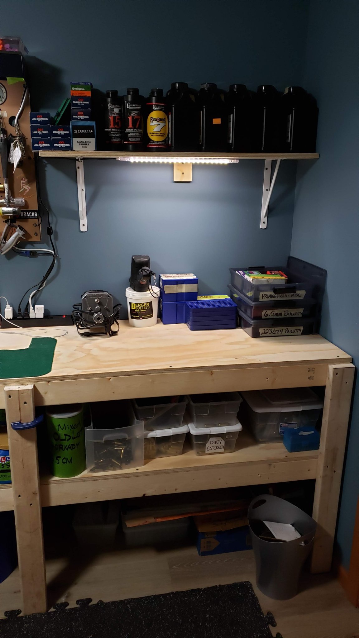

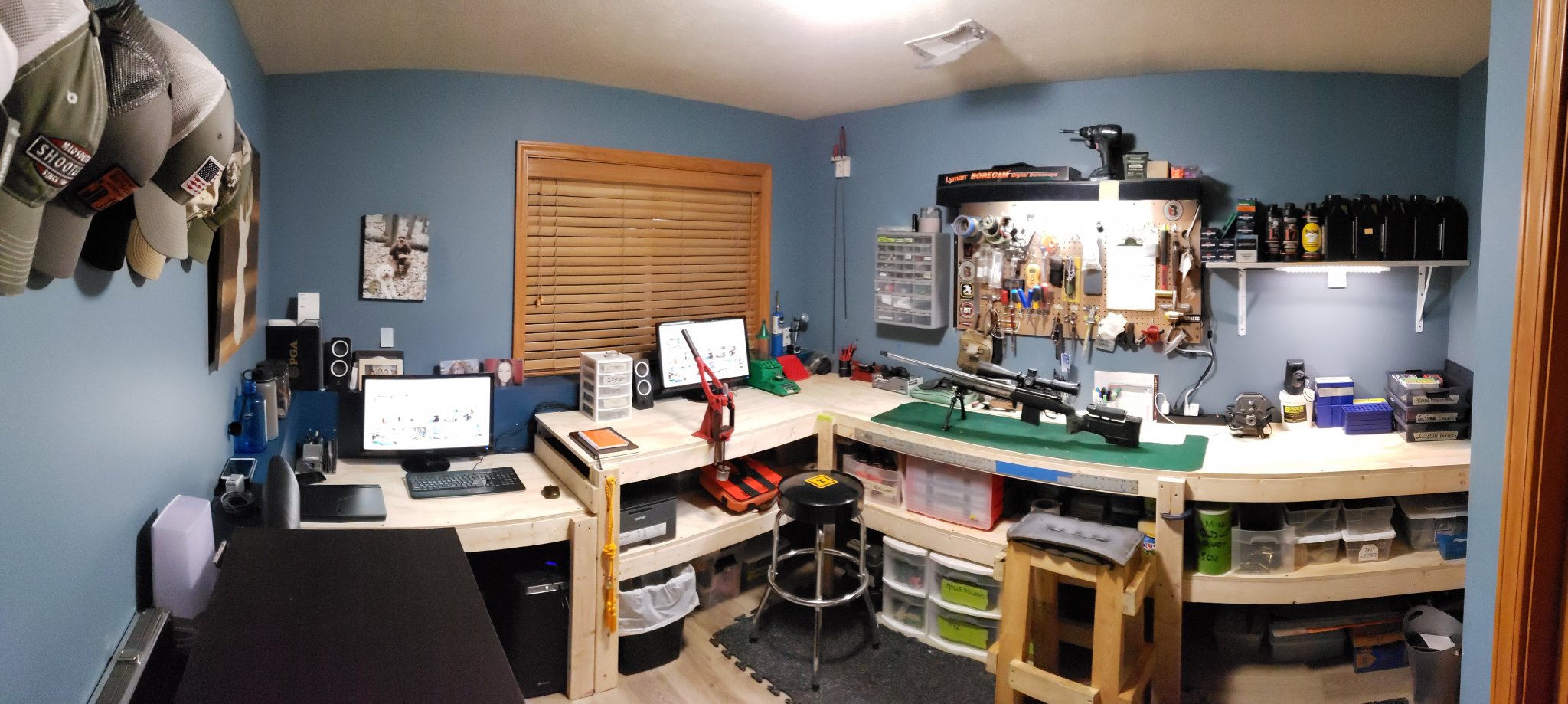

Decided that I didn't have enough space for my gear in my reloading room: I've always cramped for workspace and storage areas. Our basement flooded and we needed to put in new flooring, so it was a perfect time to remodel/rethink my reloading space!
Before remodel, I had a single 48" bench for reloading, 36" desk (for work work) and a 48" fly tying bench (which I removed) for a total of 11' of work space and only a few linear feet of storage. With the new bench, I created one continuous work bench on two full walls for a total of 20' of work bench linear, plus two levels of storage for a total of 60' of workbench and storage. Used 12' 2x4's and 3/4" Plywood (pre-sanded). I will put details on how to duplicate my method below for those interested.
I used the simple hanger+mirror method to build the bench in about 6 hours total work but that includes relocating and organizing gear. Here are a few highlights and photos. Features I designed into space when building:
  • Split location computer monitors for work and reloading data.
  • Separate areas for Reloading, Gunsmithing/cleaning, Brass Bullet Storage
  • Additional lights for detail work
  • Cleaning Rod Storage hanger
  • Hat Rack! Finally

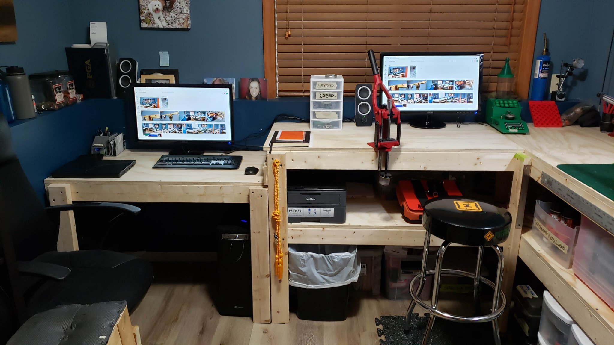

Workstation and reloading area on right; allows me to look up load data, netflix, log measurments, etc, while without moving back and forth between areas.

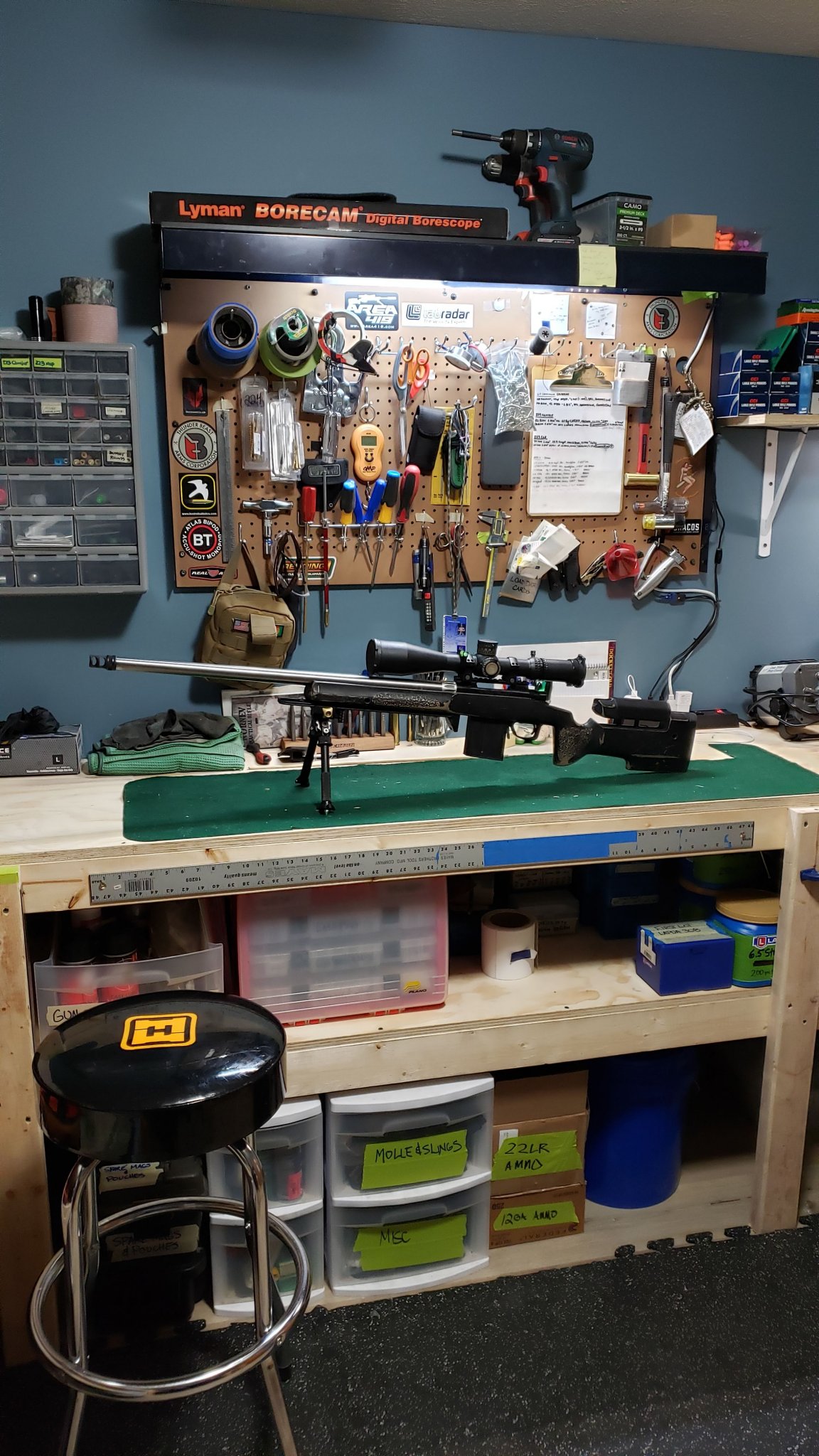

Gunsmithing/cleaning area: dedicated tool areas and ample length for cleaning long rifles.
Powder/Bullet/Brass Storage: extra lighting and plenty of storage. Will be adding a grid of 8"x 8" x 8" storage cubbys for specific calibers and bullets later.

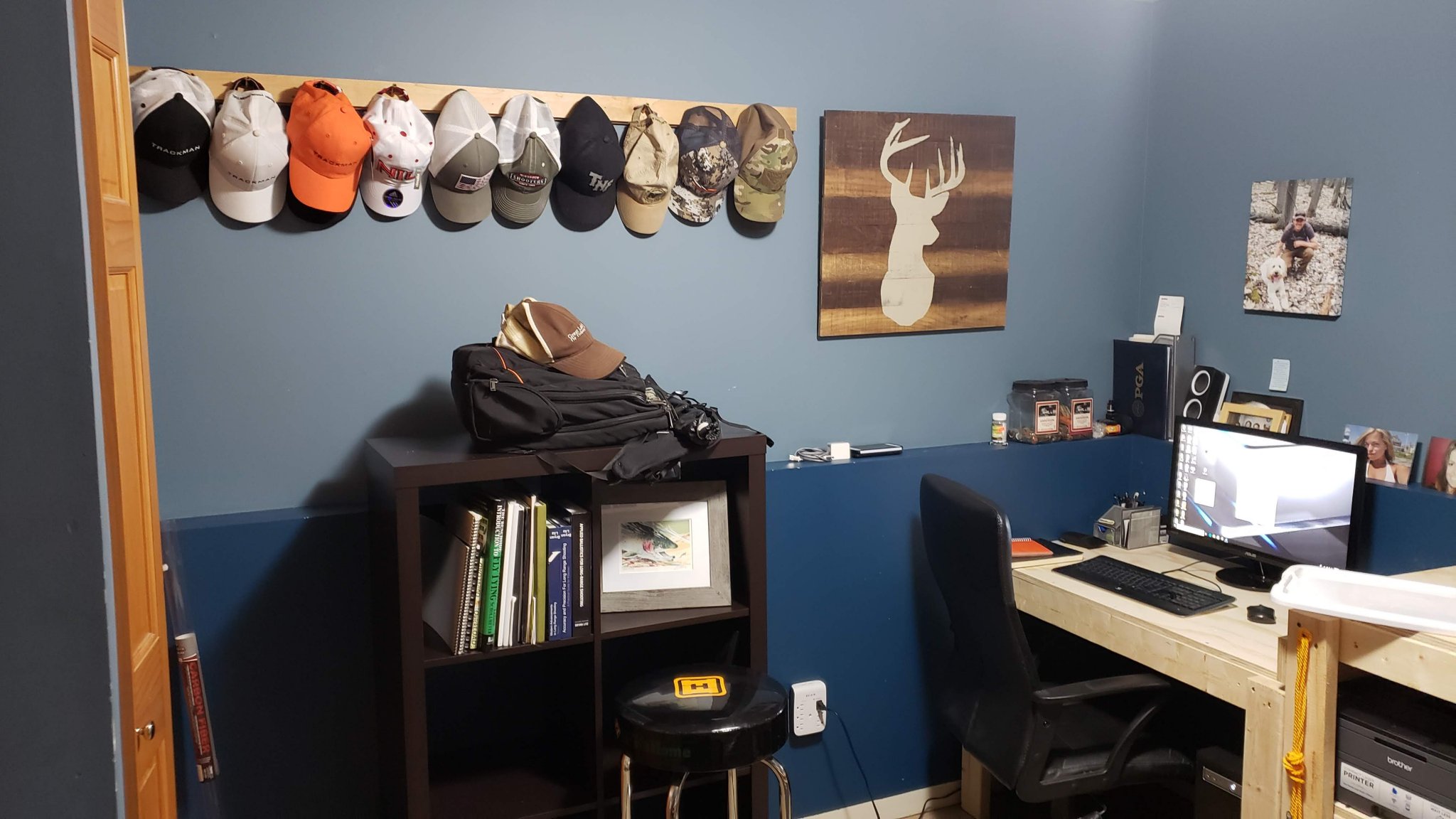

HAT RACK! Best idea I've had in a while:

Hat Rack:
  1. 2x4 or other random board, plus a bunch of extra brass (I used 223 Rem)
  2. Find drill bit that is *Slightly* larger than OD of your brass. Use test board to ensure snug fit if needed.
  3. Drill holes 1/2" deep at 6" spacing using a slight angle (I used about 25 deg off perpendicular)
  4. press and lightly tap brass into place with glue of your choice. Done~!
