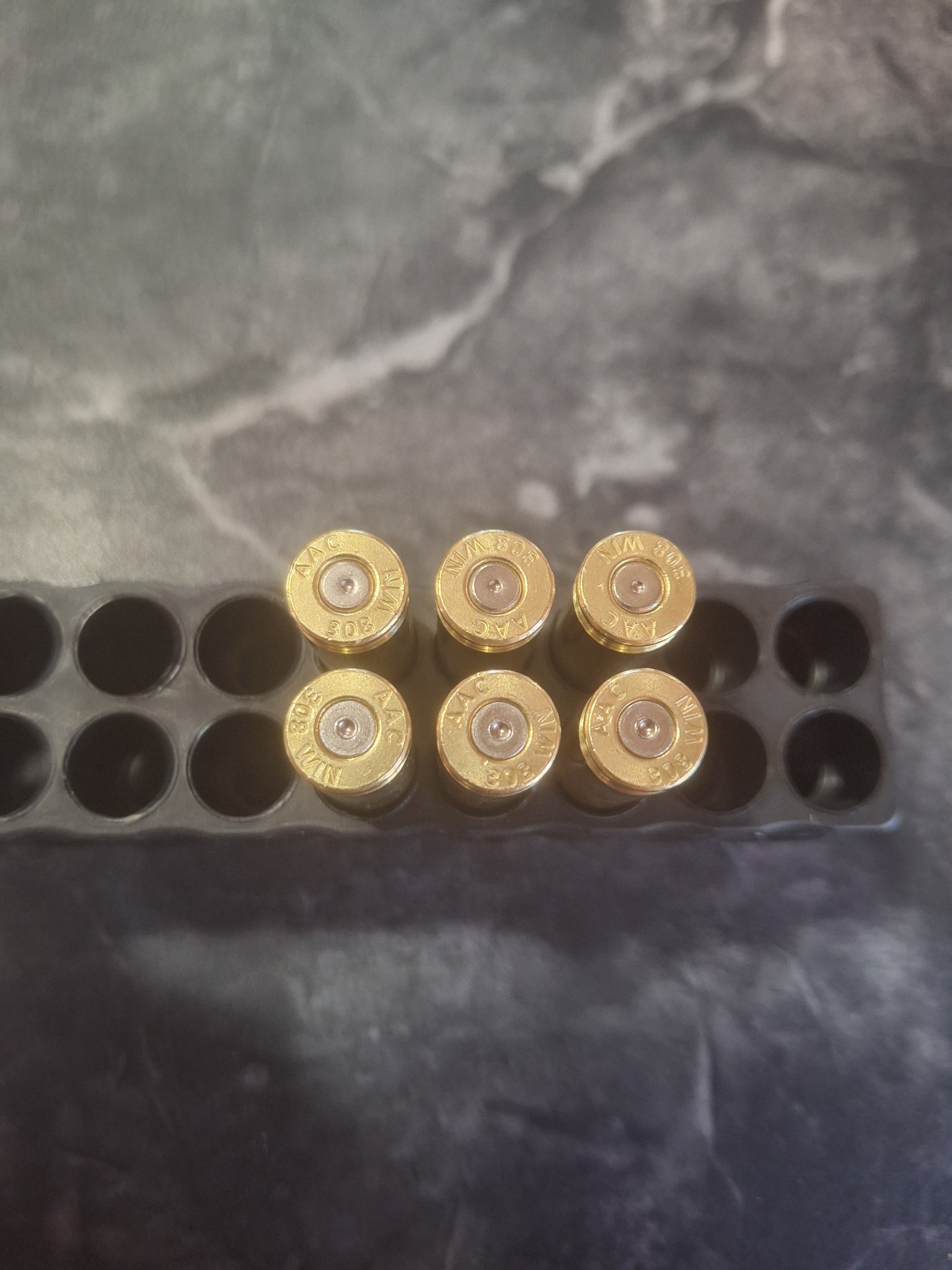

Fail to fire on top, fired rounds on bottom. Maybe some flattening and slight cratering?

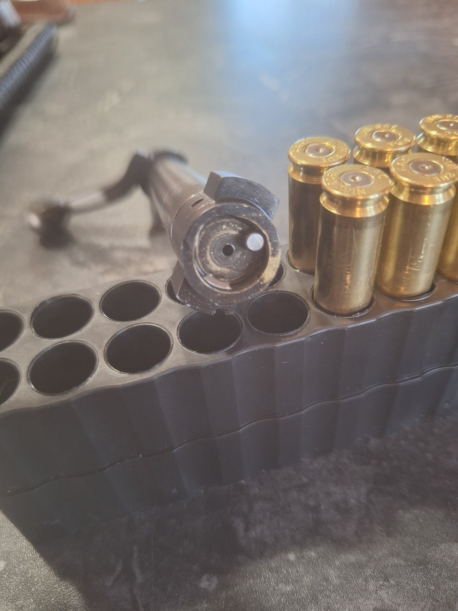

Bolt face has brass marks and what appears to be slight brass shavings?
I'm wondering if the brass shavings are simply getting into the firing pin and impeding it's travel, or if I have some other issue like bad firing pin dimesions or over pressure or headspace.

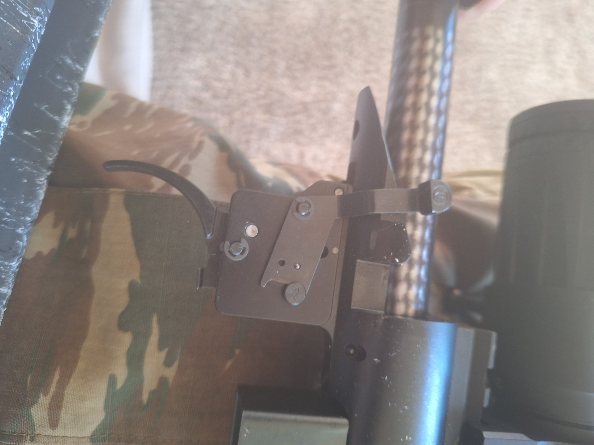

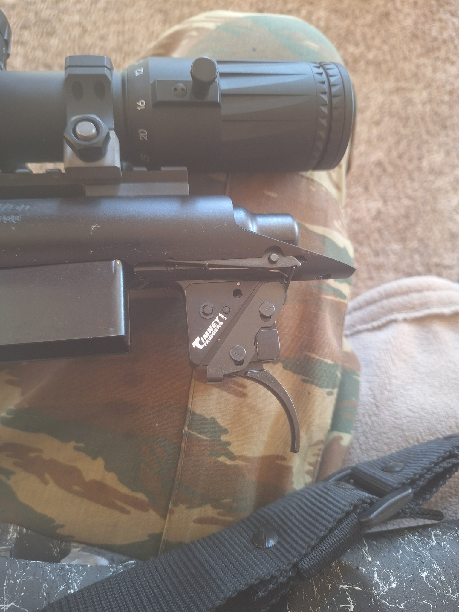

Factory trigger? I've saw overtravel set too short and caused sporadic firing pin drag. Fired primers look normal for a factory 700, they all exhibit that crater look. Check fp protrusion as mentioned.
