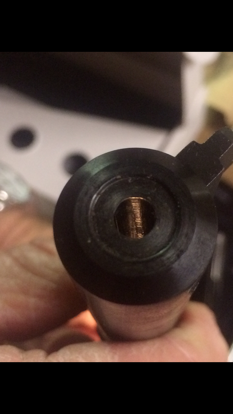

Is it this bad? (Pic was a brand new Ruger MKIV pistol from a couple years ago. They replaced it)

Yes I have fired 33 rounds and it shoots OK, nothing anyone here would be proud of, Smoothy8500 is correct In that these flaws are visible to the naked eye, no borescope. It is what it is, just wanted to know if repeated shooting would take care of it.
Shooting will clean a little bit up but not completely for what you're looking for. I would seriously consider having the barrel lapped. If you don't know somebody locally and don't want to send the gun out, you can always just pull the barrel and send it.
