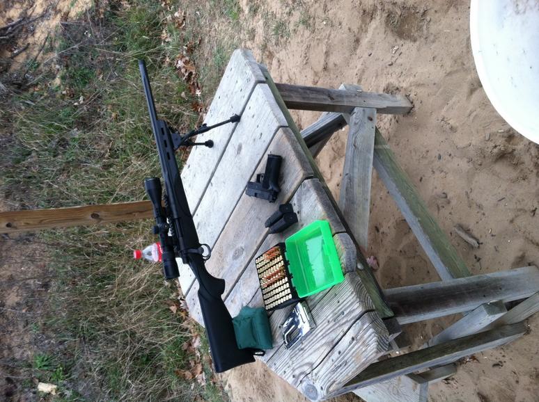

This rifle right now is just a starting point as I have several upgrades in mind. I put my Harris Ultra-Light 6"-9" bipod on it, bought a cheap Weaver base, and stole the Vortex Diamondback 4-12x off of my 10/22 and mounted it with some Warne rings I had laying around (after rediscovering how much of a PITA these rings are to mount, I quickly remembered why they were just laying around).

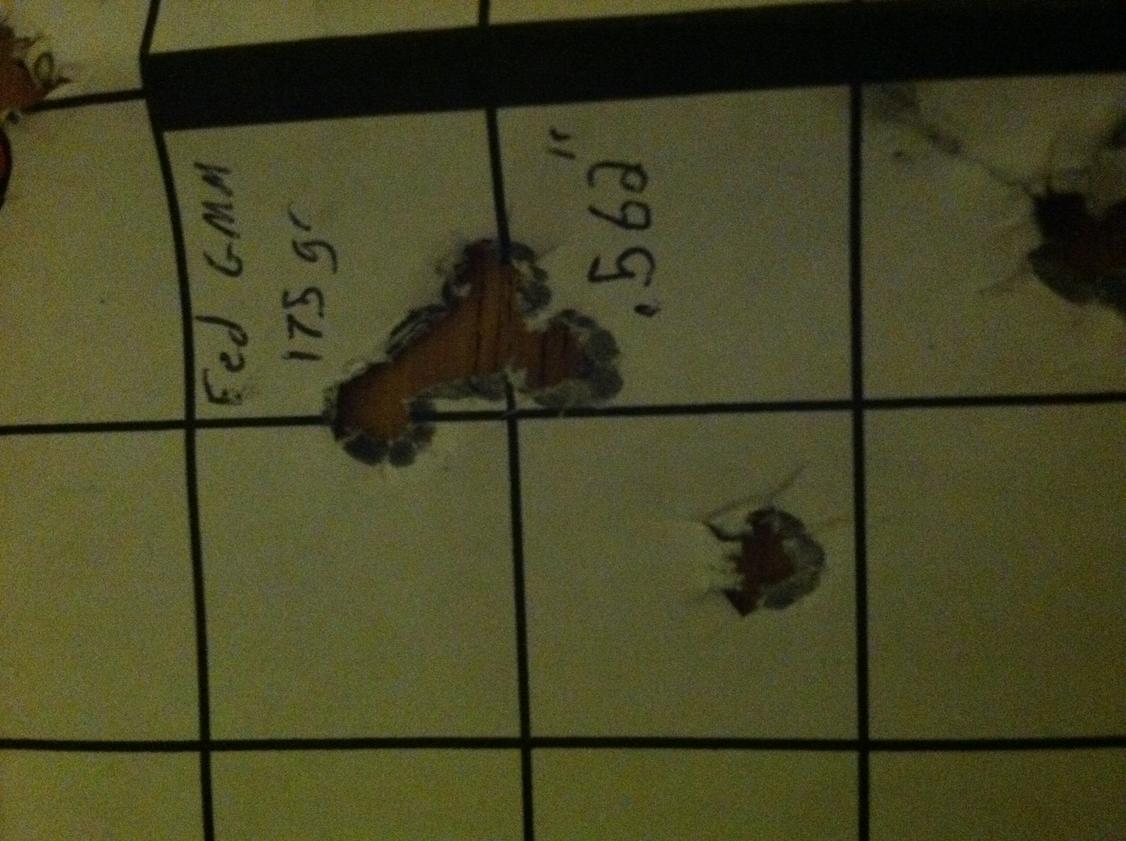

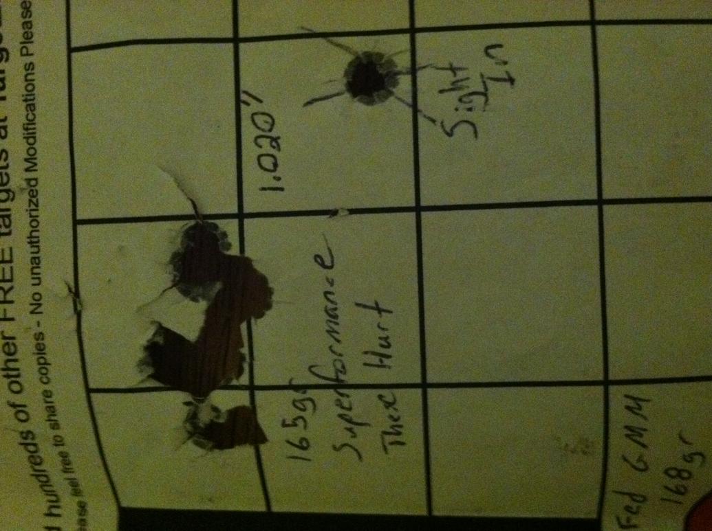

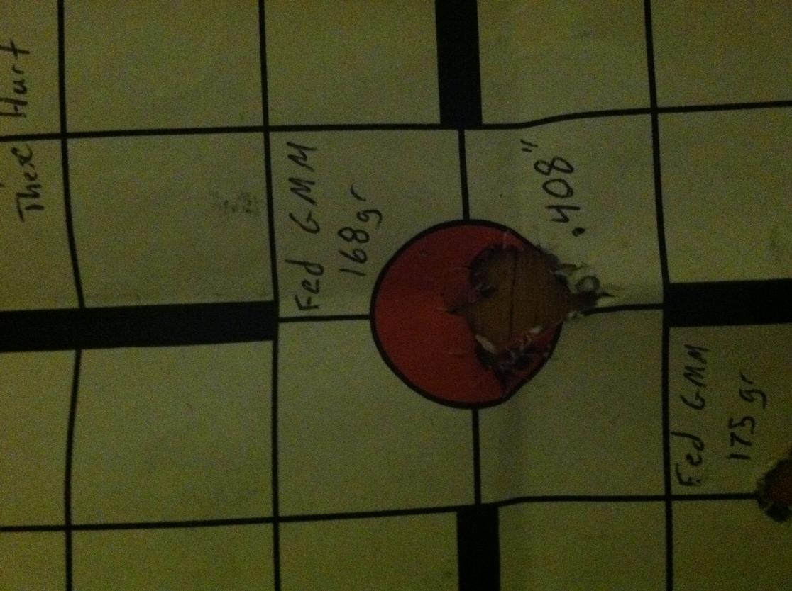

I managed to get to the range and sight in the new rifle and shoot a few groups. I shot two boxes of Hornady American Whitetail at 50yds to sight in and foul the barrel a little. After getting a feel for the rifle I set up targets at 100yds and shot some groups with the four types of ammo I had left. My best group was with Federal GMM 168gr SMK that measured .408" center to center. The Federal GMM 175gr SMK's shot almost as good at .562" (It's actually a 6 shot group in the pic as I pulled the second shot). Hornady 165gr SST Superformance shot just over 1" and that was with me flinching a little (these bastards hurt). Nosler Trophy Grade 165gr Accubonds shot a .818" group (these are my current hunting load).
Overall, I'm very pleased with this rifle. After hearing reports of Remington's lack of QC, I was a little nervous but thankfully I got a good one! The X-Mark wasn't as bad as I thought it was. It is a very predictable trigger but still a little heavy for my tastes. Now I need to get a bunch more ammo and head back to the range to see if this thing really is a shooter or was it all just sh!thouse luck? I noticed that with the Accubonds, it looks like vertical stringing which could be due to the cheap stock and the fact I was using a bipod vs a bag.
