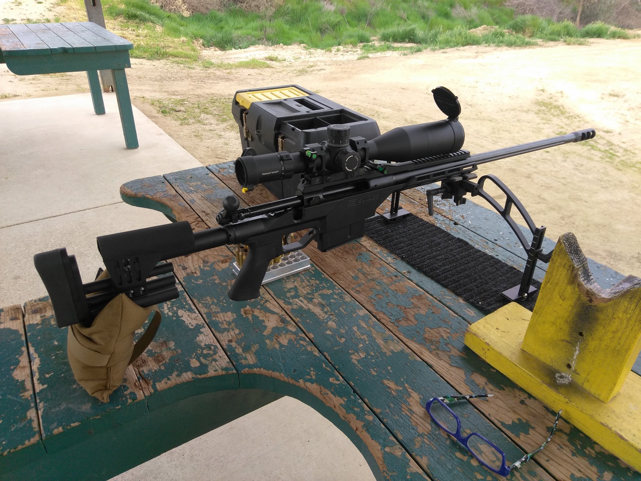

Ok, I might be, I hope I am premature posting this thread.
Have a new RPR 338 Lapua Mag. Was so totally enthralled with my RPR 6.5 Creedmore, I began salivating as soon as I saw Ruger had made this guy.
Am just getting going with it. Started off with some Lapua Match ammo, then a box of Prime Match when I ran out and borrowed one day. Just now getting my supplies in to do my own loads, the way I like it. But doubt my loads are going to beat Lapua's by much if at all.
Hitting between 1-2 MOA or worse.
A VERY experienced shooter next to me told me to get a single piece mount for my vortex.......he in fact found early on I had it mounted poorly, and he bore-sighted it for me, oh to be so versed! So I am thinking to buy a Sphur single mount, $400 plus, but it's tops, and I can use if for other rifles if it doesn't cure this one.
A pricier scope is going to have to wait a while on my budget.The scope I'm getting by with has done sub-moa on my 6.5 CM.
My biggest worry is I've gotten a 2 MOA rifle.
Like, I said, it's early yet, until I get that single mount and make some of my own loads..........
But any comments, hopes or voodoo spells you can offer will be greatly appreciated. This puppy set me back big time! Not like an Accuracy International or a Surgeon, but then I'm not in that class!!!
Couple things.
first, are you new to 338 lapua? It can be a bear at first.
second, take the gun apart, completely. Especially the barrel from the receiver. Put it back together. I bet it shoots better.

rugers are known to be way over torqued at the barrel nut from the factory. Disassemble. Clean. Relube and reassemble the proper way. My guess it will shoot better. What bullet you shooting?

May not want to hear it but I highly doubt it's the rifle. I guess you could have an extreme oddball but the 338 RPRs I've seen shot MOA or less at 1k. You should be seeing somewhat steady .5 moa out of the 6.5 CM at 100.
\I get that from my 6.5, or close enough to it, "tack-driving", and I love it. I want the same from the 338. Will experiment with diff bullet loads and weights and see if I can get it up to snuff. Thanks!

For many people, when they make the move from smaller rounds to magnums, small technique issues that didn't cause many noticeable problems are suddenly magnified.
Things to think about:
- Are you tensing up? People tend to try to muscle magnums into behaving. That has the opposite effect. Roll with the punches instead.
- Are you flinching? Load a dummy round (no or spent primer, and no powder), and have a friend load your mag for you, placing said round in a random position. You will see very quickly whether you have a flinch.

Have a known good shooter (preferably someone who has experience shooting magnums) shoot the rifle using factory match ammo at 300-500 yards to see how it performs. If you’re brand new to 338, it will take you some take to tame/manage the increased recoil so 2 MOA groups may just be a product of where you are on the learning curve. If the other shooter can’t get it to perform and potential issues with your scope and/or mount have been ruled out, I’d prob call Ruger and see what they say.

I have a 300wm version that didn't shoot well until I put a krieger barrel on it.
I think the factory barrels accuracy is hit or miss, no pun intended. Some work others dont. It's a cheap mass produced hammer forged barrel so that's the reality of it. I think the more modern cartridges with tighter specs are better for cheap, mass produced barrels. The .308 and .300wm seen to be more variable than 6mm, 6 5 etc.. Lesson if you buy a budget RPR get one chambered in a more modern cartridge.
I offered my factory barrel back to Ruger to inspect it and they never answered. It's of no use to me.

I've got the same rifle. I've got some decent groups with 285 ELD-M in the low 5s. The 300 A-Tip came out and I had to try them but got only a couple groups below MOA, and barely at that. Any rifle can be finicky about bullets, even in the same weight class.
I wouldn't consider anything other than a one piece mount for precision. I put a $100 Warne on it and lapped them. I can't see how an extra $300 will be better.
I did see a few things that point the finger of blame directly at the nut that holds the trigger. Asking someone who is known to be an excellent marksman behind a magnum to shoot a few groups should be done before blaming the rifle and sending it back.

Get a bipod....not a Harris one. that Lapua needs support. The bags just aren’t going to cut it. although I do believe that all RPR’s need to be torn down and rebuilt I’m leaning more toward technique and equipment in this case based on the limited information.

When I got my first (and still only) magnum rifle, it took me about 200 rounds to get settled with it. It is a .300 Winchester Magnum.
The .338 burns close to another 20 grains of powder, with heavier bullets. So I can imagine that it has some kick to it. This will make it harder.

Since I started this post a couple of weeks ago, I received lots of good suggestions to improve things......
(A quick refresh: I have a new 338 Lapua RPR and was afraid I had gotten a lemon, couldn't get any good MOA out of it.)
I was told to get a solid mount rather than the somewhat funky mounts I had, bought a fairly nice Leupold single mount and torqued it on. Sure enough, while installing the new mount, saw evidence on the scope that it had been "traveling" in the old mounts.
I was told to get bipods, bought a pair that attach individually to either side of the handguard and bolted them on. Fell in love with them today, they worked great and now I don't have to lug my bullsbag and heavy rubber risers anymore. (Will be doing this same thing for my 6.5 Creedmoor, now).
I told myself to get some of my own reloads featuring ballistic tips instead of tiny hollow points, I loaded them up. And I used 285 gr ELD Match instead of 250 gr, as some of you recommended. Hornadys.
A good cleaning was suggested, so I did that. And while underway (reading the manual) it occurred to me to lighten the trigger pull since I saw instructions for same in the manual. Did that too.
So today went out to test the improvements, and EUREKA ! Shot a 1/2 MOA at 200 and a 1/3 MOA at 500!!!! OK, that tells you there were some less respectable groups, but they were better that my previous best with this rifle. Happy, happy, happy. Too much money had it been a dud gun.
Still gotta work on my technique, I'm an old coot and it's hard to remember everything at once, and I don't get to shoot often enough for muscle memory and all to set in. But I'll keep trying. Technique, and my dream scope, and I'll be good to go. Meanwhile my present Vortex is making me happy indeed!
Thanks big time to all of you guys that sent me suggestions!!!!
338 LM can be a bitch...was for me. Thought my 2nd AI (A 338LM AXMC) was a freaking lemon. Now I shoot it better than other lesser calibers....
Double up on the ear protection....very important. The blast, especially through a brake, is pretty significant.
REALLY focus on fundamentals....press, break and freeze is very important as the recoil impulse is stronger and lasts longer (I think).
