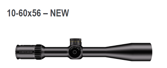

    Other then F-Class and maybe ELR why does one need that high of magnification? On my 7-35 ATACR, I run it most of the time at 15-20x, sometimes at 25x as the higher powers are too tight of a eyebox to be really useful.

    I run my NF 7-35 to about 25X for most applications for the reasons you mention but no idea what the eye box will look like on this one. You may be right though.
    The Schmidt 5-45 eye box is pretty nice even at 40X but hate the barnacle

    Yeah...why anyone wouldn't TT or ZCO it up at that point with that bullshit pricing is beyond me.
    I'd be shocked if that 10-60 didn't msrp with a "9" out front...if not the full 5-figure treatment.

    This seems like not much of an improvement over the 12-50, I mean on that one at 50x all you really have is the center + of the crosshair so I don't expect 60x to be any better.

    6-36 - I already have a 7-35 NF...nothing special
    5-45 - Barnacle which sucks and limited reticle and turret choices last I looked
    12-50 - Non illuminated reticle and a shitty reticle to boot

    I don't think so...maybe $6-7K. The erector design is lifted from the 6-36

    On the 12-50, a fancy reticle is kind of pointless if you actually intend to use it at 40-50x
    The P4FL works very well for target shooting which is what that scope was intended to be used for.
    The glass quality on it is very nice.
    When you are pushing out to 1k and beyond in target shooting, having 0.025 mil adjustments can be pretty useful.
    I'm not sure the weight and size of the proposed 10-60 is going to suit the gamer types that want fancy reticles.
    Even at 45x the FOV is small enough that you really have to be static target shooting to be able to use it easily.
    It would seem the 7-35 or 8-40 is kind of about the upper limits of useability for FFP scopes with fancy reticles.

    Valid points but consider...
    Not many people use their scope at either extreme. The difference between a 35-45 power scope is not all that great. I have tried the 5-45 and I really don't think it it is as good at its upper range. Same can be said about my NF. What I would be interested to see is if this scope is really useable at 45X in terms of clarity. 60X with a 56mm objective may be a bit much and the resulting image may be a bit dark and resolution/clarity may drop.
    The P4L is not that great IMHO. Lots of people like it because it is "uncluttered". Personally, I have no use for it. I am not a fan of HORUS type stuff but there is a happy medium. This new reticle looks like it may fit the bill but until you see it, you can never tell
    FOV when shooting F-Class is not an issue. I don't think this will be adopted by the PRS community for the reasons you mentioned. Its size and weight isn't much different from the ZCO 8-40.

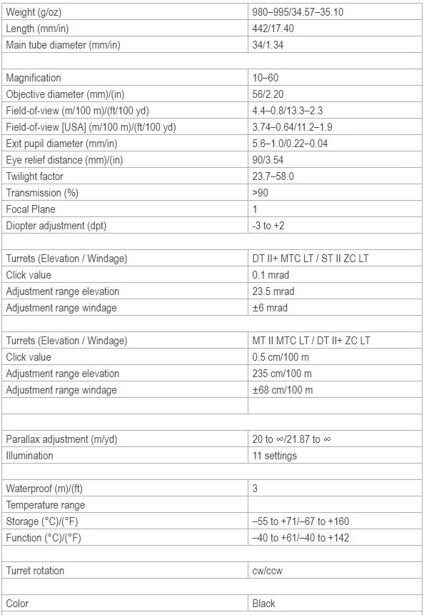

    I am thinking about getting one for 50BMG 1000 yard matches, waiting to see what people think of the parallax adjustments. On one of the fliers they say it is available with other reticles,....whatever that means...I doubt that matter to me.
    I like that it is MIL and .05 turrets :) If there are no reported parralax issues then I am in.

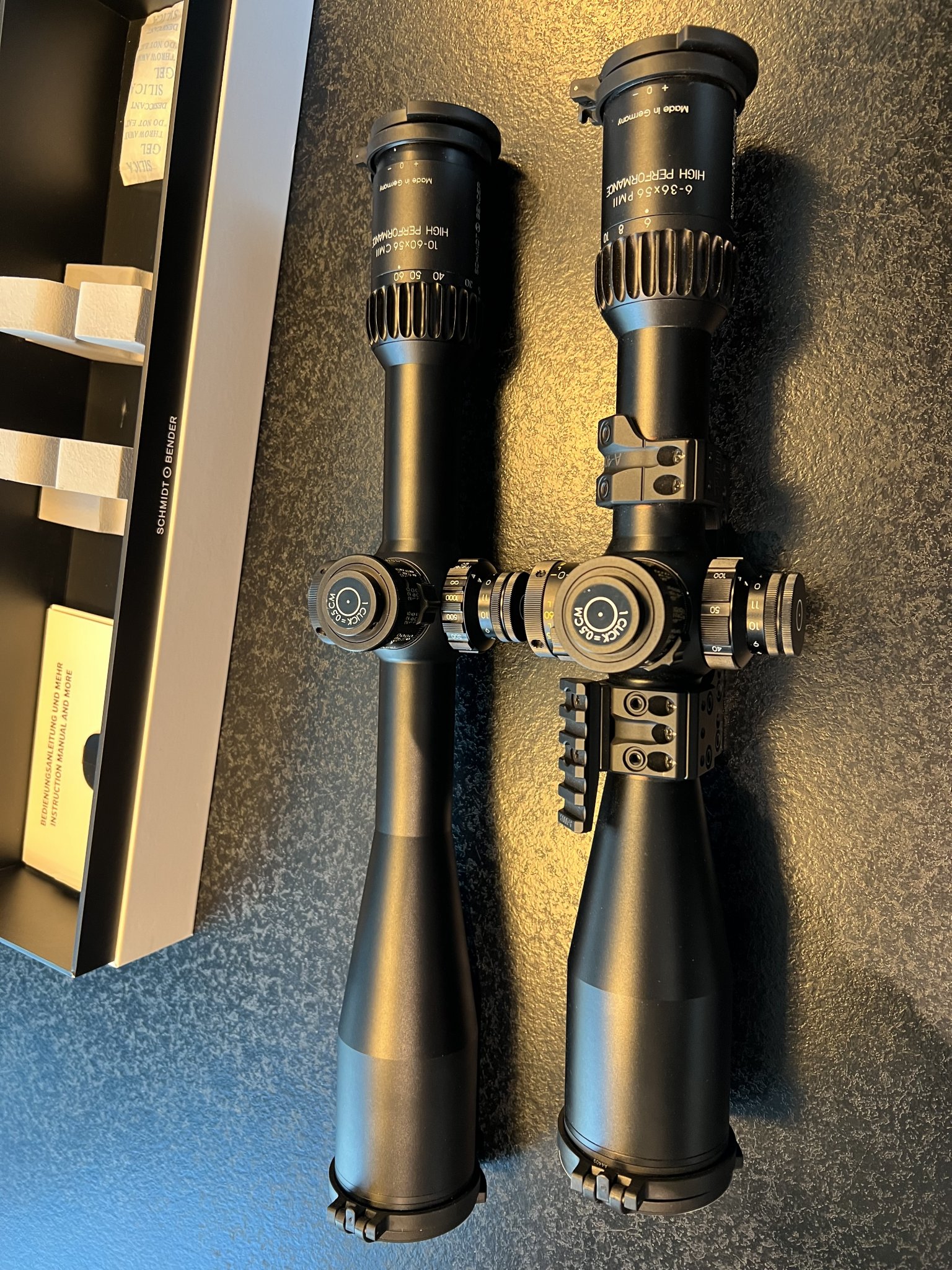

    How is the glass compared to the 6-36?
    VERY interested in the 10-60!!

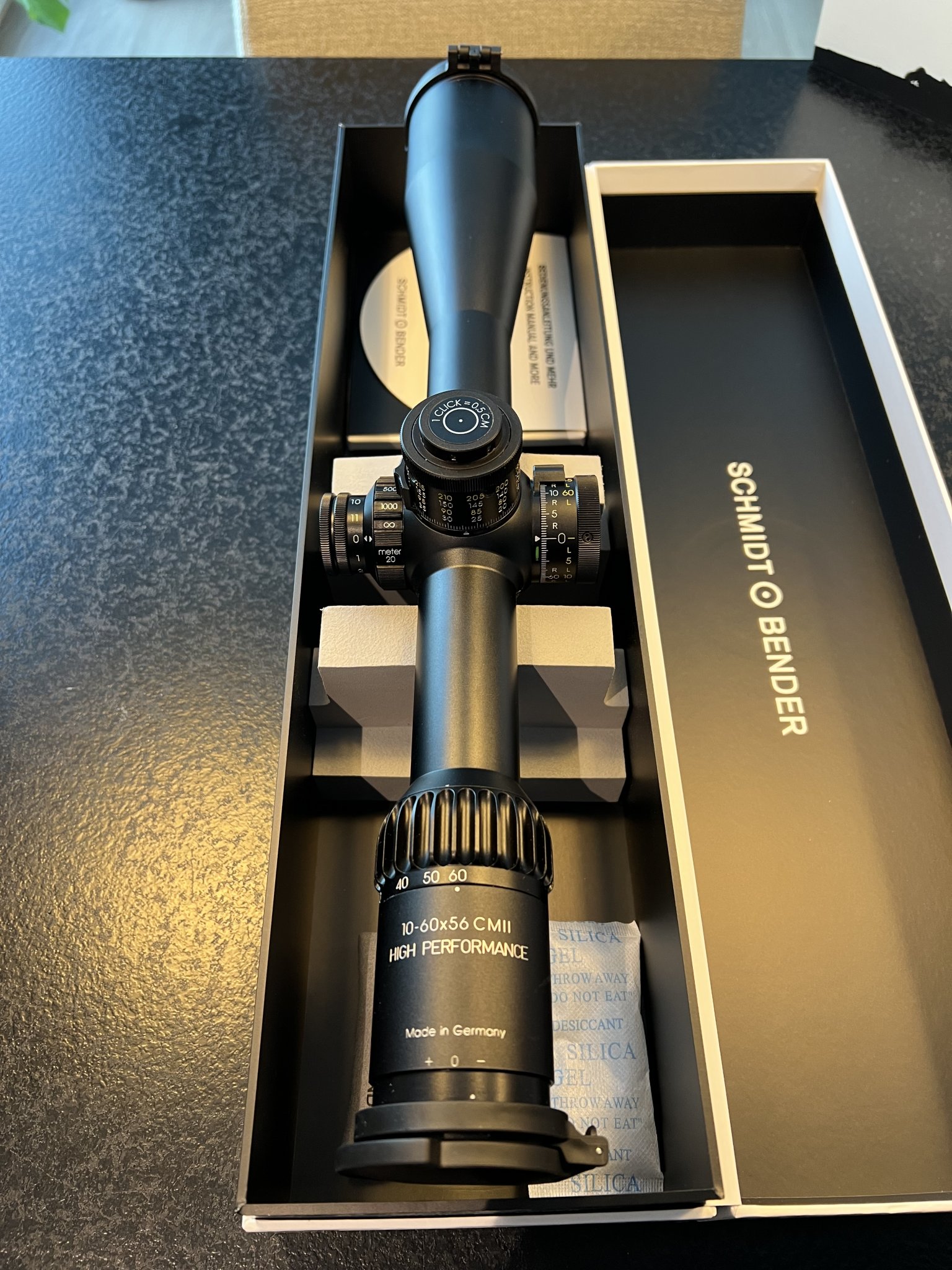

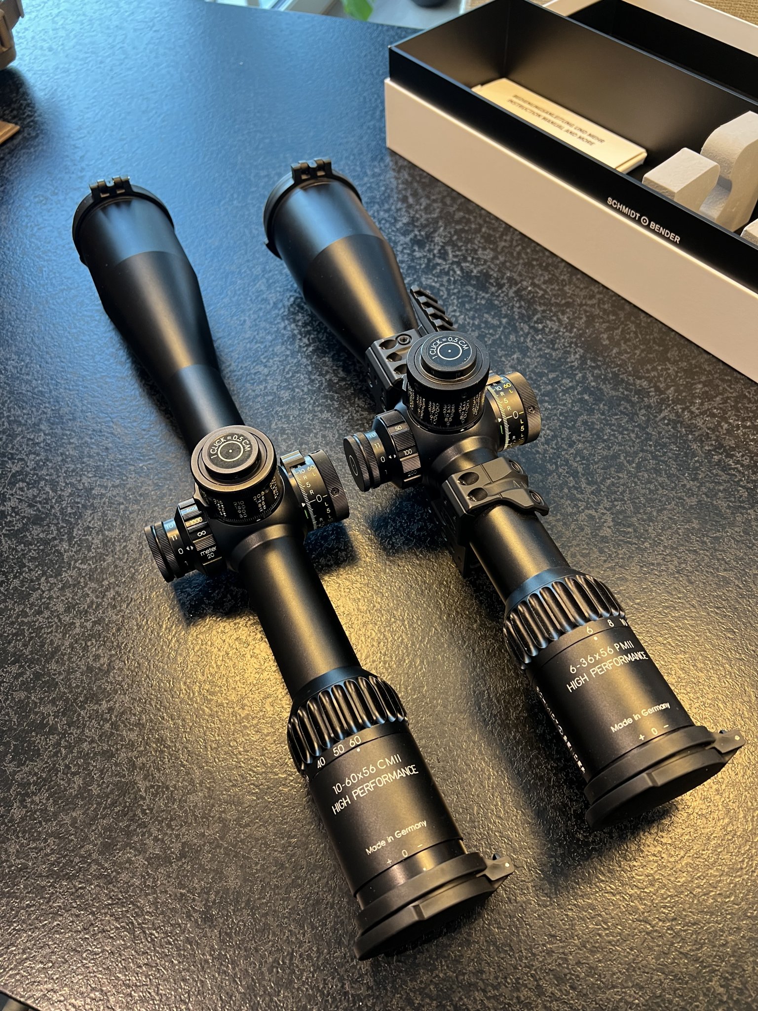

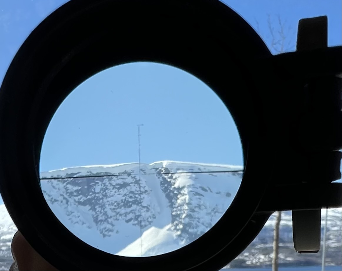

    Have not yet had a chance to get it out and compare the two, but first impressions are good.

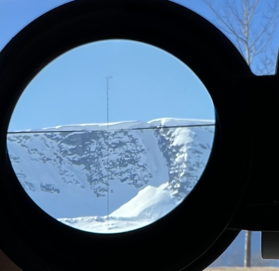

    I do notice quite a bit of «half mooning»(vignetting?!) in the FOV when at the outer adjustment area of elevation, but I guess that is the price to pay for such high magnification(?). Took a couple of bad iphone pictures to try to capture it, one picture is with turrett at 0 and the other at max 23,5.

    You had a chance yet to compare directly to the 6-36 ?
    Both yes and no. Taking it to the range tomorrow, will try to write up some thoughts afterwards.
    But if you like the 6-36 and the specs of the 10-60 suits your needs, then I do not think it will be a step in the wrong direction.

    For what it is worth, my thoughts after spending some time with the 6-36 and 10-60 side by side on a tripod:
    • First impression is that the optical clarity/image quality reminds me alot of the 6-36, to me they are very similar.
    • Eyebox is more forgiving on the 6-36, but the 10-60 is not bad.
    • Parallax is easy to adjust, no issues getting a crisp and clear parallax free image at distance.
    • As to be expected, conditions play a huge role in how useful the top end of the magnification range is on the 10-60.
    • FOV is very similar between the 6-36 and the 10-60, at 20x the 10-60 showed right around 11mils in the reticle and the 6-36 closer to 12(will double check numbers).
    • Elevation travel is not really comparable between the two, 23,5 mil vs 39mil.
    • The parallax adjustment is noticeably softer/easier to turn on the new 10-60 than on my other 2 LPI scopes that has a (too) stiff parallax wheel.
    Other than this, it is a S&B, and I like S&B.
    This is just my initial thoughts, kind of hesitant to make any recommendations based on my limited time with the scope. You are no doubt more experienced in the world of optics than me, hence might have a more analytic approach to judging performance. If you end up getting a 10-60 im curious what you think of it.
