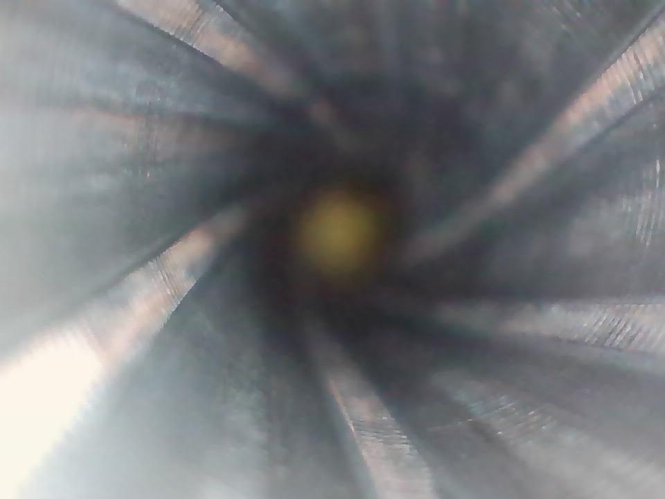

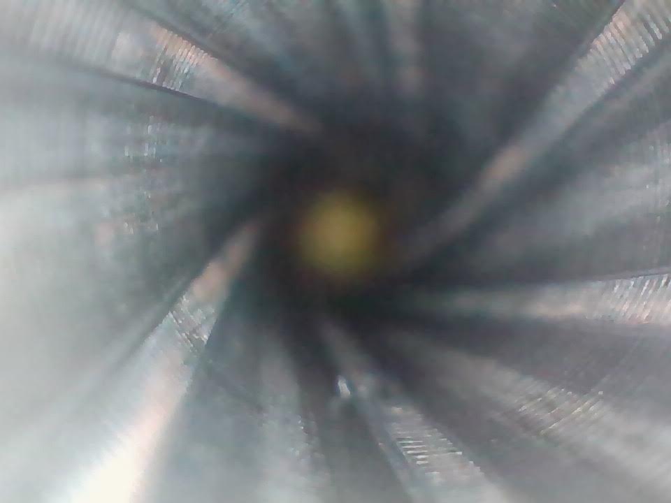

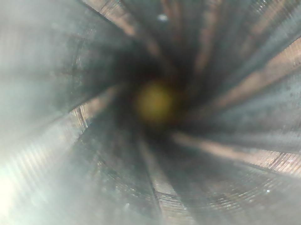

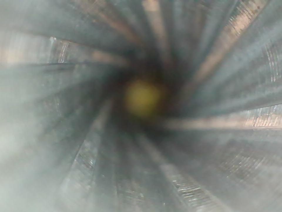

An update for anyone still interested:
Got a badger ordinance base. I bedded the base to the action, torqued it to spec. Torqued rings to scope to spec, and rings to base to spec. Took off the bipod and shot from sand bags in a very stable position. I had groups ranging from 1” to 6.5”, with no consistency. It didn’t matter If the barrel was hot or cold. I even removed the scope and put on my Leupold MK6 from my AR, and that didn’t change anything. I just took it to a local smith, and he’s going to scope the bore. If that reveals nothing, I’ll send it back to savage.
Just got the bore scoped, it’s definitely the barrel. My gun smith said it had these rings the full length of the barrel, and these pics were taken about 2” apart. It’s comical, really.
I called them and they sent me a shipping label. if they take care of me and fix it, I can’t expect much more. We’ll see.
Sorry to hear about your experience.
I guess there's going to be some QC issues with any manufacturer that sell's over six hundred thousand bolt action rifles a year, but there should've been a little better QC attention with a precision branded rifle.
I hope to see/read some good news from you after it's return.
