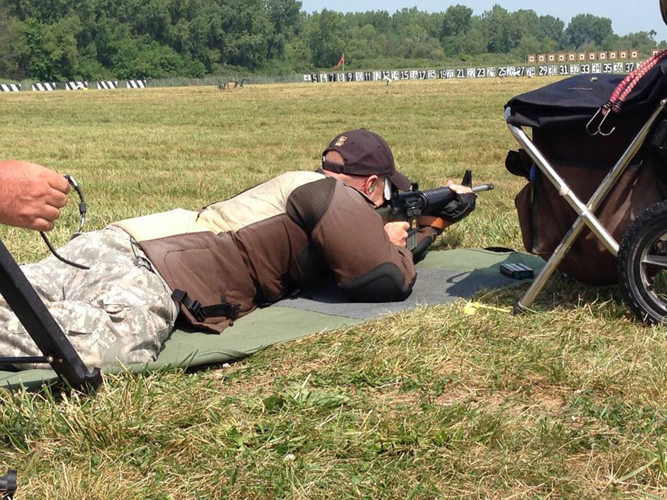

You don't necessarily need to blade out to one side to shoot a sling-supported prone.
While the shoulders are not squared to the rifle (due to the need to support the forearm with the offside hand) the spine is aligned with the direction of recoil
Photo courtesy of the US Army Marksmanship Unit
