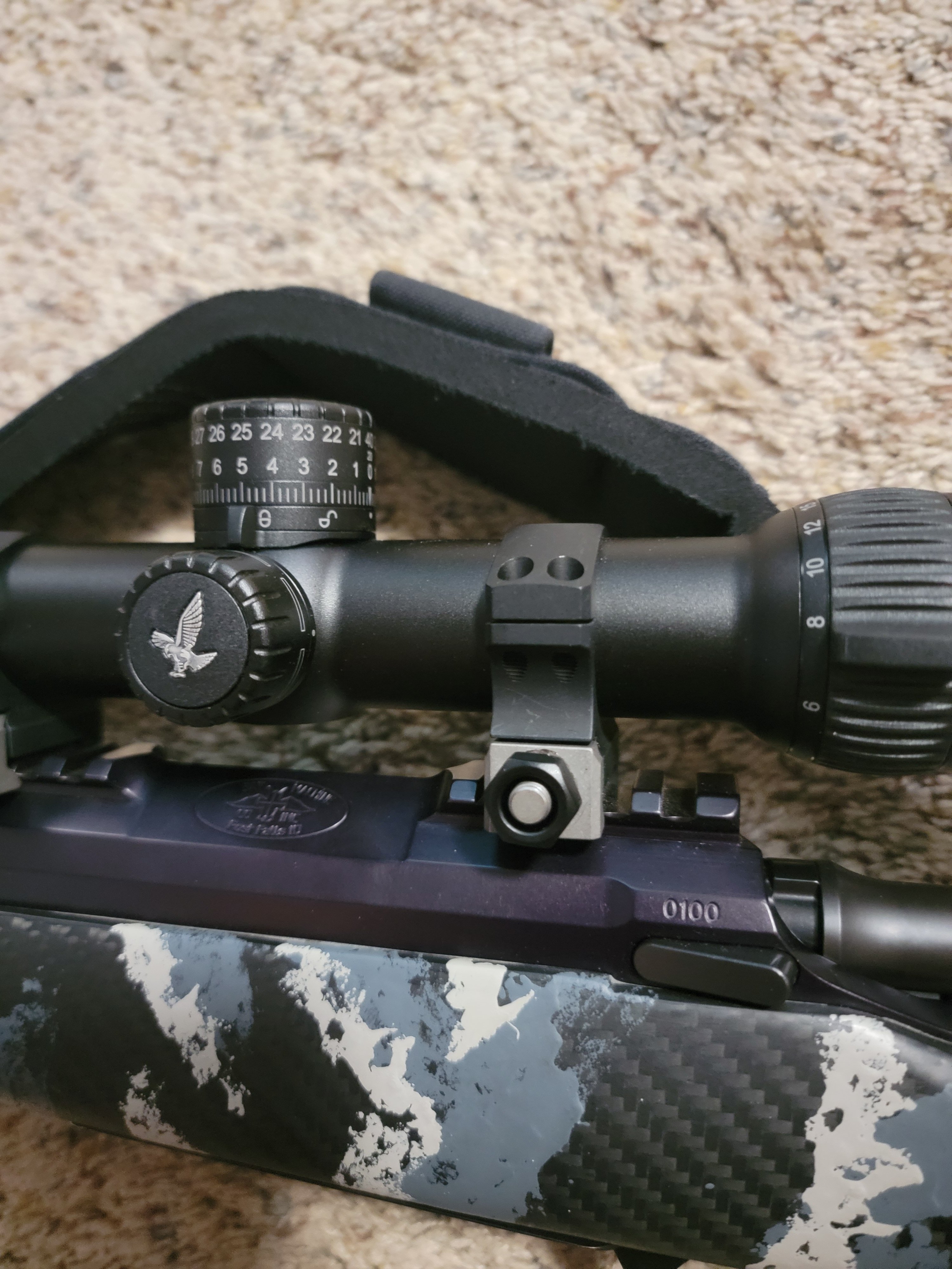

Weight matters, as i also carry carry 15's and a tripod. My experience says it's imperative to see them before they see you.
The aforementioned Swaro Z5+ 3x18 is my current hunting glass and the 2x10 is the next optic I will buy. They are pretty basic, but they are so good at what they do I immediately put it at the top of the list. The Leupold VX5 HTMR is a solid second and I own a few as well. This scope has a cult like following in a certain hunting crowd for a reason.

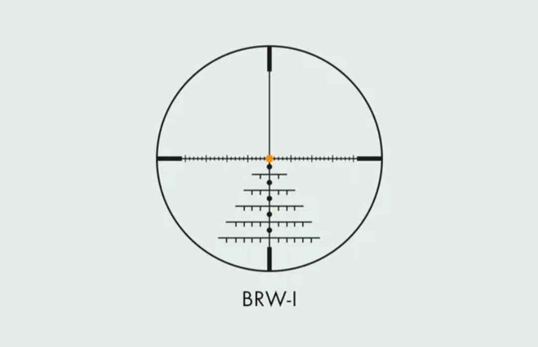

just looked at the swaro. what i don't like is apparently it doesn't have moa (or even mil) drops, just bdc or none at all. i like to hold over vs dialing and the bdc's never seem to line up.
Ugh, you sure you looked at the new + model?
I've run it to 1400 using moa in the kestrel. New turret is the shit!
