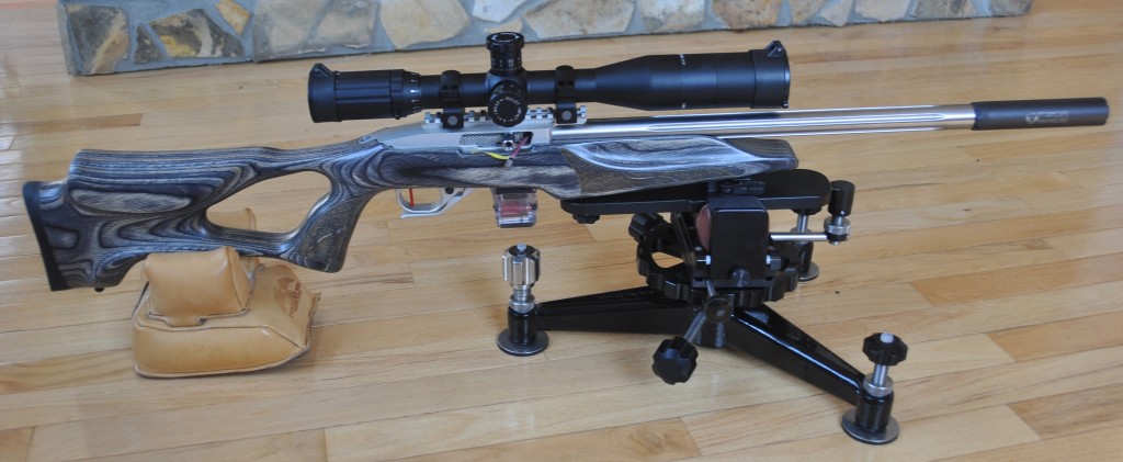

I've had an SWFA 3-15x42 going on almost a year. It is currently on my Kidd SuperGrade 10/22 Bench Rifle, I plan to add a few more SWFA's this year for my Daniel Defense SBR and my 16" DD AR 16". When you get your's you wish you 3! Good luck with your purchase.
