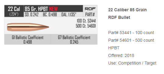

    Also Nosler is releasing a new 85gr RDF, I'm curious to see the stated BC on that one too.
