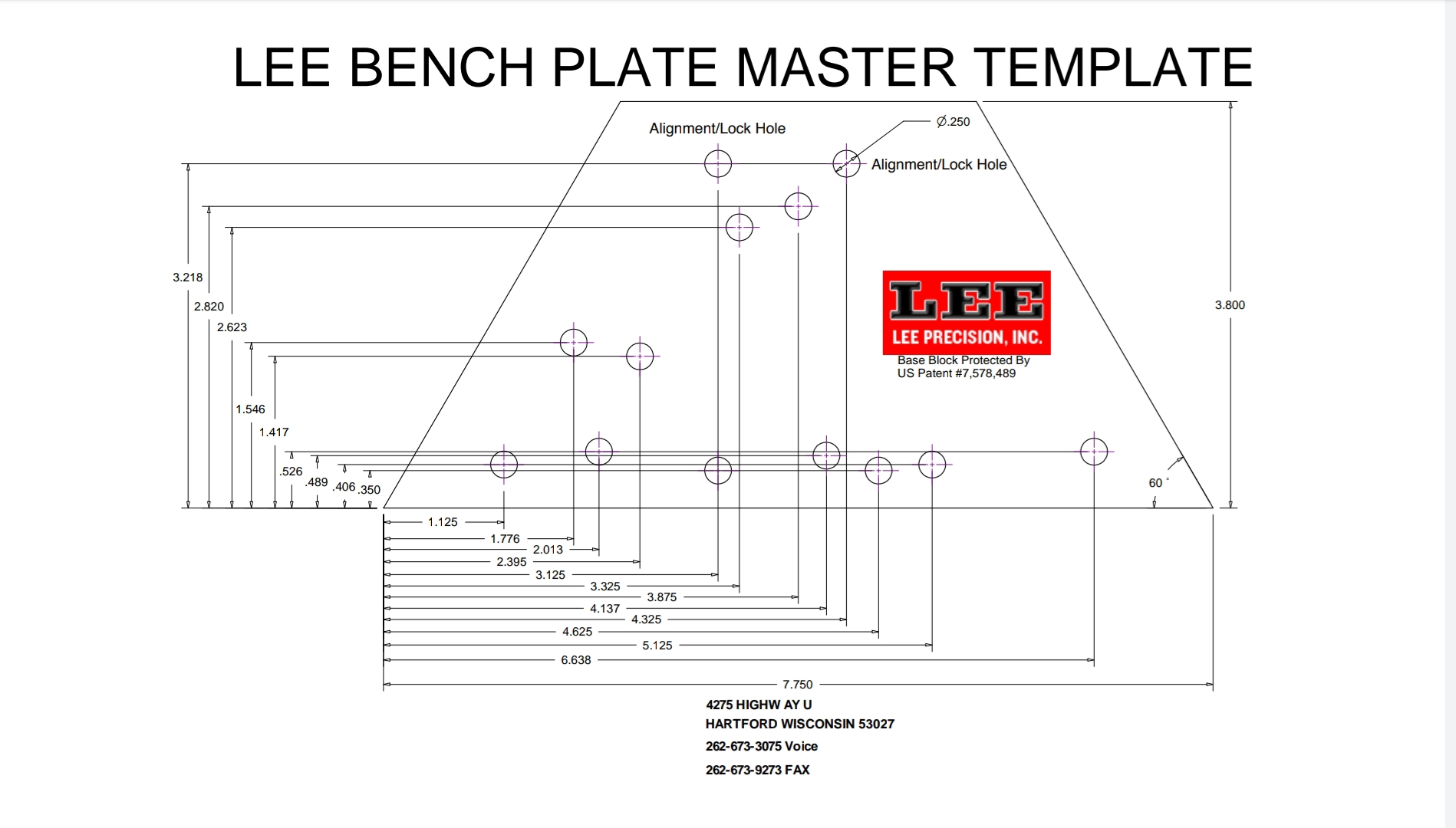

Can one of you with the mec measure where the mounting holes are on the press? I'm curious if it will fit my current Lee Bench plate
For reference:
