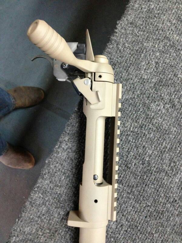

PCR did it for me. I provided the specs and sear and they milled the receiver for me. I'm sure they'll do it for anyone else, and I've got about 5 extra sears. They are only $8 from savage and are all you need to do the conversion. This action was an FCP-k, not anymore!
So does the release simply press against the sear, or is it attached? If not attached, does it pivot off the trigger housing? Finally, is this mod possible without machining the receiver? I'm having a hard time searching for a how too.
Please excuse the newb questions, I'm new to the bolt world. I haven't even taken the action out of the stock yet. Maybe it's time to explore.
Sear and bolt release are one piece. You can jb weld a lever to the existing sear to make it a top bolt release without milling the receiver. This is how CDI has you do it so that their bottom metal will work on bottom release guns.

The receiver is just machined a bit on the side, to accept the standard release. It came with the bolt release located in front of the trigger guard. Many stocks do not accomidate that set up, so I modified it. Check out post #12 for an example, this was my inspiration to just get it done right. My smith ended up only charging me $50, $69 with the lever installed. Needless to say, I'm very pleased with how it turned out. It also shoots fantastically now!
