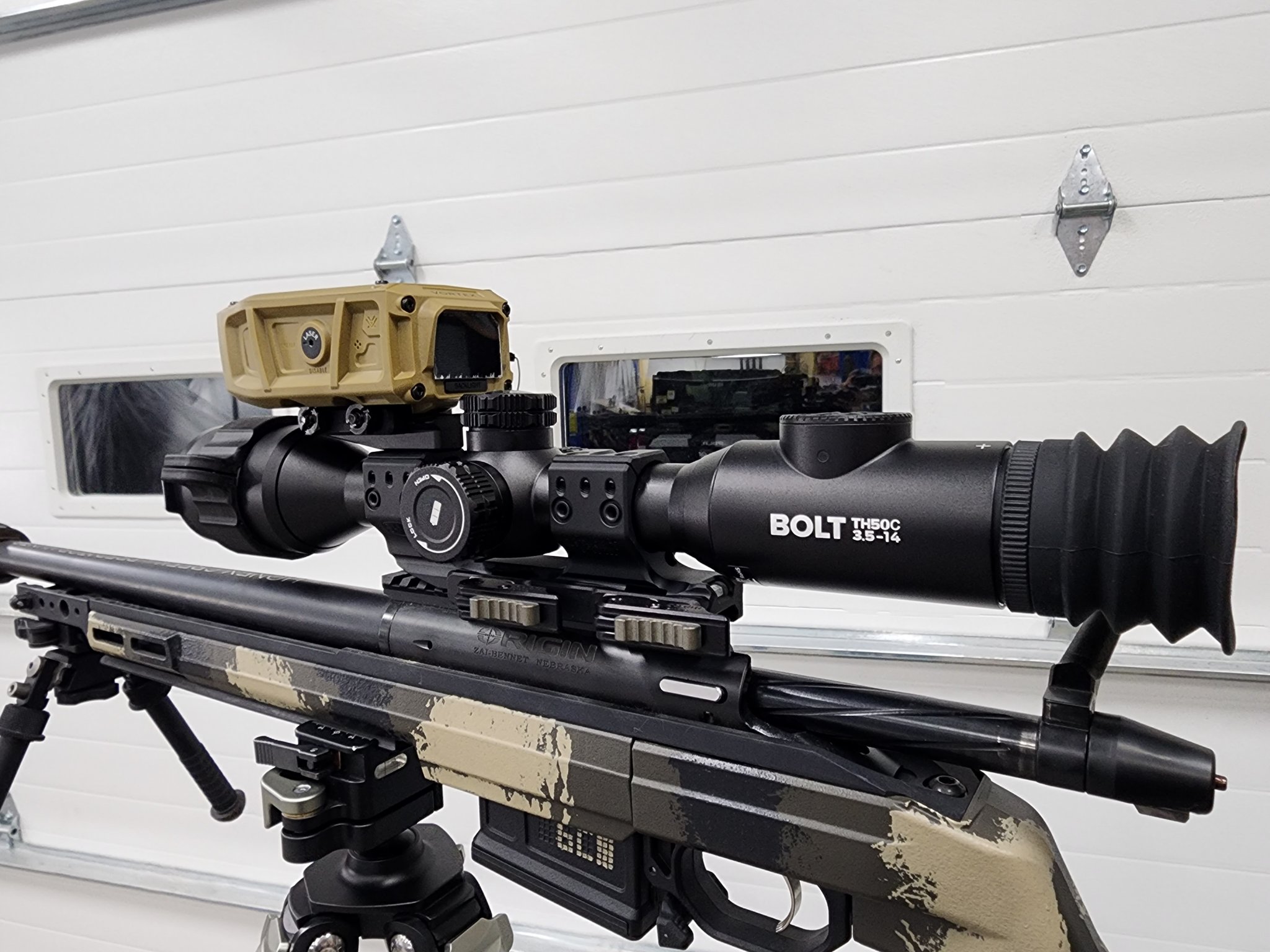

This was my work-around for ranging/ballistics long range

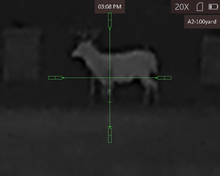

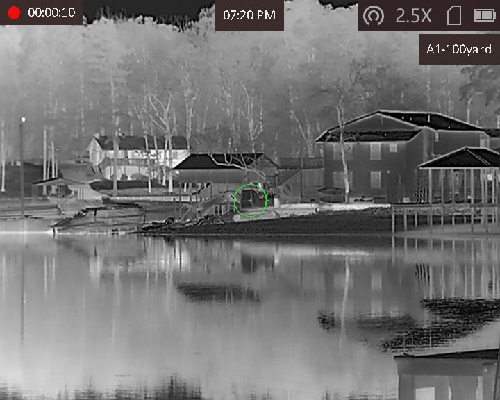

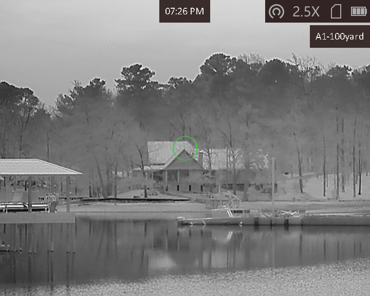

Really enjoying my AGM Rattler TS50-640. It’s mounted on my 16” MPR in 6mm ARC. Also, AGM is an American company, owned by Americans, who build all their products in-house in Arizona. 👍🏼
Here’s a few stills through it…
Max magnification (20x) in black-hot mode at 200 yards on a steel deer target (life-size)… This was also during the middle of a cloudy afternoon, and it is not a thermal target, nor does it have thermal (or reflective) paint on it. Personally, I’m impressed at how well it picked up a cold steel target at that distance, but I was able to hit the heart every single time. 👍🏼
Here’s an excavator at around 400-500 yards on the 2.5x (lowest) setting using black-hot mode.
Here’s a house that’s around 700-800 yards on the 2.5x setting, using white-hot mode.
