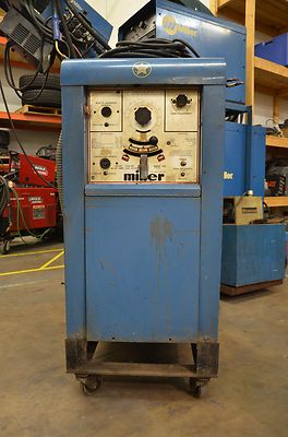

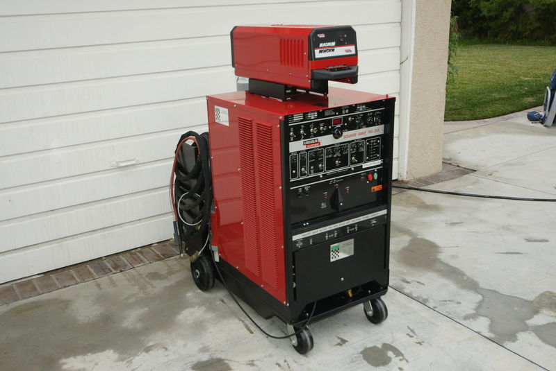

That is a very good question... I am a retired welder. When the lower cost welding machines came on the market the contractors bought the less expensive ones and sent them out to the job sites. Our welds were all X-Ray quality pipe welds. Cost / man hours to make repairs soon offset any cost savings. I was chosen many times to go and make repairs on someone else's weld... If there was an old Lincoln SA-400 diesel welder on the job, it became mine to do the repair.
For $700 you can pick up an older TIG machine (Lincoln, Miller) that will run on single phase power and have a foot peddle and the rest of the accessories.
Link is for an old Linde... It was a Cadillac in it's day... Never hurts to make some offers.
