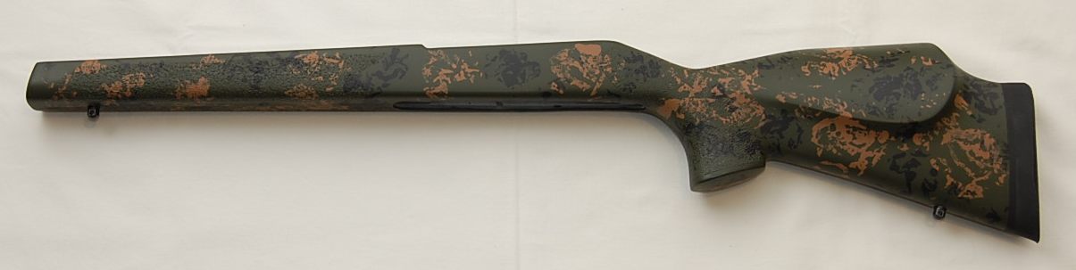

Ive just got one of the Robertson T3 tactical stocks in, nice shape, i like it, wheel for the adj cheeck is a bit in the way, but otherwise its good.

Hi Pete, what do you think about the quality of the Robertson stock?
I am thinking about ordering a Light Hunter Silhouette for my T3 Battue.
Once you bed the action on the tactical stock, can you please post some photos of the recoil lug area?
Thanks
Craig
Robertson Light Hunter Silhouette
Re: New Tikka T3 Bolt handle
Hi Craig,
The stock is ok. the cammo is a bit 70's wall paper looking, but otherwise ok, its the same colour as the one you just posted up.
But what pissed me of is that the adj cheeck piece isn't cut back enough for the bolt on anything but a .223 or .308 Tikka. I put a 300wm in it and you can't cycle the damn bolt unless the cheek is all the way down, pointless having an adjustable cheek then eh..
My guess is that Robertson had a T3 on hand when designing the stock, and didn't even think about the fact that on some of the T3's the bolts go further back.
I'll send you some pics and post some up as soon as i can eh..
Pete
