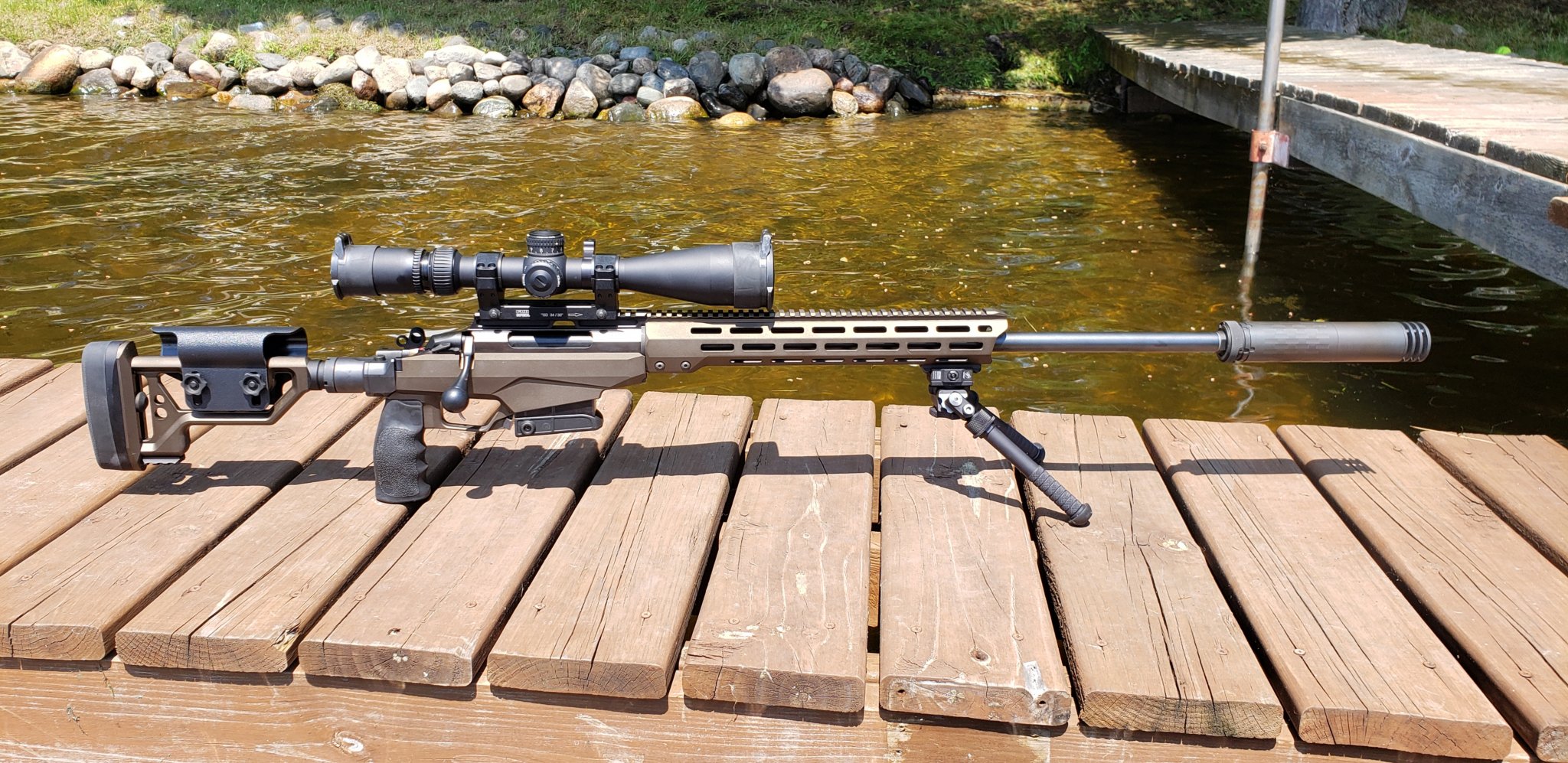

Here's mine in 6.5 creedmoor. Cerakoted in midnight bronze. She's wearing a Vortex AMG scope with Fab Defense unimount rings.
