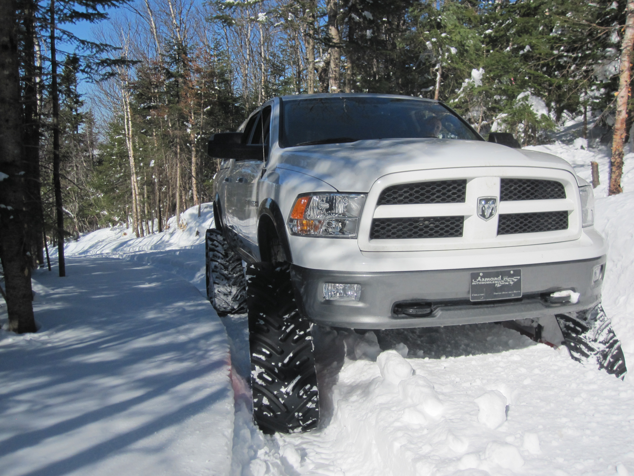

On our farm during the winter I need the clearance so I put on a taller size but the downside is the sidewall flex when towing heavy like I normally do. I’d like to go with bigger rims and a slight offset to give me a wider and more stable foot print for towing, then I wouldn’t need as much side wall height to give me my clearance.
I would just get a dually but they suck in snow and ice.

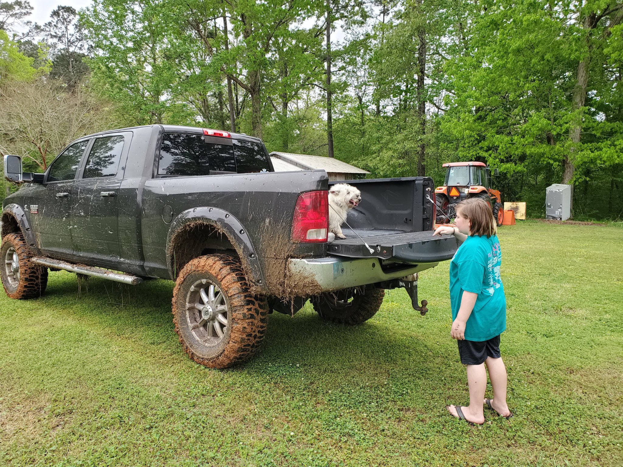

I work in the oilfield and also have a Ram 2500. Ive had MT type tires since the day I drove off the lot with the truck. The Toyo MTs were good, my 2nd set I had went with Interco swamper SSRs (Those sucked in every way possible) and now I have Interco M16s. Im very happy with the M16s. I drove down to Rayne Louisiana (I live in Louisiana) and got these 37s for 1400. Thats including tax, mounting and balancing. So far the M16s have been my favorite tire. They work well in sloppy stuff, have the load rating I need, and the kids and dogs like to pile up in the bed when Im working on the property.

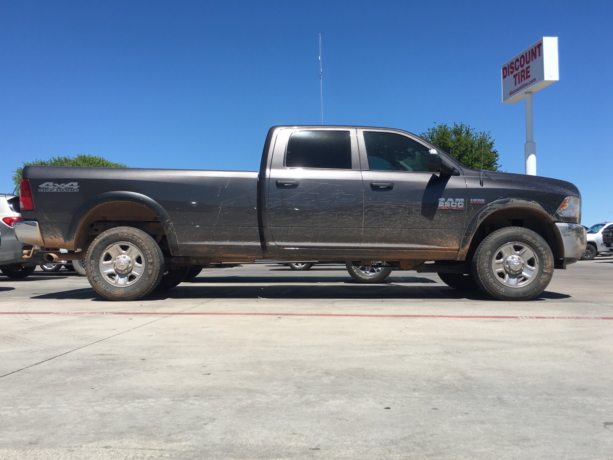

Here’s what I went with -
Before

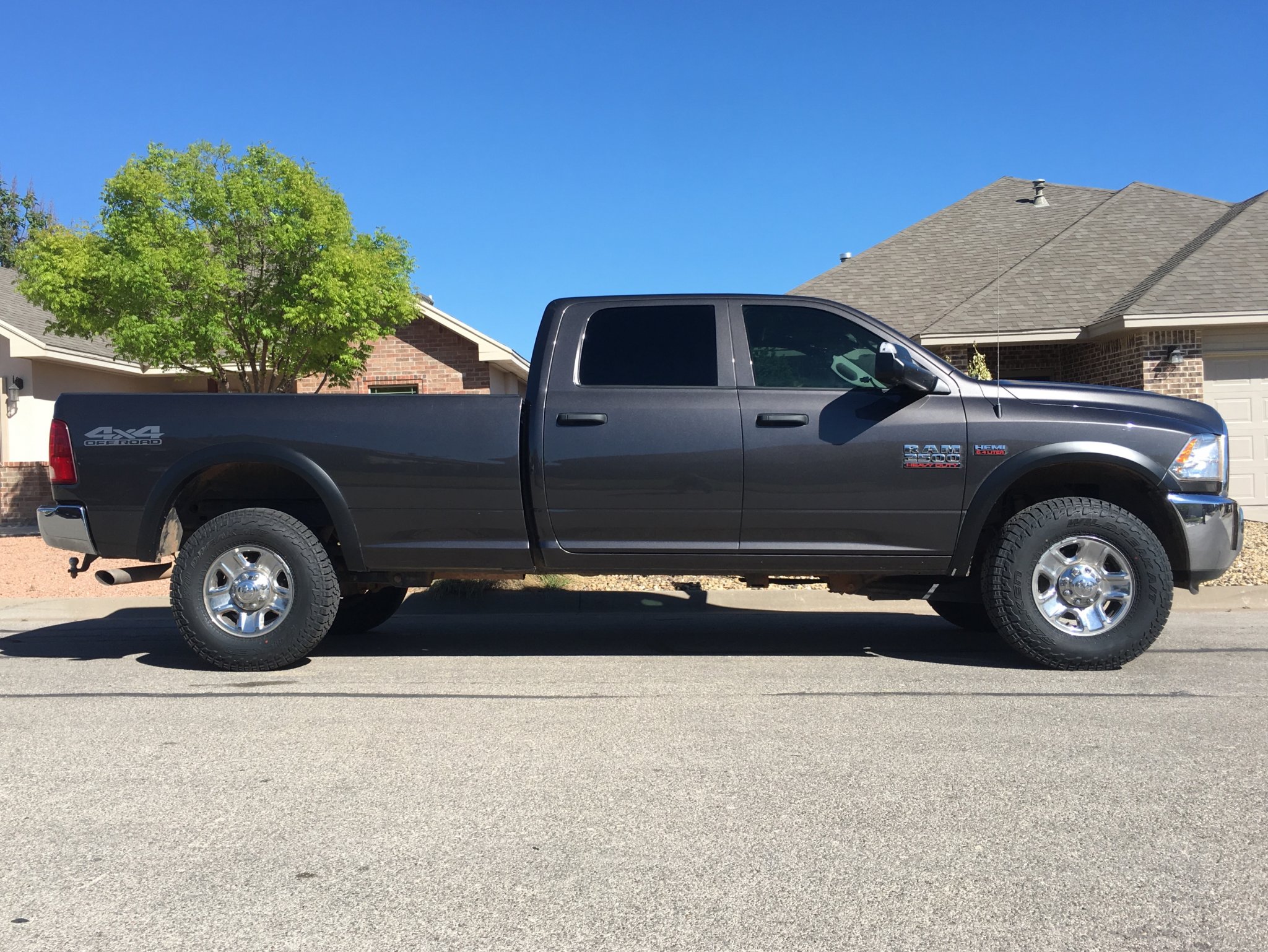

After
0f7c0fd1-1332-46ea-8724-190d5f2a2bad-jpeg.7066546
Falken AT3W 285/75r18, which is a 35x11.5r18 essentially. No rubbing on stock suspension, almost no additional noise over stock, and they seem great so far! Really changed the look of the truck. I'll get AEV salta wheels next time around.
I’ll have to post again once I have more miles on them and have felt them in rain, mud, dirt, sand etc.
