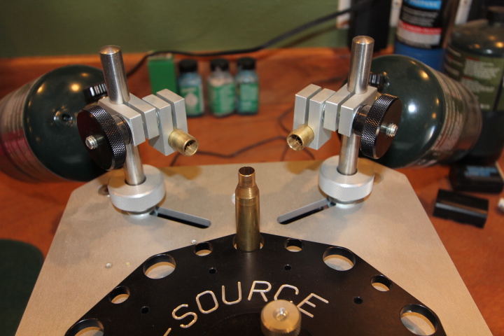

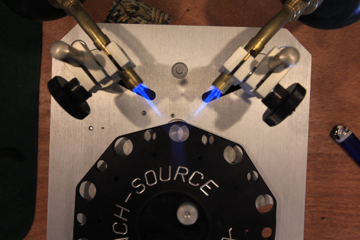

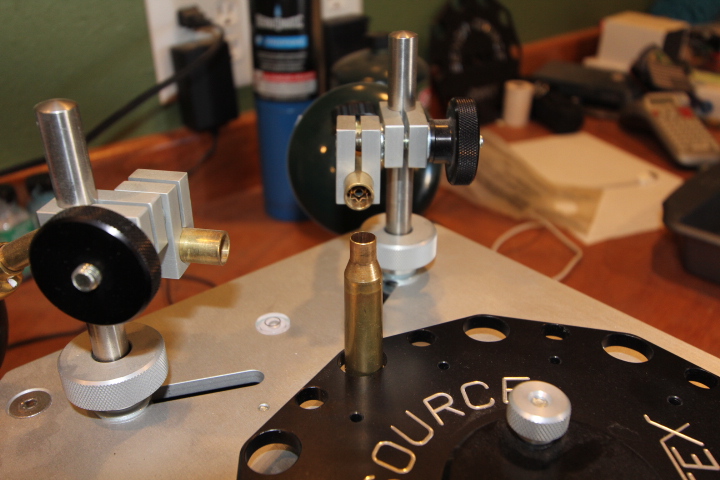

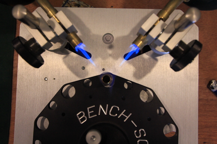

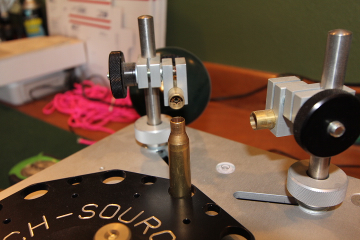

here is how i set my machine up.
i use 650 tempilaq and 450 tempilaq
i set the flame 1/4" out side of the case plate.
I set my machine up a little differently than Joemusso. Instead of having the torches located on the inside of the vertical posts, I set them on the outside in order for the flames to be further apart. I adjust the tip of the flame to be approximately 3/8" from the from the case with the tip slightly above the shoulder junction. I would suggest using the Tempilaq as recommended and experiment with some sacrificial cases. Start with a shorter time duration and gradually increase it until you get the desired results. Trust the Tempilaq since color change is not a reliable indicator. I have seen variance in color with the same make of brass even when the heat and time were the same. Good luck.

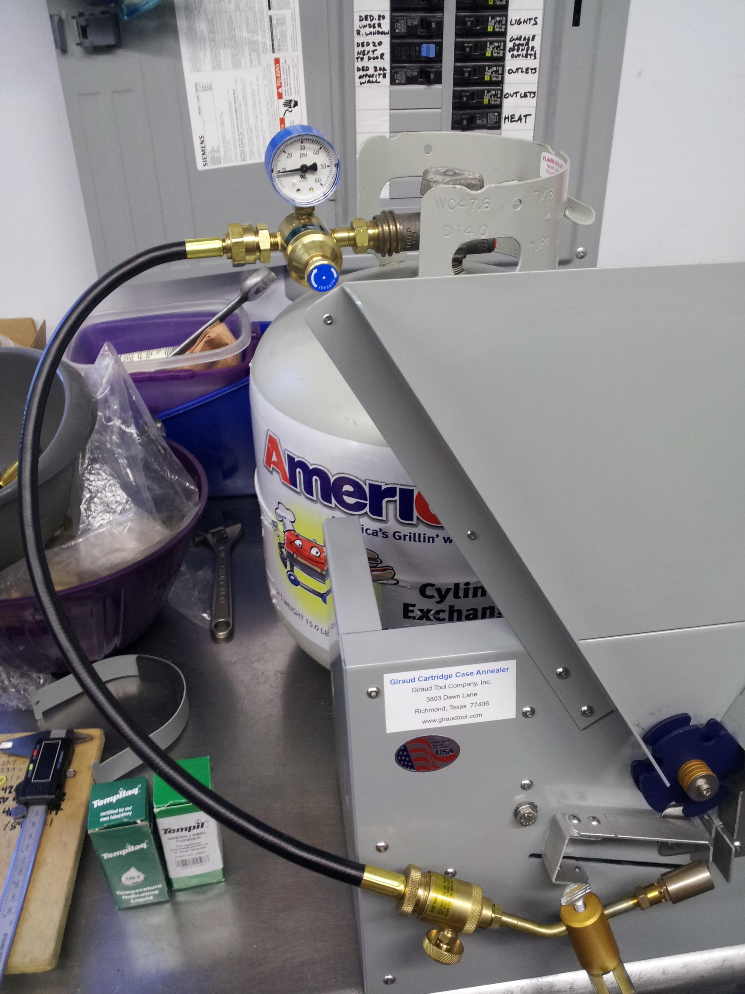

Another thing to consider is to set up your Bench Source machine with the hose setup to run from a 20 lb. propane cylinder vs. the small bottles on each torch. You will keep a much more consistent temp this way.
http://www.snipershide.com/shooting...-convert-yours-run-one-10lb-propane-tank.html
Something like this, only with a splitter. I find that it works best if I open the torch valve all the way and control the flame with the regulator... 10 psi seems to work real nice for me.
Joe
