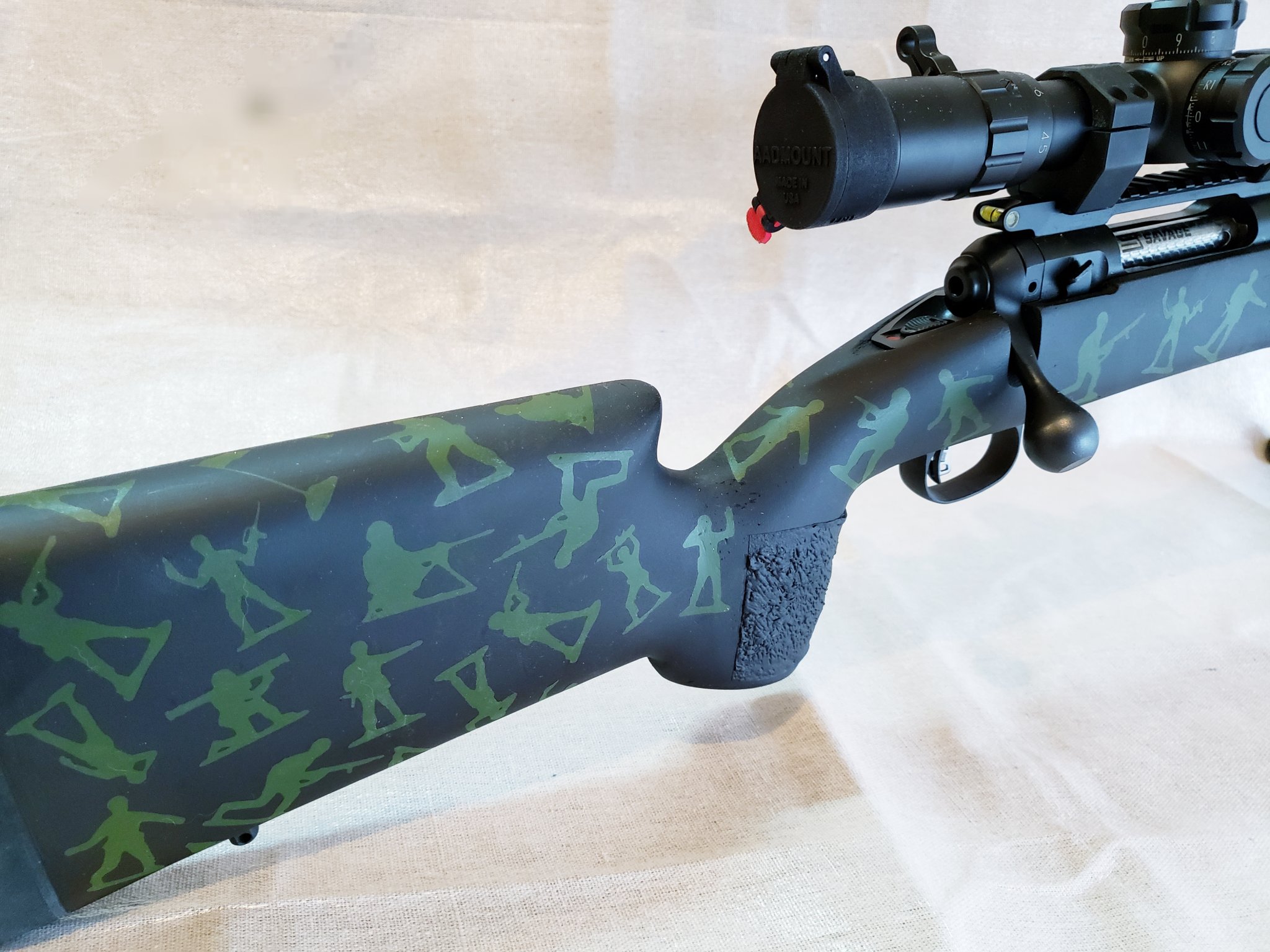

First project with duracoat. Wanted to do a play on Luis Vuitton but the men's version. Turned out as I wanted, but my question for duracoaters out there is should or do I need a clear coat over the top? Polyurethane? Will it hold up without one? Thanks for any insight.

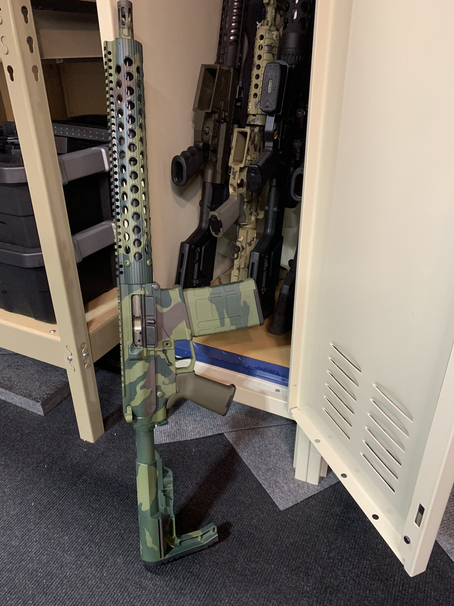

I use Duracoat clear flat over my camo jobs. Probably does not need it but I think it helps. Over the years I have found that Duracoat does chip, scratch and wear. A lot of members here will say I'm applying wrong, but I don't really see any kind of coating being "bullet" proof.
I agree with cd132. I have not clear coated any of my duracoat jobs, but after some years of abuse it does tend to wear in spots. In my opinion any application is going to show wear over time. And before anyone can say I didn't apply it correctly...I applied it exactly as per instruction. My next project I am going to try the Duracoat clearcoat.
I've put flat clear on both of the rifles I've coated. Interestingly it didn't make much of a difference sheen-wise. The first one has had some chipping near the mag well, just the top color flaking off, but the base isn't affected. I think I put the top color on too thick. The second rifle, no issues. But, they're both pretty fresh and haven't had a lot of use. I was hoping the clear would sort of level out the finish like it did when I tried pin striping a helmet. ugh, that was a mess. It didn't do that either, it goes on really thin. I laid down a few coats and didn't notice much of a difference. I'll probably still keep adding it though, just for that extra little layer.
I agree. Duracoat does chip. Not terrible, but I got a couple dropping it in the woods. Better to have it and not need it. Depending on your tastes, it can also add shine or flatten the color.
Nice work for your first one! I did several with rattle-cans then learned to use an airbrush and have done several with duracoat, but never used the clear coat. One thing I have learned is to use adhesion promoter, available at any auto parts store. Never used it on wood/wood composite stocks, but the promoter on polymer stocks works like a charm and seems to solve the chipping issue.
Reactions: NashtyGrunt
I absolutely LOVE that idea of using the archaic Army men! Genius!!
