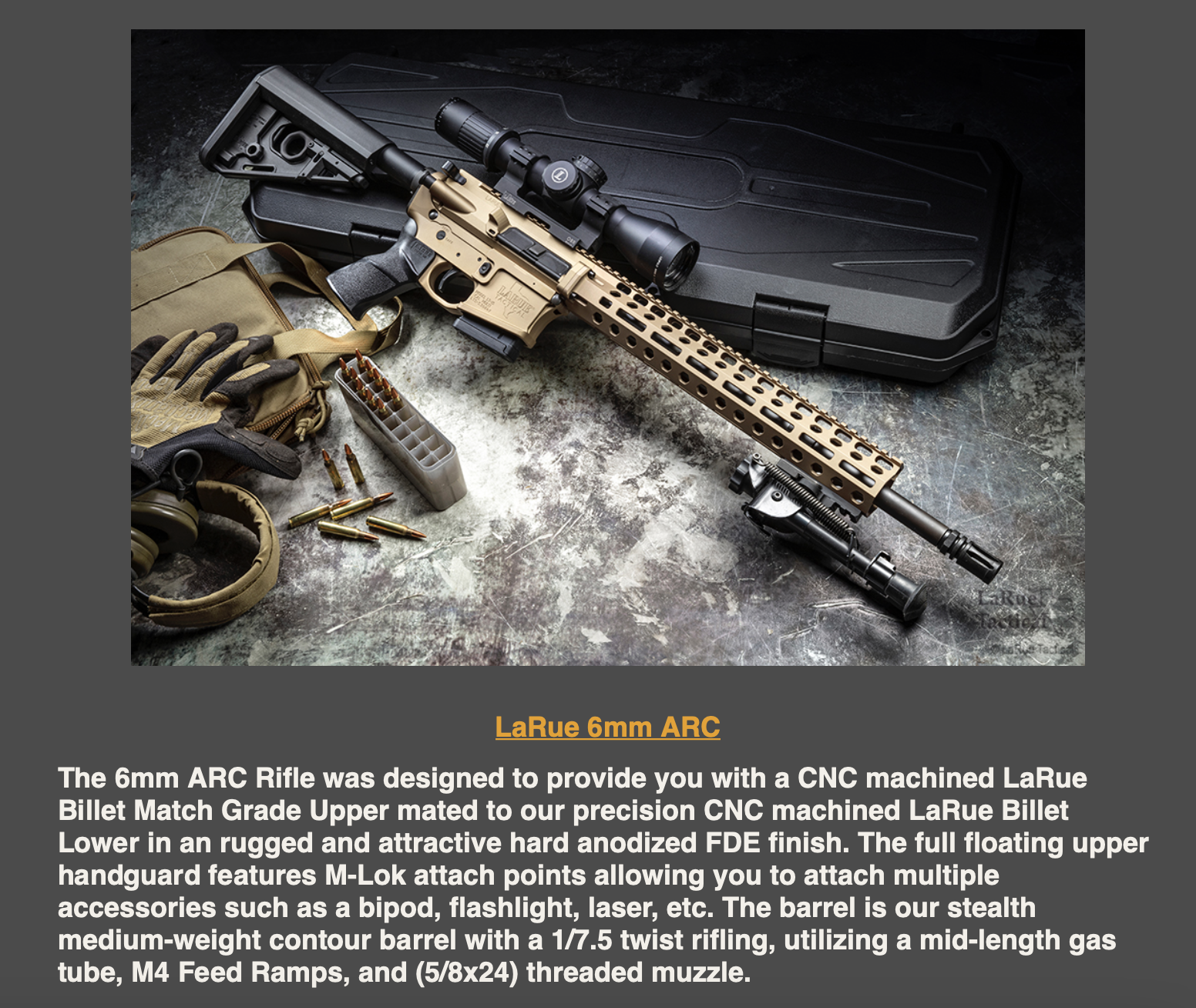

Otherwise... I would be tempted to try one of LaRues 6MM ARC's... but it is only a 16" barrel.

Larue just came out with a complete 16", 6 ARC upper. I know of a couple of "Grendel Hunter" uppers which have had great reviews. Grendel Hunter has a variety of barrel lengths.

Larue is supposed to make a good product. I've never run his rifles, just his mounts. But if they're any indication of quality and reliability then go for it
