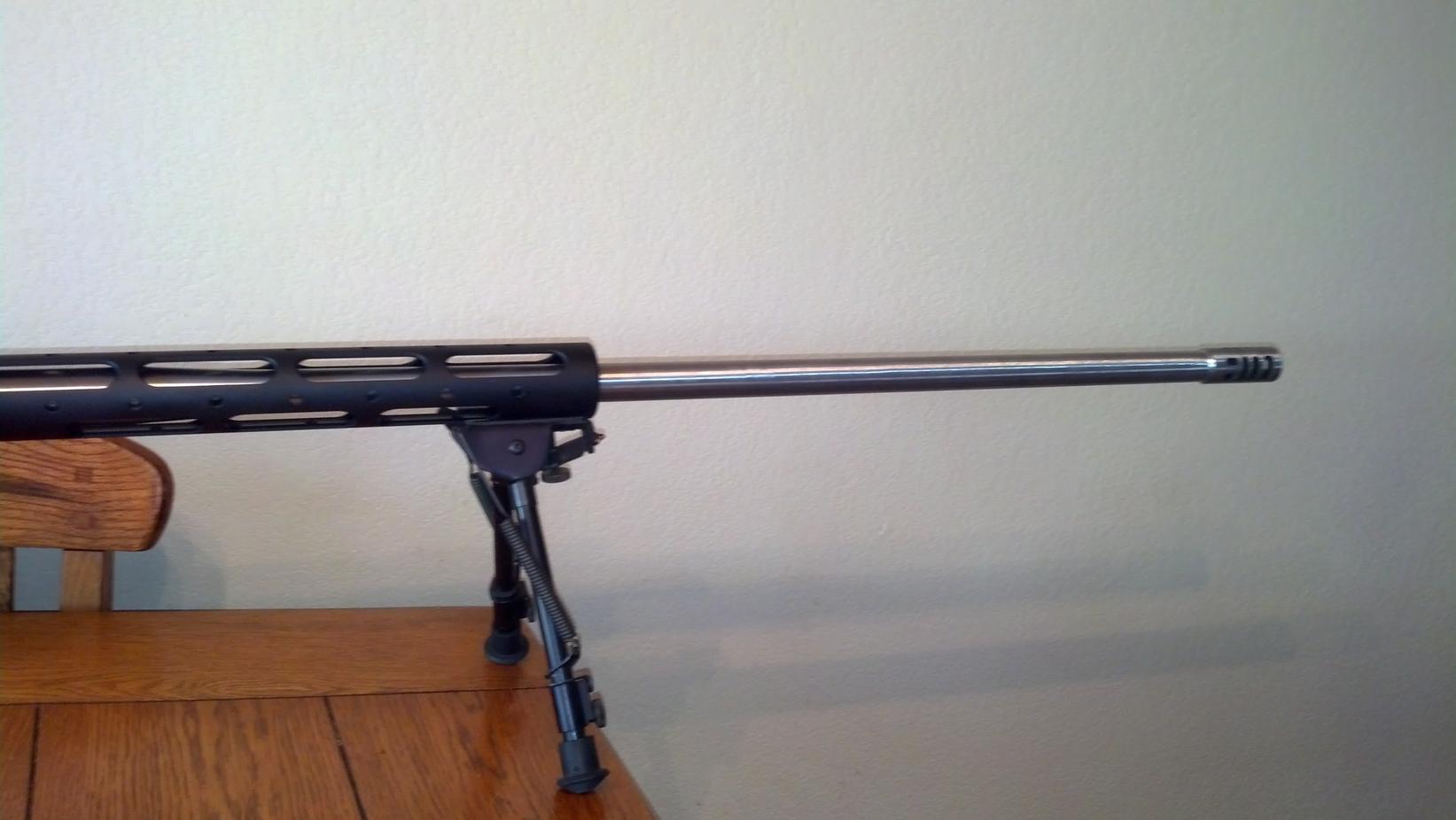

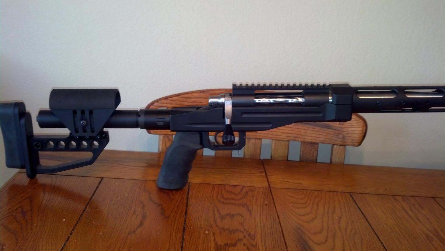

It can be done with some time and patience. I had no clue how to run a lathe when I got mine years ago. Within a couple weeks of getting all my tooling I had put together my first rifle. 300 WSM on Howa action blue printed with a Shilen CM barrel, shot great and put some meat in the freezer. Havent stopped rolling since then, most of my free time is spent in front of my lathe and applying cerakote.
Kc
The action was CNC blueprinted. Threads, face, scope base holes, recoil lugs. Pretty much everything is trued up to bore centerline. Chad Dixson of Long Rifles, Inc. did that work for me. He does group buys on here. It shoots 1/4 moa when im driving it right
