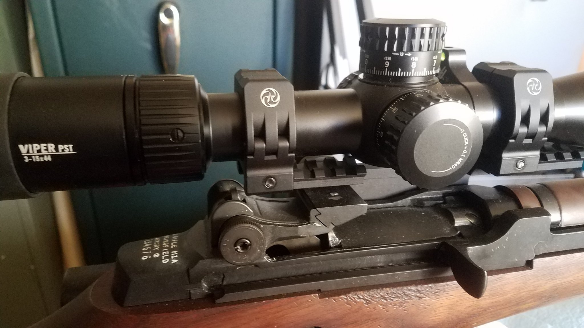

I'm using ARC rings with a Viper PST on my M1A. works just fine.
