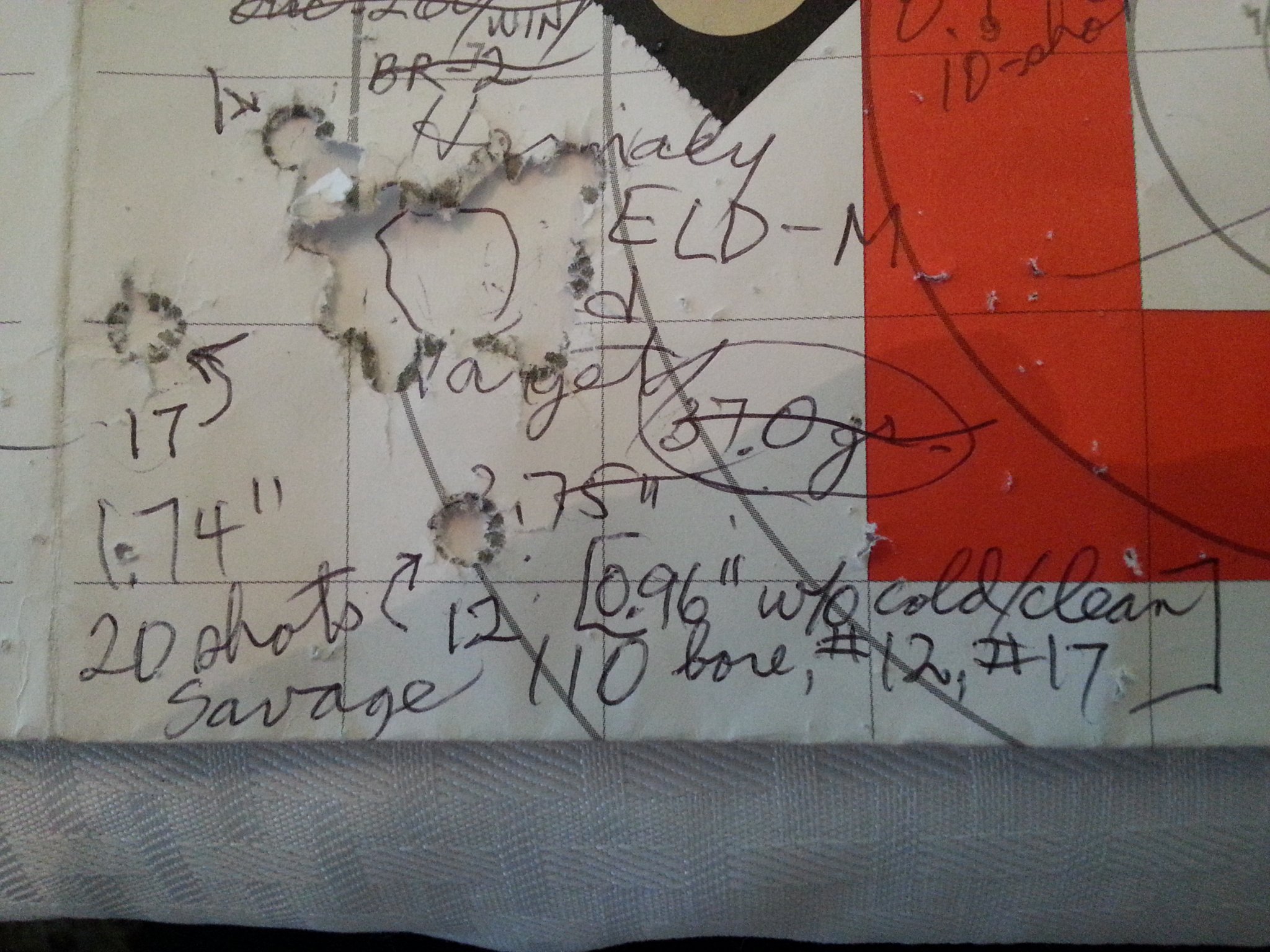

Your skinny-barreled .30-'06 will probably do OK for non-competitive use. I have done this many times, and Creighton Audette showed many years ago, that skinny barrels shoot just fine. If the action is properly bedded, they can shoot acceptable groups. Example: 2 MOA is a decent group at any range, for a 20-shot group. It won't win F-class, but that's not the point. My Savage hunting rifle (.308 Win with thin barrel, 22" long) shot the attached group with no delay between shots, maybe 15-20 seconds between each, for position, aiming, firing). These are handloads. Shots 1, 12, and 17 were out of the group, bringing the 20-shot group to 1.74". The other 17 shots were in 0.96".

Thanks for the info guys. The best group I shot that I actually measured was 3 shots about 2" at 100 yards but that was with a $20 wallmart scope and cheap 180 grain soft points shooting off my rolled up jacket. I have a better scope in the mail and will be putting it on when it gets here. I'm hoping that the better scope and ammo will improve that 2" group. That's a nice group u shot man. I have thought about giving it a diy bedding job later down the road. There aren't any gunsmiths around my area that do bedding jobs or barrel replacements
