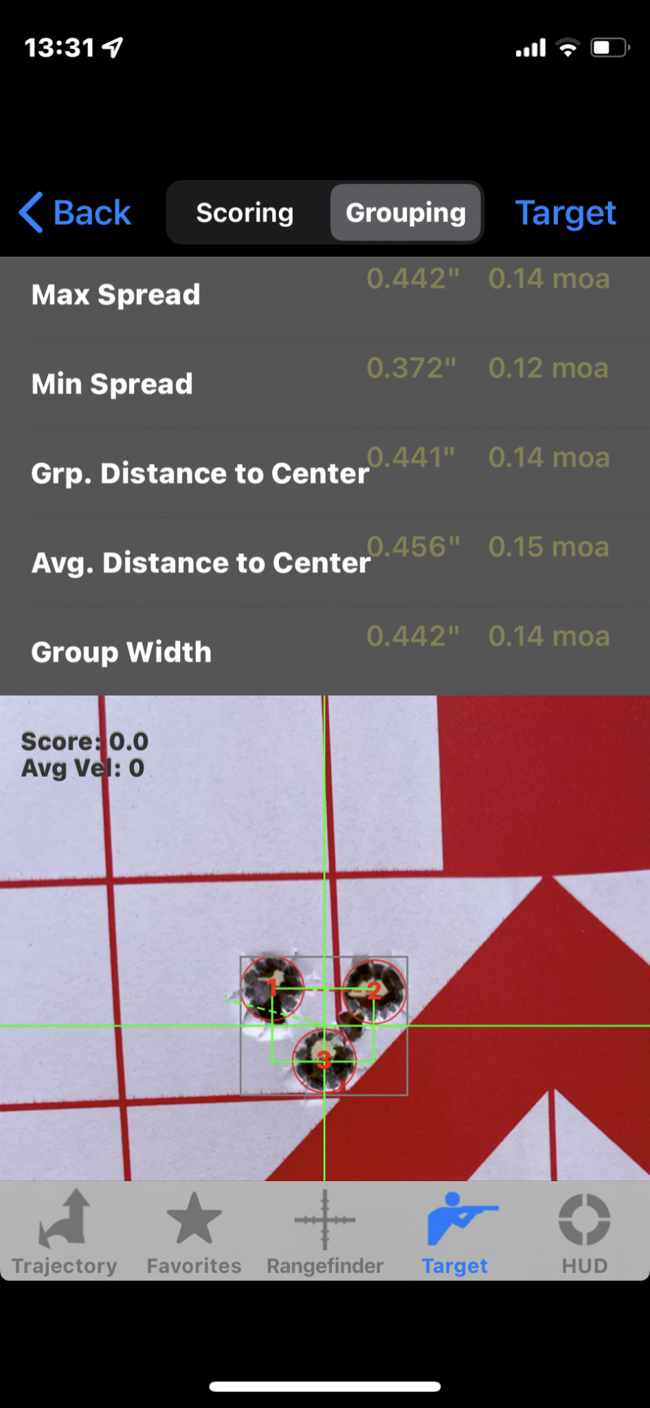

Oh boy it likes the heavy’s! That’s 300yds with a 175ELDX and 61.5gr of 8133. That will work all day long for me. Under .25MOA in a cheap over the counter gun is just fine with me.
