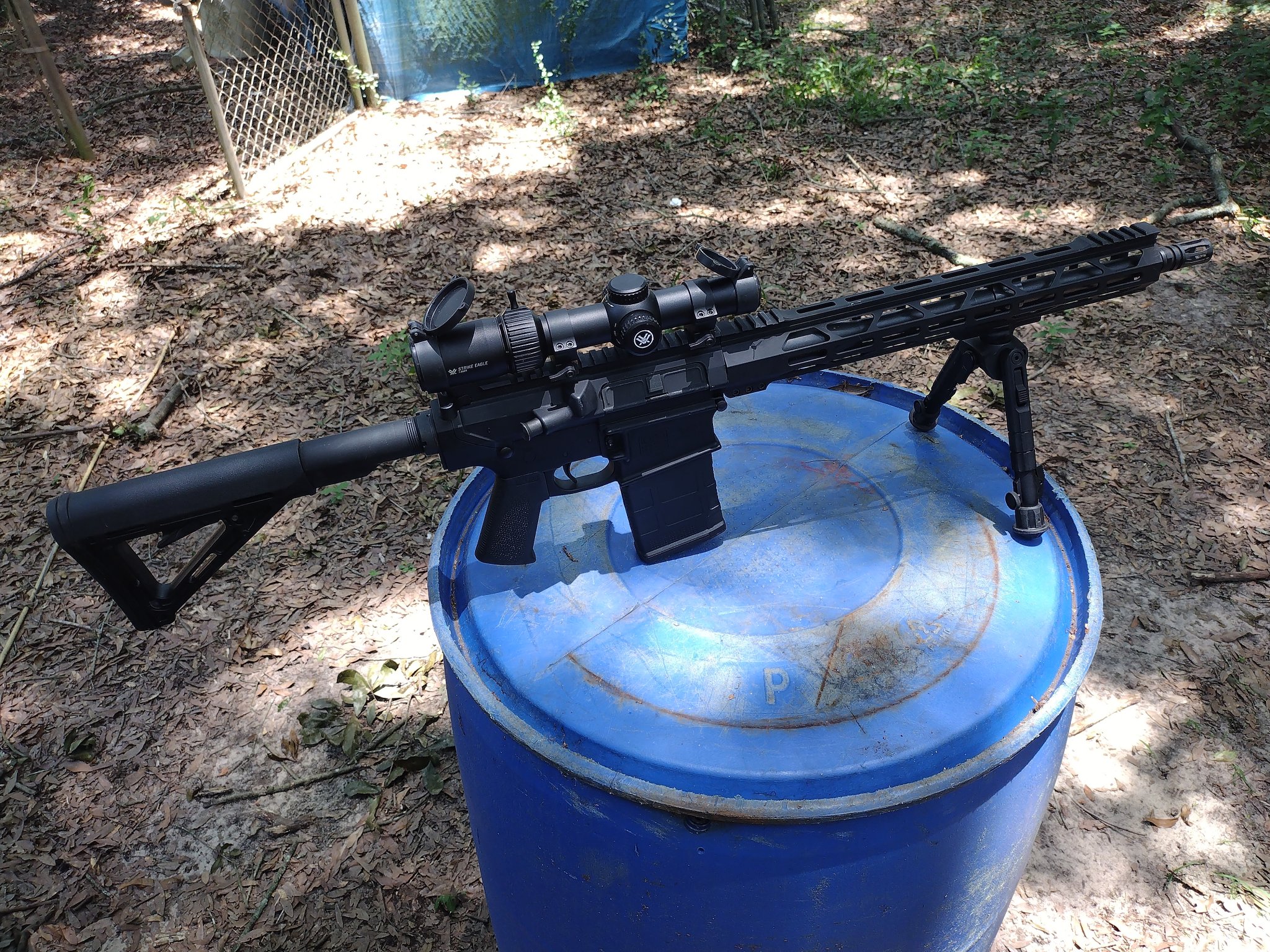

Picked this up 2 weeks ago for $1200 with a Vortex strike eagle 1-8x24 & 2 boxes of ammo.
Shot it last week just to check function. Spent cases were 5-6' at 5:00, under gassed??
I worked on it Saturday, I changed the trigger, furniture and upgraded the rings to a cantilever mount. I cleaned and lubed everything (it was pretty dirty & dry), but when I tried the stand up test, the bolt failed to support the BCG, I guess I need new gas rings? I was told it was only about a year old. Is it possible to wear out rings that soon?
I'm new to the AR platform, so still ignorant, but I am learning. Any advice is much appreciated.

Gas rings are cheap, and I need a few extra mags. Only other upgrade will be a muzzle brake, I already have it, just didn't have my wrench the other night. I need to sight in the scope and I'll know then if it improved any.
Thanks guys
.308 BCG won't stand up without falling even with new rings. The weight of the carrier is too much so that test doesn't apply to the large frame rifles. In fact some large frames have been known to function without any rings at all, its not a good idea but it just goes to show that test is invalid.
I like the McFarland one piece rings and I keep a few on hand. Buy some rings and put it in your kit but keep shooting what you have until you start to experience malfunctions.
With one piece rings that test isn't valid even for an AR15.

If the round count is low, (less than say 500), then the BCG needs a LOT of oil inside and out. Until well broken in, the large frame ARs tend to need a lot of lube or they will malfunction more frequently. There are many brands of ammo that are under-powered as well-try a few different ones before deciding it's under-gassed.
Federal American eagle 150 grain FMJ
As long as it is 100% functioning... I'd consider my self lucky to have such a "mild" ejection. Large Frame AR's tend to be overgassed, which has its own set of issues / problems.
It also could be still breaking in. And ejection could "improve" after breaking in / smoothing out of surfaces.
