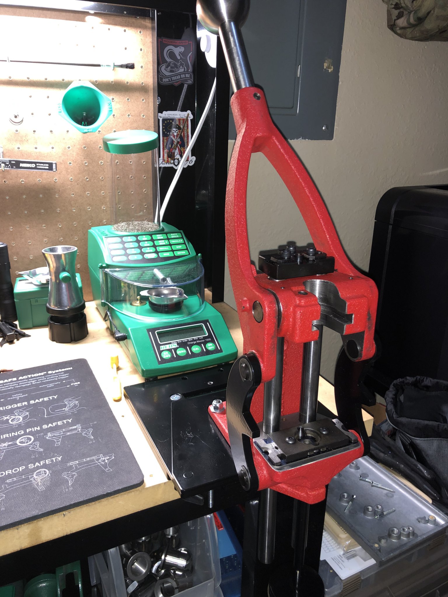

Just got my Inline Fabrication mounting plates and accessories for the Forster Co-Ax press bought from @Clans1971. The new (to me) press is setups and ready to use for loading my 300 pieces of match brass. Everything setup wonderfully less my RCBS bullet puller die... that’ll need to be replaced with either a Forster or Hornady.

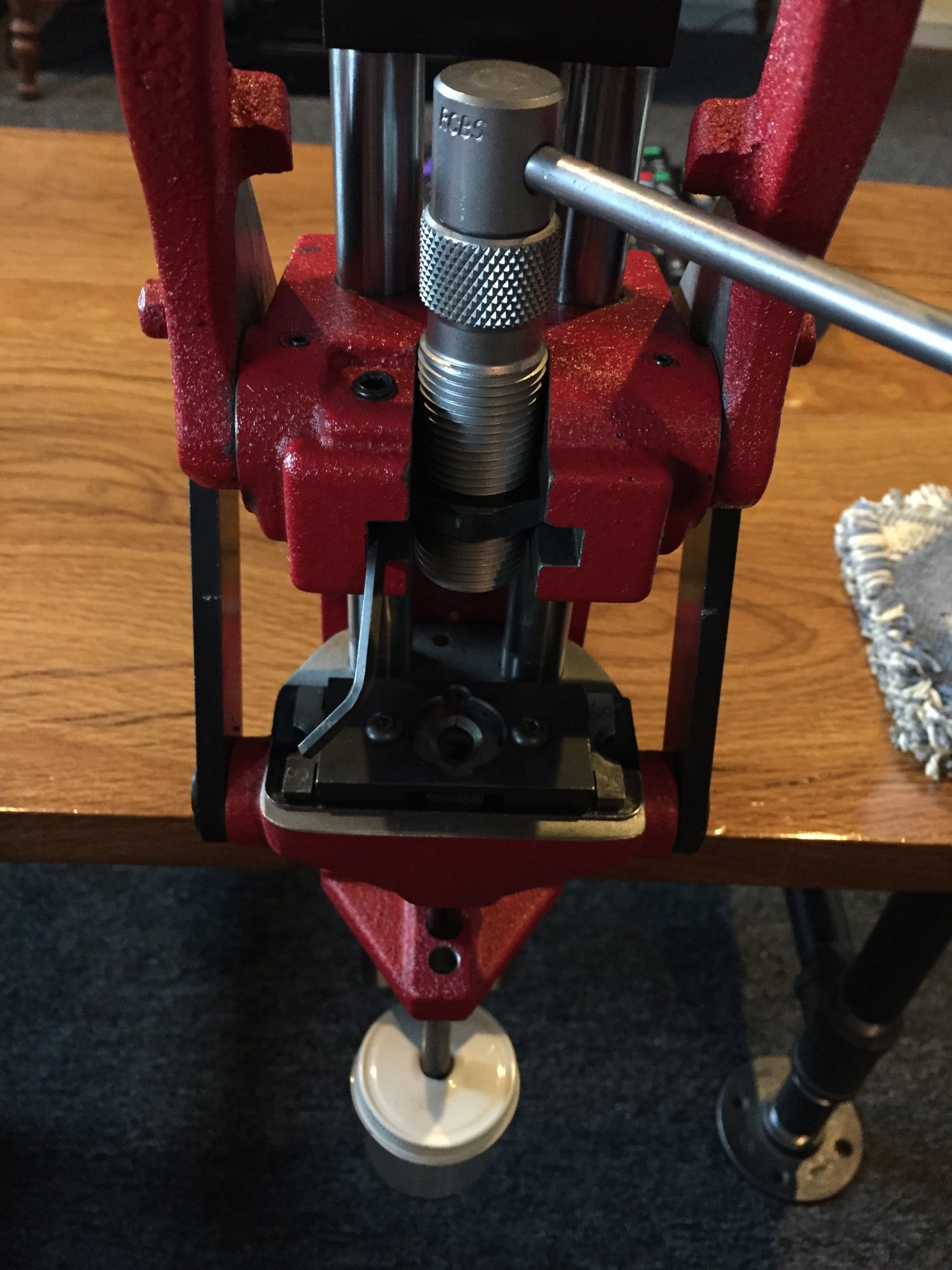

If you already have the rcbs puller it can work. The rcbs has a hex nut and I stick a, 3 mm I think, Allen wrench in beside it and that stops it from spinning. If you’re buying one then yes, hornady all the way. But if you already have the rcbs it’s not the end of the world.

This is what my rcbs puller set up looks like in a coax with the Allen wrench jamming the hexnut from spinning.

So you’re saying that you assemble it all outside of the press and then stick it into the press to pull?
Yup. Tighten the collet on the bullet outside the press. Put the die in the press, lower handle while holding half of the shell holder open, once the case makes contact let the shell holder grab and then I can push the handle up and pull the bullet.
