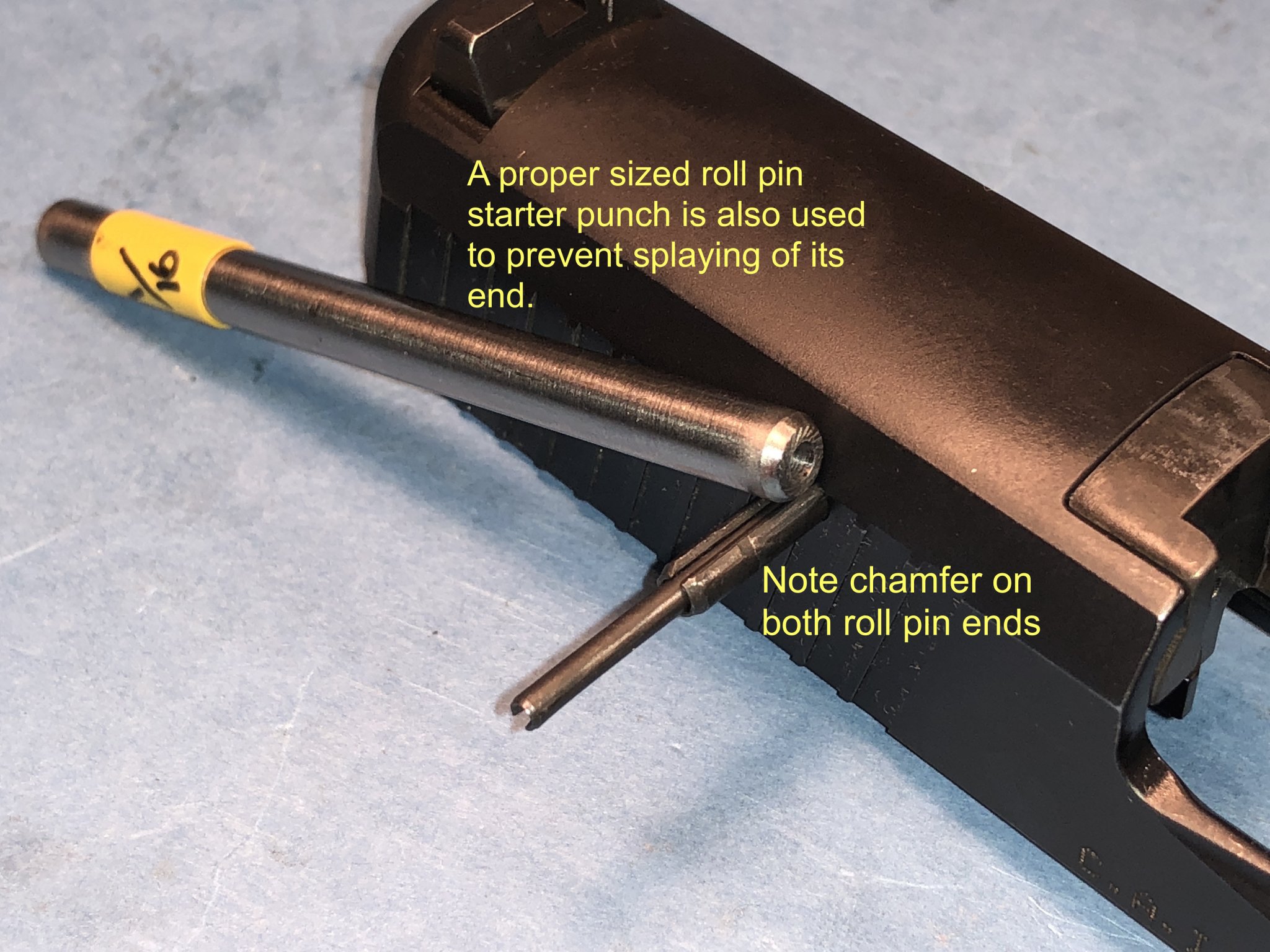

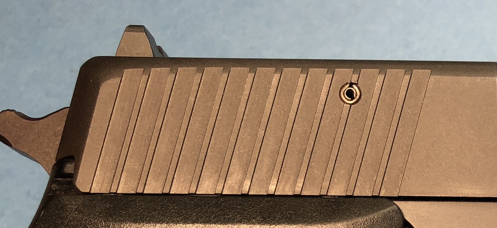

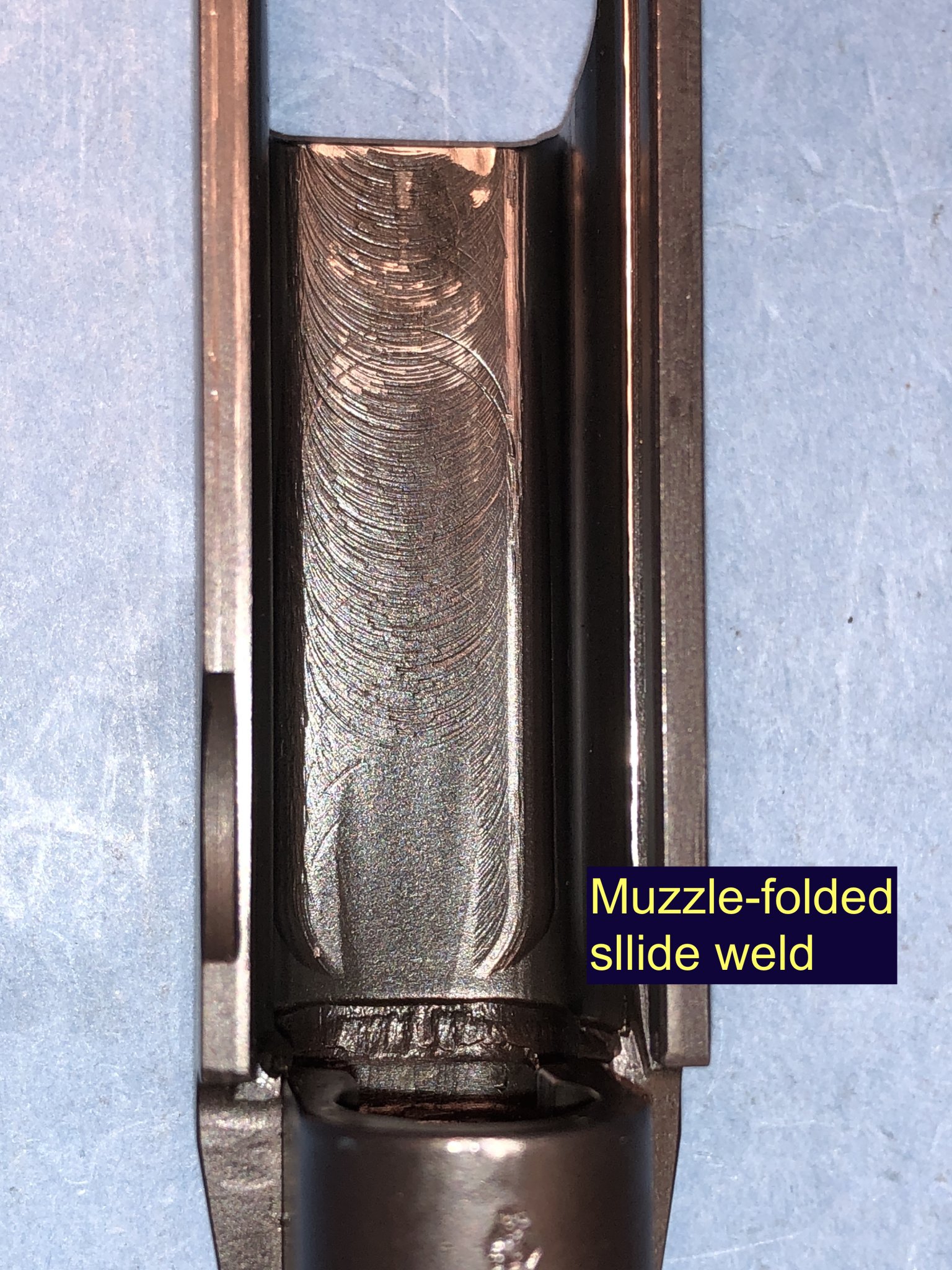

    Oh, thought and looked and almost forgot for older SIGs: two piece slides. Look REALLY HARD at the roll pin that keeps the slide together. Easy enough to replace but theoretically catastrophic if it starts walking out. Can do with use so just make part of your inspection cycle when cleaning, if not already familiar. They make a couple 226s so not sure what you have.
    Also means... you can't get to the extractor (and maybe the firing pin!) springs without removing that big roll pin and getting the bolt out. So... if not familiar with that, look it up and figure out either how to order the bits or which friend has a good set of roll pin punches.

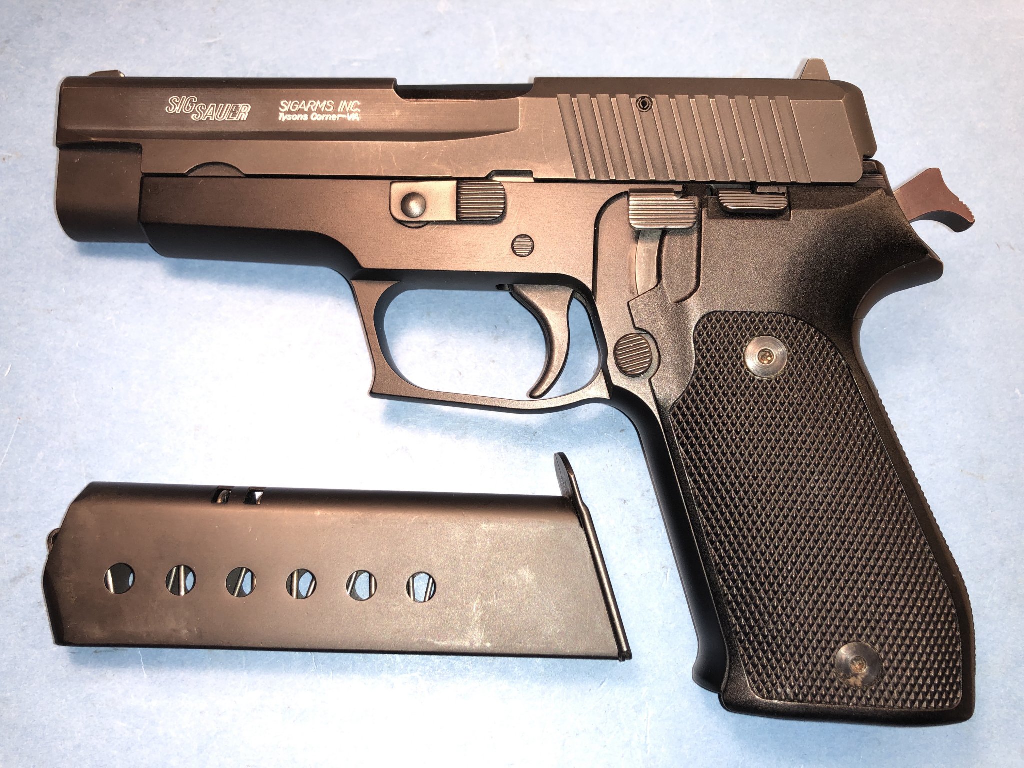

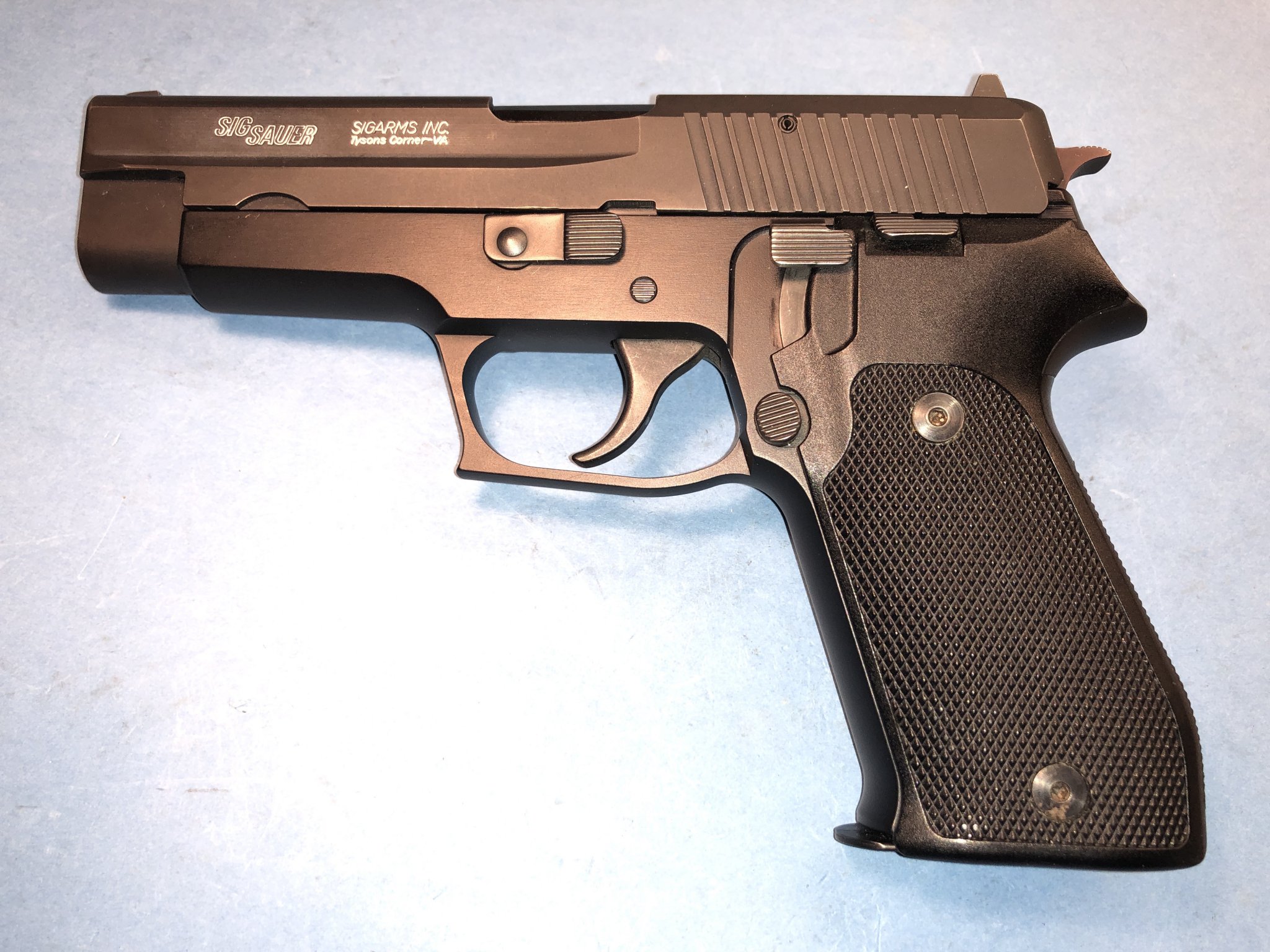

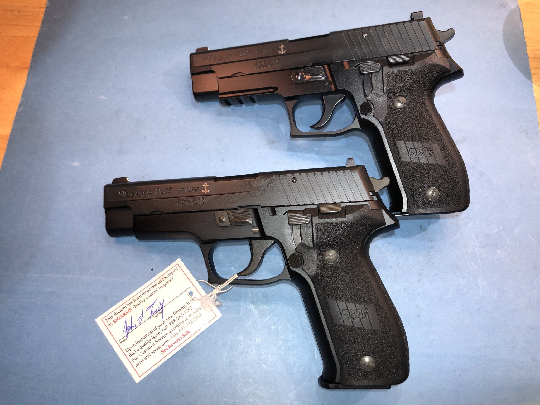

    I have this Tyson's Corner, VA (Sig USA first destination for importing Sigs, that no longer exists to the Post Office) Sig P220. Carbon steel folded slide (think pizza box), muzzle of slide welded to folded slide (slide with two "ll's is German, LOL) with breech block insert held in place with heavy duty dual concentric roll pins with their slots at 180 deg apart. Spur profile hammer is a identifying characteristic of the P220. Both 7 & 8 round magazines will run.
    I shot it out the back door this evening, and it seems that I just left it too dry. I usually put a little grease on the slide rails, and just plain forgot to on my initial inspection. Put a dab of grease on there and it feels "right" now. From the looks of it, I doubt this one has seen much range time, but I'm going to fix that. Pistol was proofed in '89, my Dad has one that is Browning branded, but I don't know what year it was born.
    ...I have this Tyson's Corner, VA (Sig USA first destination for importing Sigs, that no longer exists to the Post Office) Sig P220...

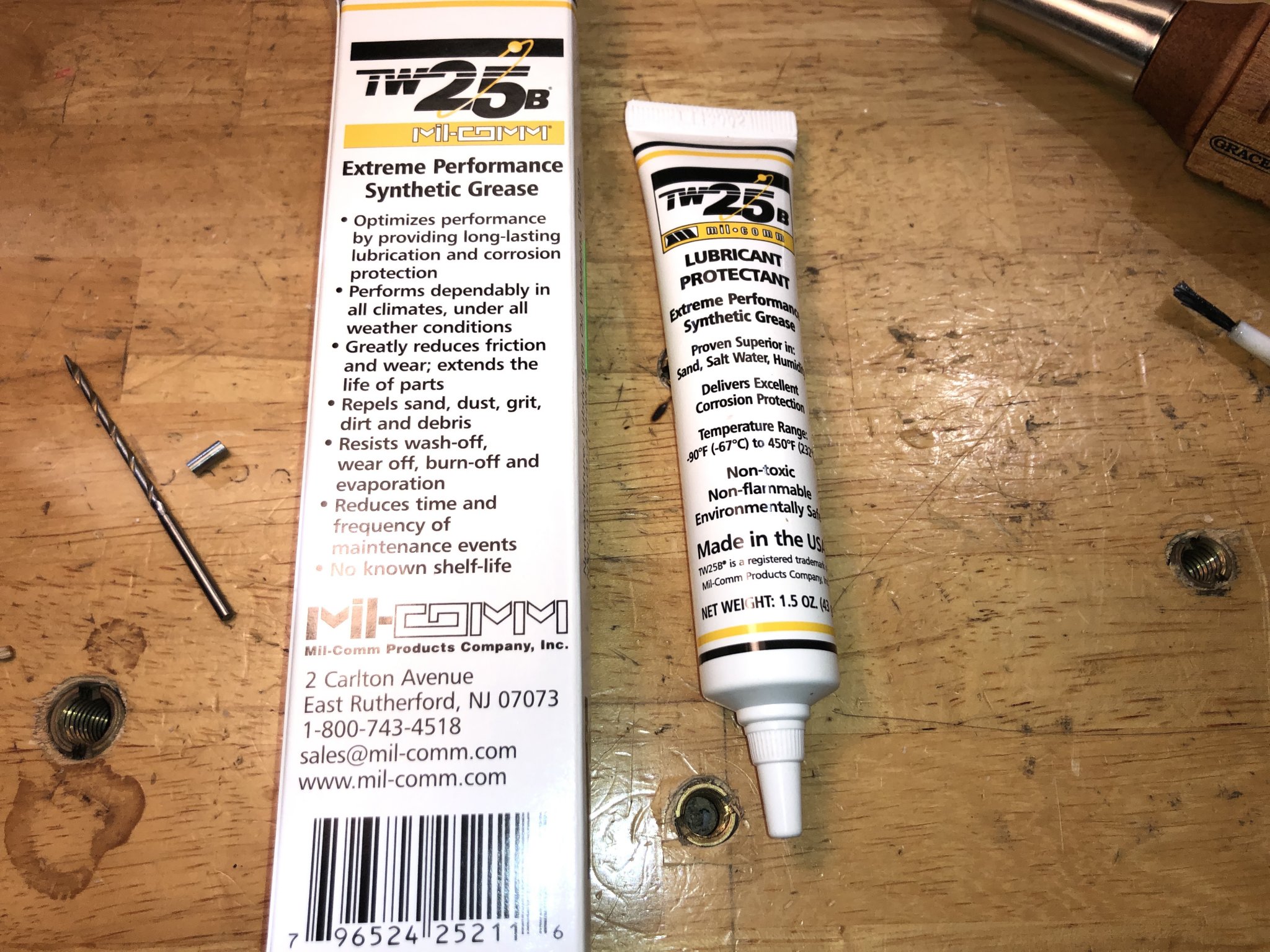

    Just a suggestion, run TW-25 synthetic grease on the rails of your SIG P220 and P226.
    I buy it in the little 12cc Syringe applicator, and it makes it soo easy to put on in tight places. I apply it to the slide recess on the inside edge of slide vs putting the lube on the frame.
    I also use the same grease on the lugs of my precision rifles.
    This P220 has a JH date code = 1987.
    I have some of the classic grease contemporaneously recommended by Sig, but the corporate rascals cross-decked to
    recommending AmsOil grease in later years. Gray Guns likes Brian Enos "Slide Glide". I think any modern synthetic grease
    will be more than adequate for relatively slow speed low heat friction protection. I actually like the simple Super-Lube. I also have a bunch of Wilson Combat's that recommend using their Ultra-Lube which I have but I still like the Super Lube better not for any technical reason, but the WC lube seems to dehydrate during periods of dormancy.

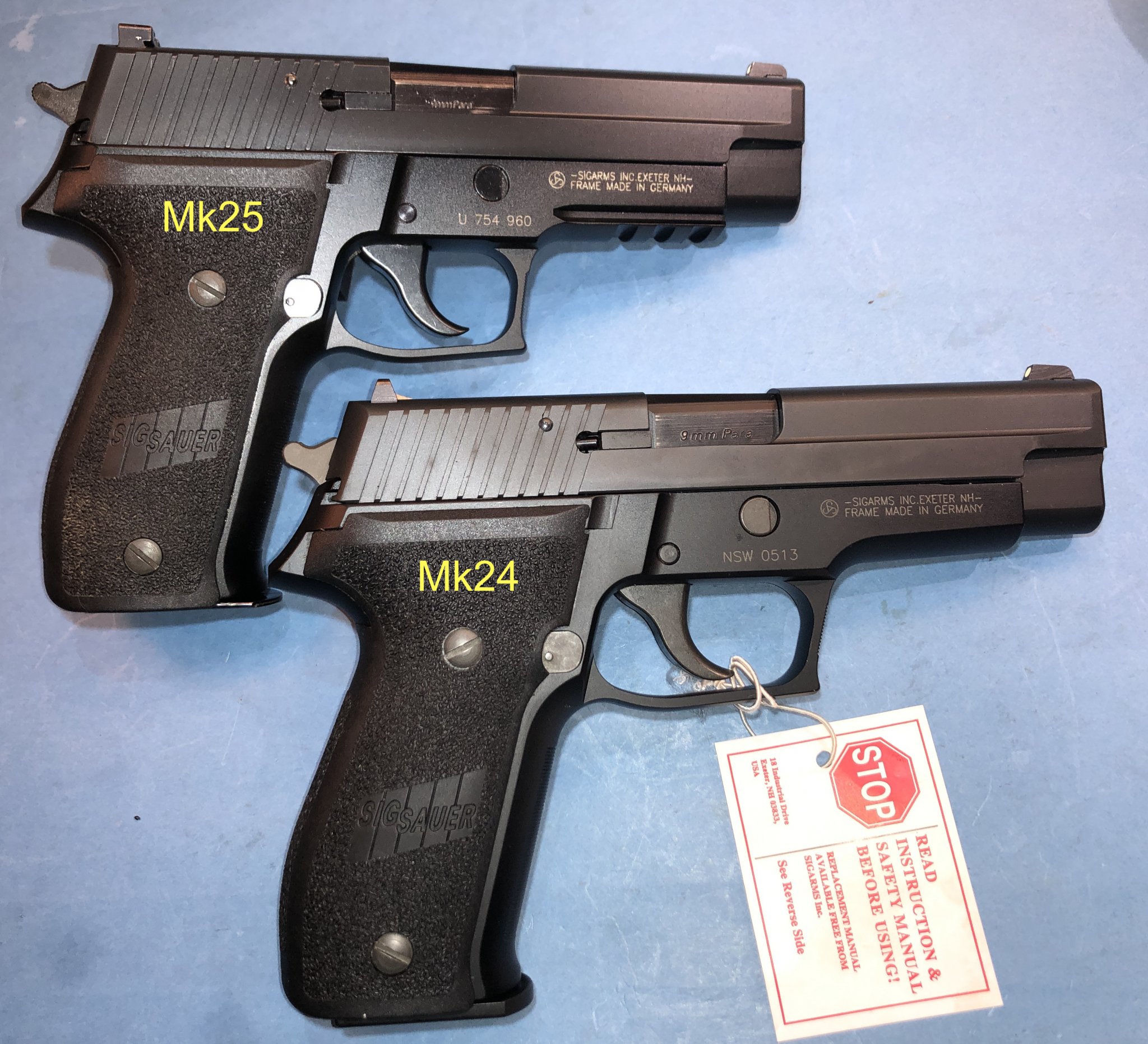

    I have these P226's, NSW (Mk24) and Navy (mk25), that actually came with a small tube of the TW25 Mil-Com designed for the stainless slides (not carbon steel).
    Those are pretty cool, I really like my 226 suppressed. Sig is offering the grease again apparently, I was looking on Brownells for the TW25, and saw a tube of grease with Sig branding on it.

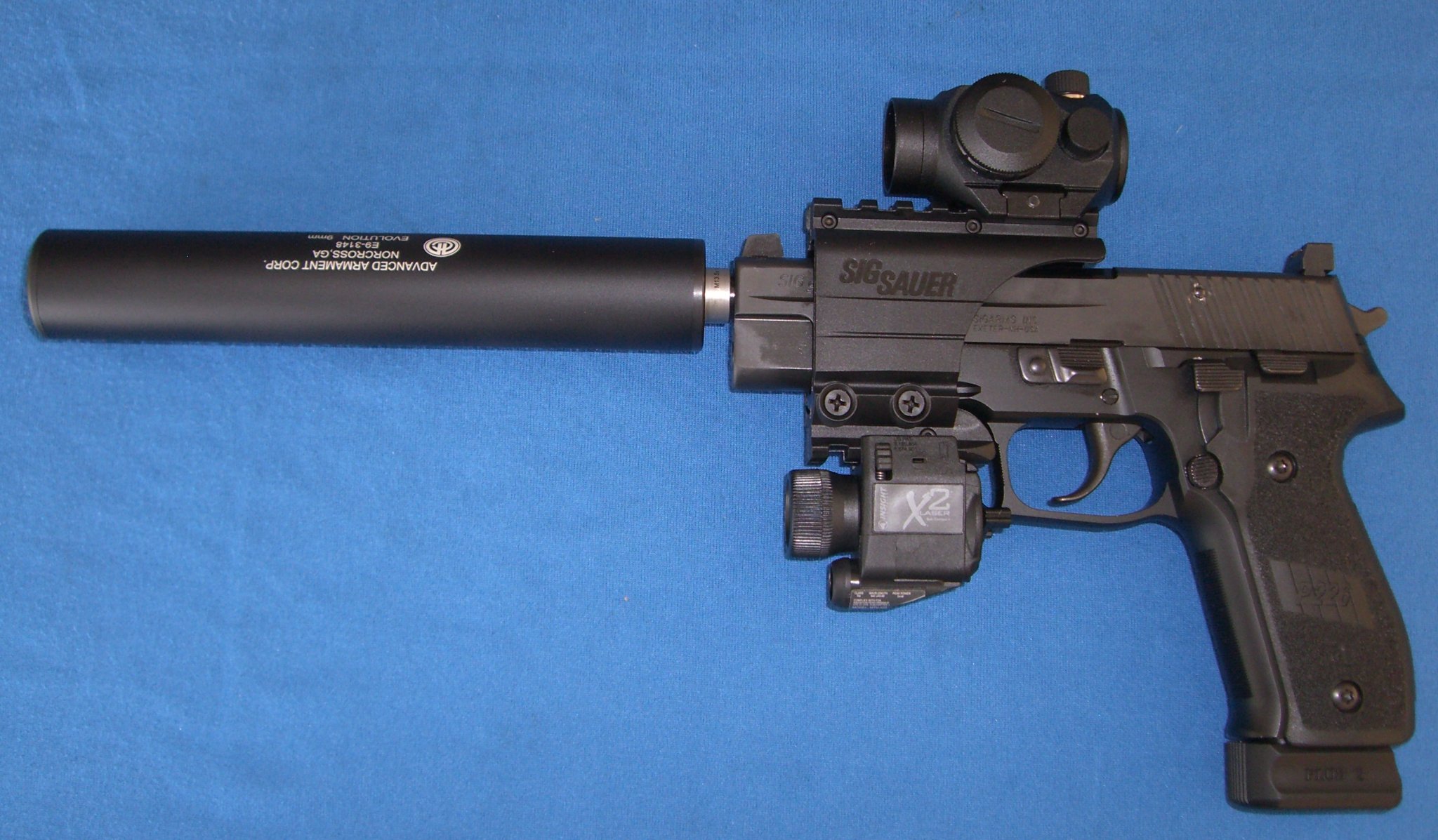

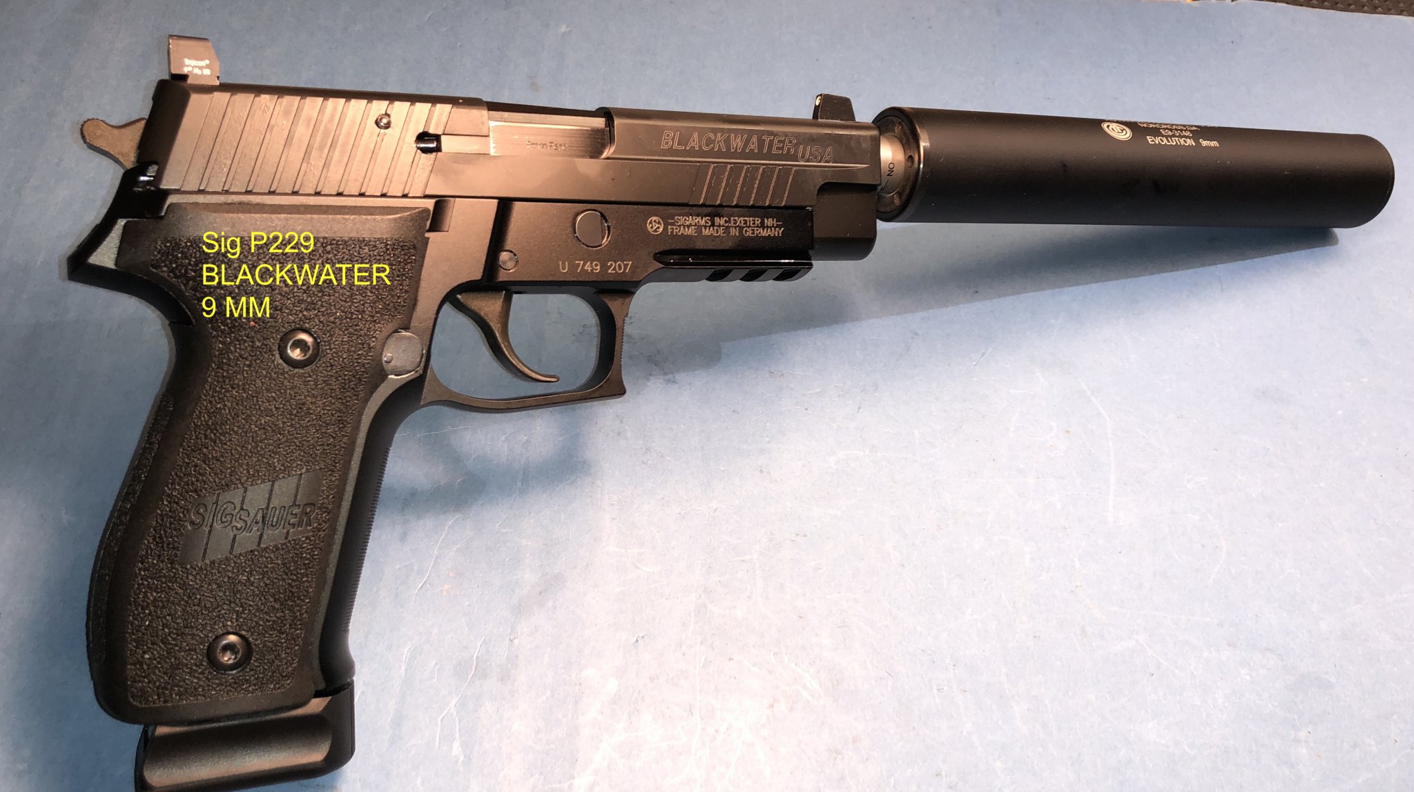

    I have this P226 BlackWater that has 5300 rounds down range. Gotta love the optic / light combination of the day.
    Of course no holster on earth could accommodate such a creature. Apparently didn't clean the muzzle blast debris before this photo.
