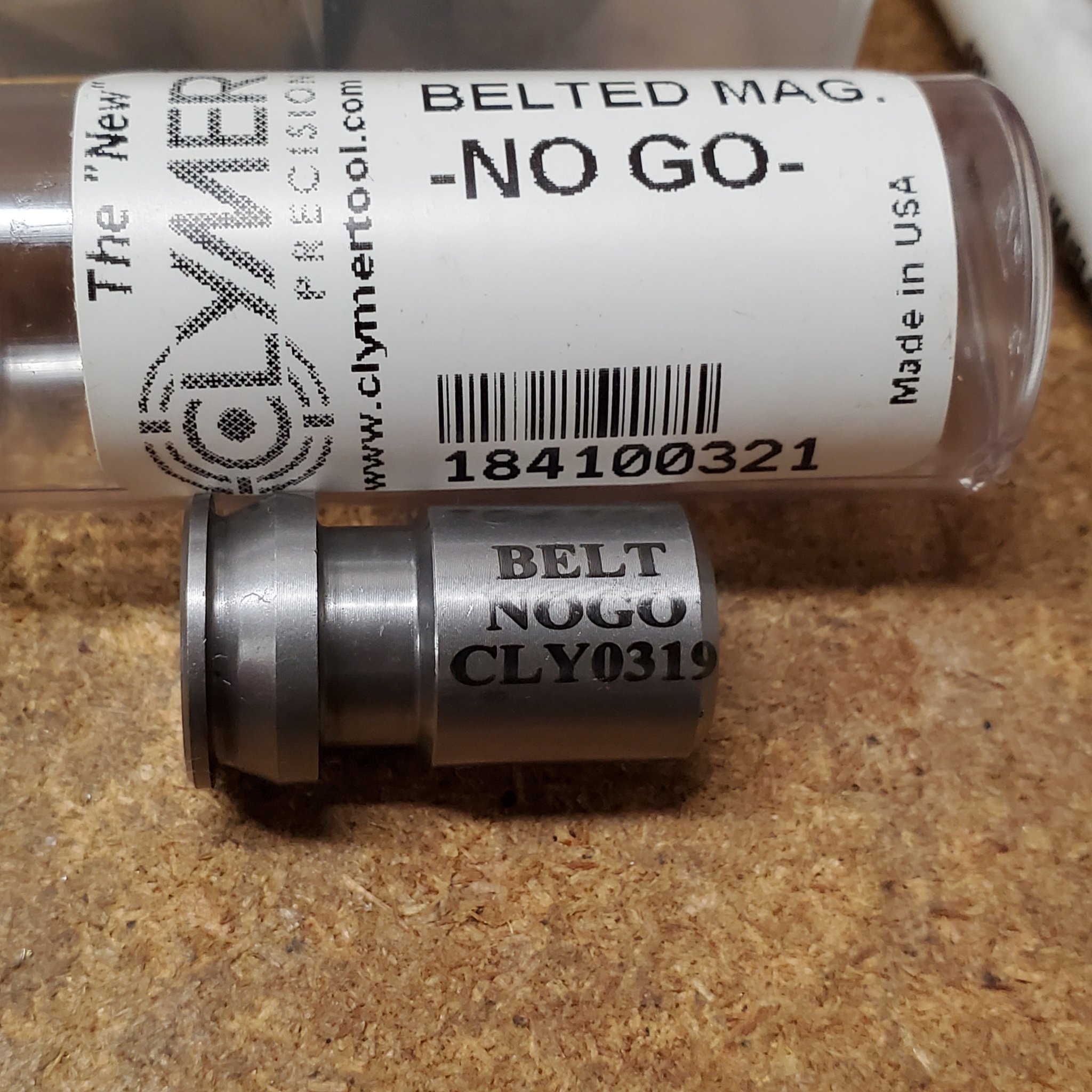

The belted mags headspace off the belt.
Here is a no - gauge for all belted magnums.
This is what your gunsmith sets the headspace with.
There is no shoulder datum.
The shoulder dimension is in the reamer.
And will have nothing to do with your first firing of virgin brass.

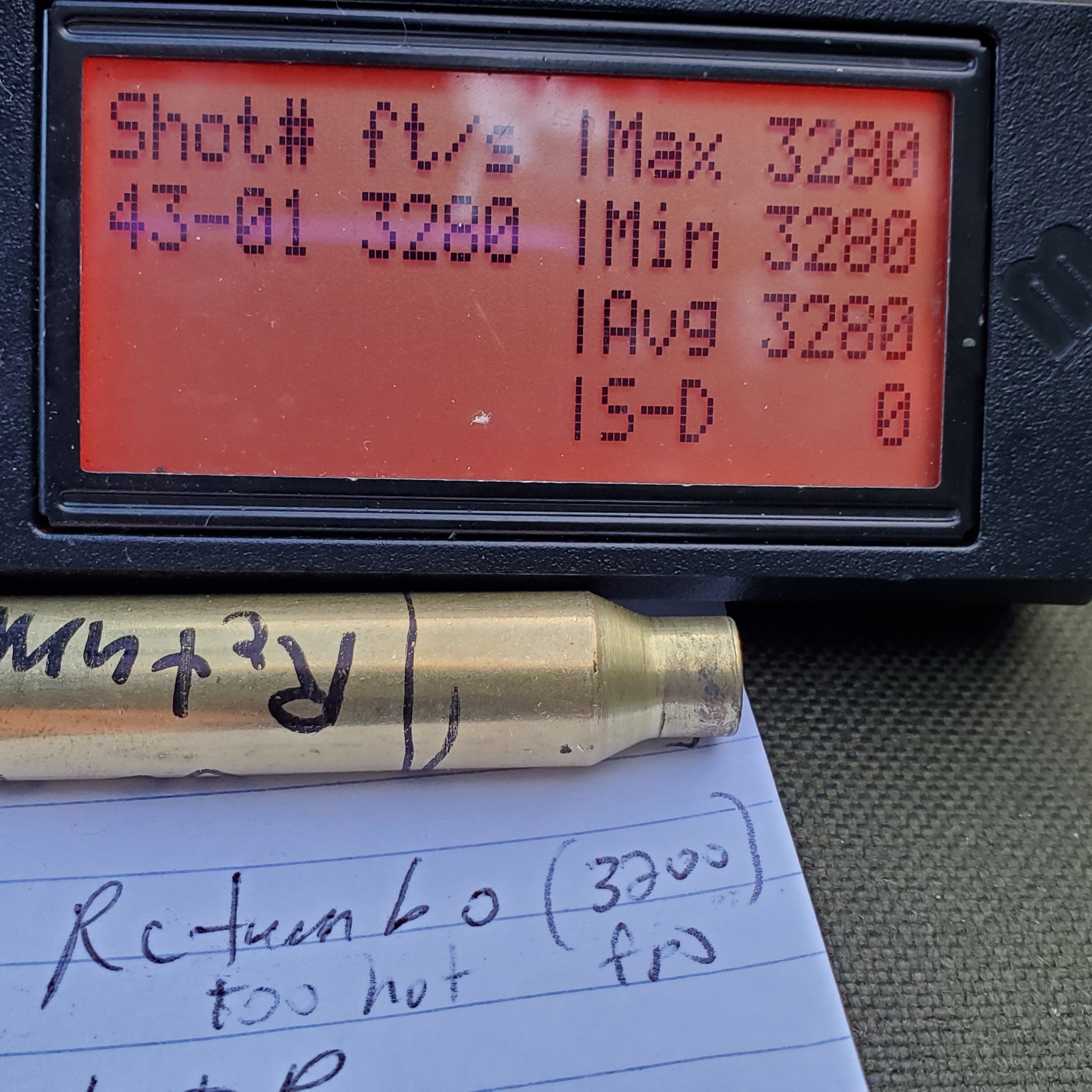

I ran my 300 WM 26" barrel to 3280 fps with a 200 gr SMK .715 BC...that was a bit hot but just over 3200 is fine, or the 230 gr SMK at 2962 fps.
The belted mags can be as accurate as other cartridges.
Added performance is taking them beyond 3.340" and going to 3.715" to 3.850" detachable mags in an aluminum chassis the easy button. If your into maximum performance. Add a slower powder and they hang with the modern beltless mags.

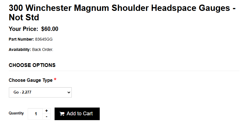

@45-90 ... you are technically correct based on the specification standards, but not in practice.
It isn't recent or new to get a shoulder headspace gage for a belted magnum in order to set a reference for the shoulder datum.
The 2.277 line has been used as an alternative to the belt.
Here is an example from PTG, but most of the outfits that make headspace gages will make you a shoulder headspace gage for a belted magnum if you ask.
It's "Not standard" ....
The whole commercial industry uses "standard gauges" that headspace off the belt....so there's that.
And a factory cartridge would not necessarily chamber in a standard SAAMI chamber reamer if you move the shoulder slightly, giving conflicting head spacing, between belt and shoulder, ...although new factory rds are pretty generous on setting the shoulder back so it doesn't interfere with the belt headspacing on first firing.
Using your method one would still have to make a slight sizing adjustment to the FL sizing die after firing, cause none if it's perfect...no big deal if you adjust the sizing die down .002" or. 005" after firing.
This is totally unnecessary, just use the industry standard set the headspace off the belt, fire one factory cartridge, adjust the FL sizing die to size the shoulder back .001" from fired position and your done...
Totally easy, totally standard.
Now you can chamber any factory cartridge made for that belted magnum and also reload for it, with no worries
But you can have "non standard" reamers and gauges made to your order, if ya want, any way you want, if the reamer maker will grind it.
Time is not on your side here, a long wait may be in order...."instock", has turned into a 5 month wait on a standard SAAMI 338 ARC finish reamer and go gauge....still waiting...they have been good in the past but customer service is falling off a cliff drastically.
Call and ya get the democrat political answer...

Improved 40° shoulders moved forward, blown out case bodies, oddball calibers, etc are all available but that too is "not standard."
Since this 7mm /300 WM is not standard, you can make it any way you want, no factory cartridges to contend with.
But you will be much happier headspacing off the belt, as not all brass thickness is the same, spring back, your new expensive FL dies that don't quite fit properly, hard bolt close, etc. it will be less troublesome to headspace off the belt...slightly more adjustability in sizing will prove to be invaluable...if needed, and your headspace will always be correct...just adjust die to that particular brand of brass for your determined shoulder bump...easy.
But it ain't mine... but a suggestion on how I actually do mine. Do it your way, it's your rifle.

The 300WM 26" barrel is still pretty good the 3280 fps with a 200 gr SMK .715 g1, it was a hot load and marked as predicted max, but 3200 fps is doable, or 230 gr SMK at 2950 fps. Just playing with the 300WM before turning the reciever into a .510 whisper.
