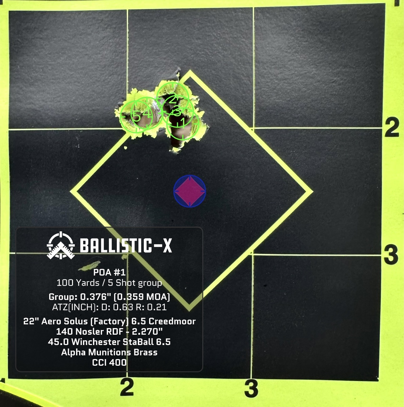

I have a Tikka t3x (soon to be listed in the PX) in a KRG whiskey chassis. its always shot around .5 moa with 5 shot groups. some above some below. I handload and its very accurate. the tikka rifles seem to be a little slower than other rifles with similar barrel lengths. You can throw in a $20 spring and have an excellent trigger, and their aftermarket support is growning. Another guy i shoot with gets the exact accuracy as i do,... lol with the same load.

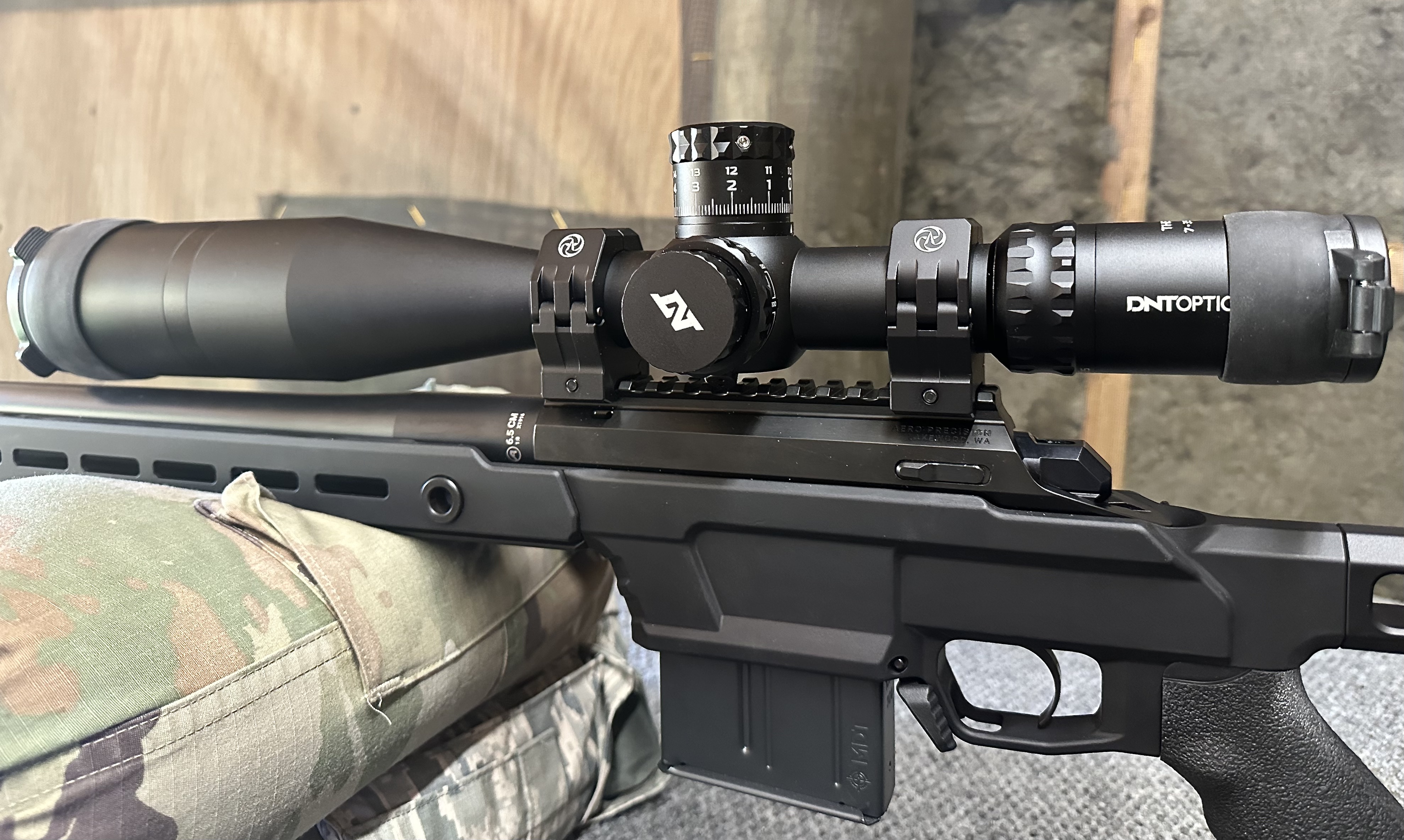

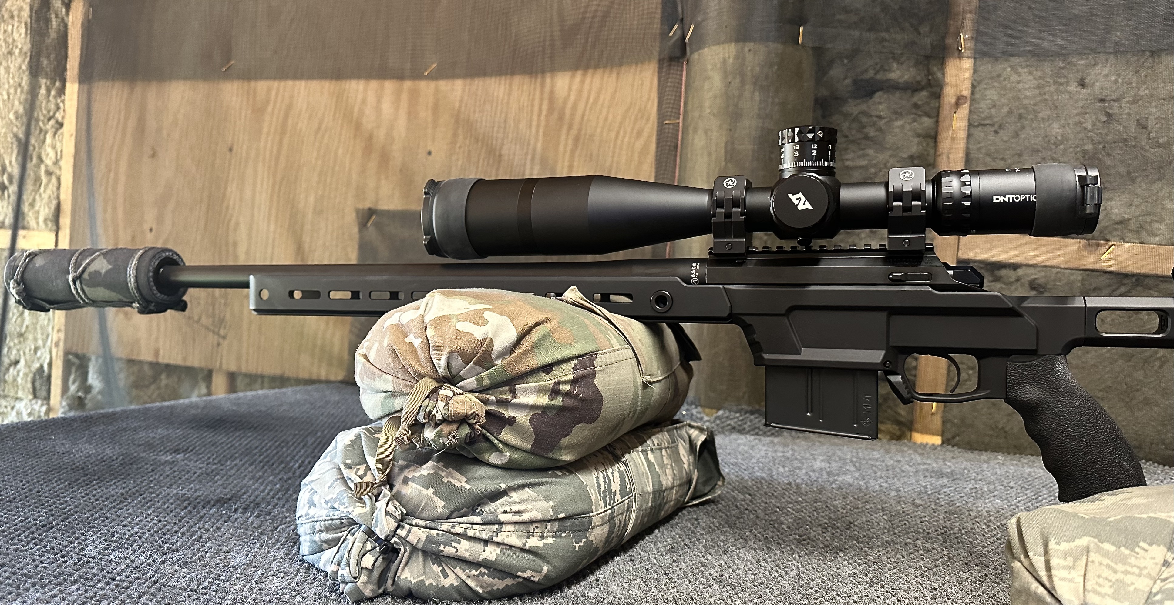

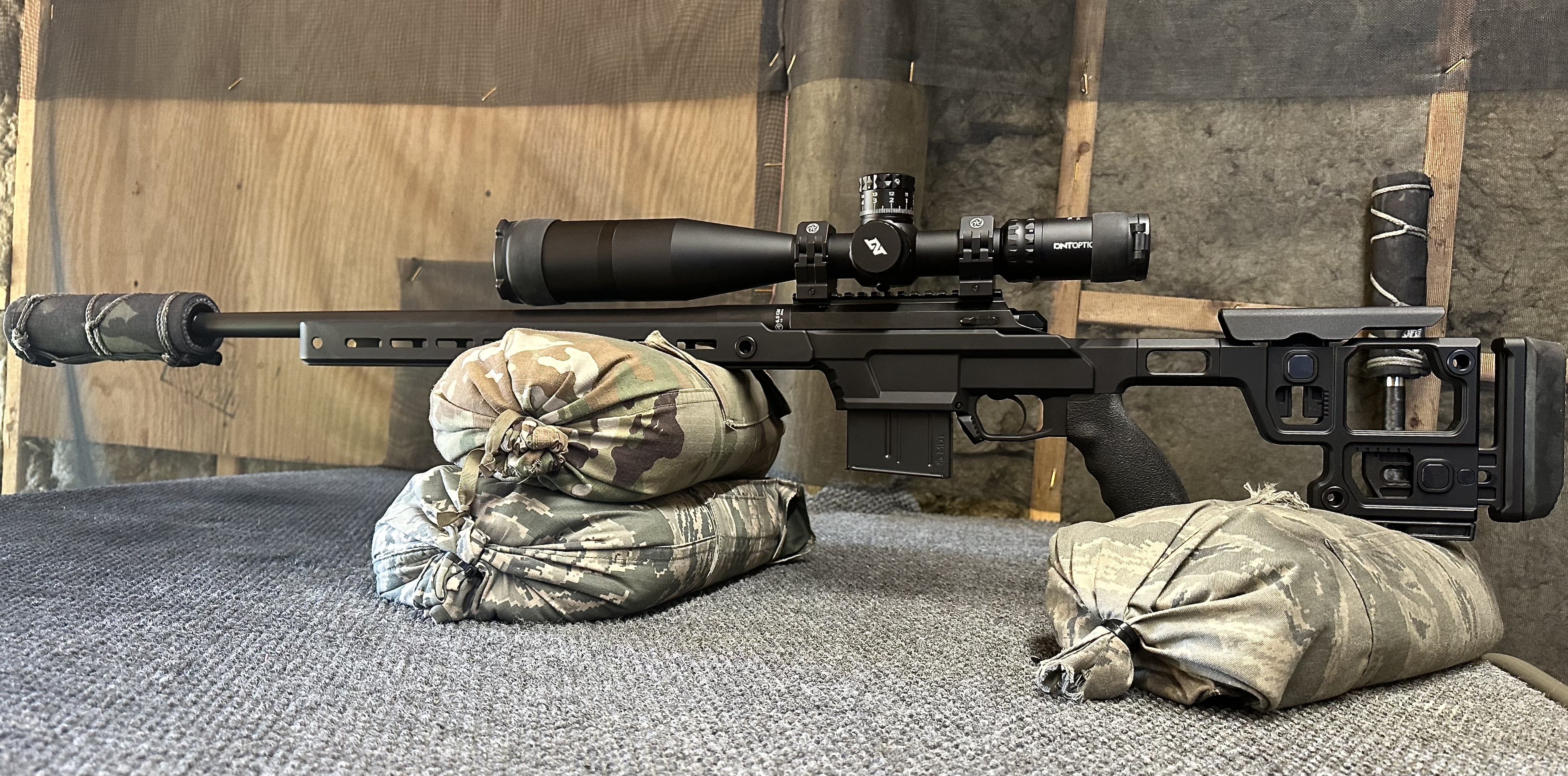

So, here's my update. I ended up getting a used Tikka T3X CTR in an MDT XRS. I have an Arken EP5 ready to mount. Looking for a 419 Hellfire Match and a bipod that won't break the bank...maybe the MDT GRD-POD?
