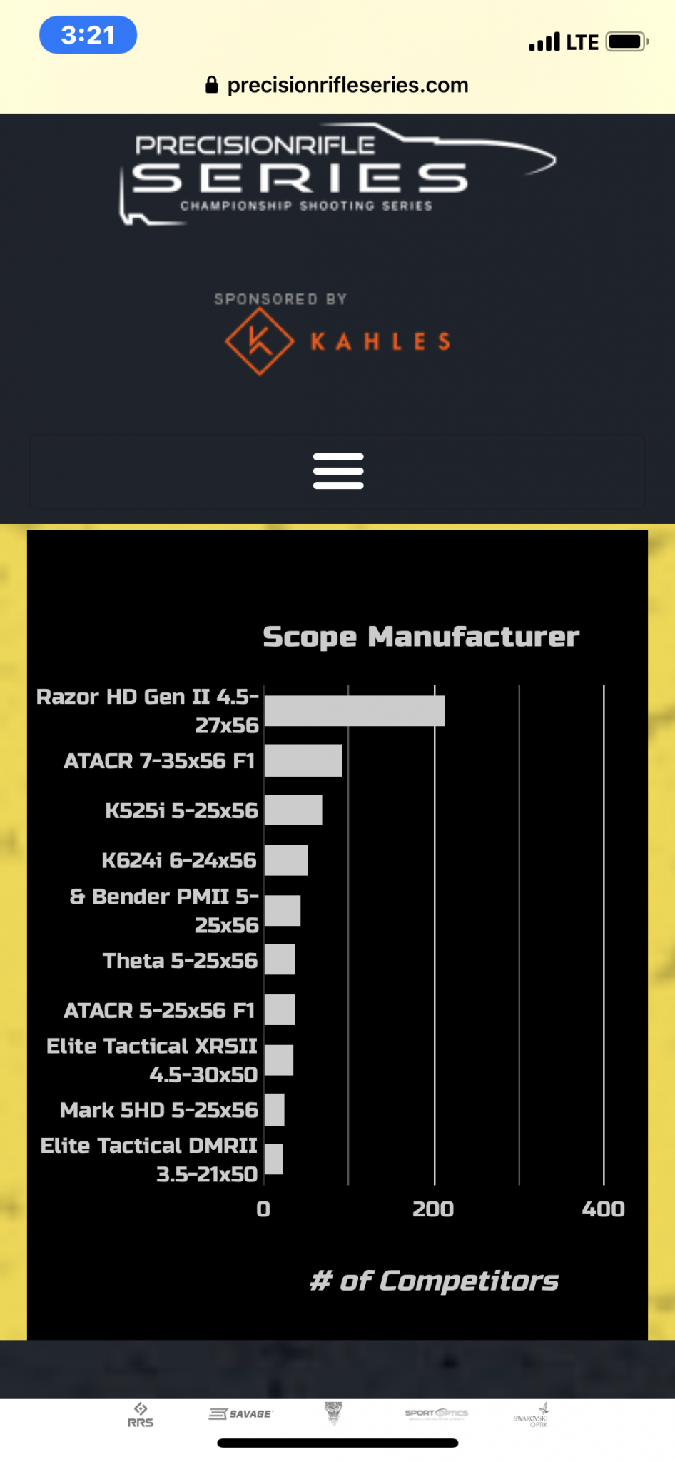

For the first time ever, I have to purchase a scope for the purposes of competing in PRS/NRL matches. I have no interest in hunting with it. I read some articles on precision rifle blog and shaped a few
I have decided that first focal plane is a must have and that I will jump on the mils bandwagon. Zero stop is a must have. I am considering a Horus reticle though question if it is hard to spot impacts with all of those grid lines in the way. Any reason I should reconsider those choices?
Here is what I am considering.
1. The Vortex Razor looks like a good option.
2. Nightforce ATACR
3. US Optics B-25
What are your experiences with these scopes for this type of application?
Thanks,
-Trevor
2019 scope stats for PRS.
