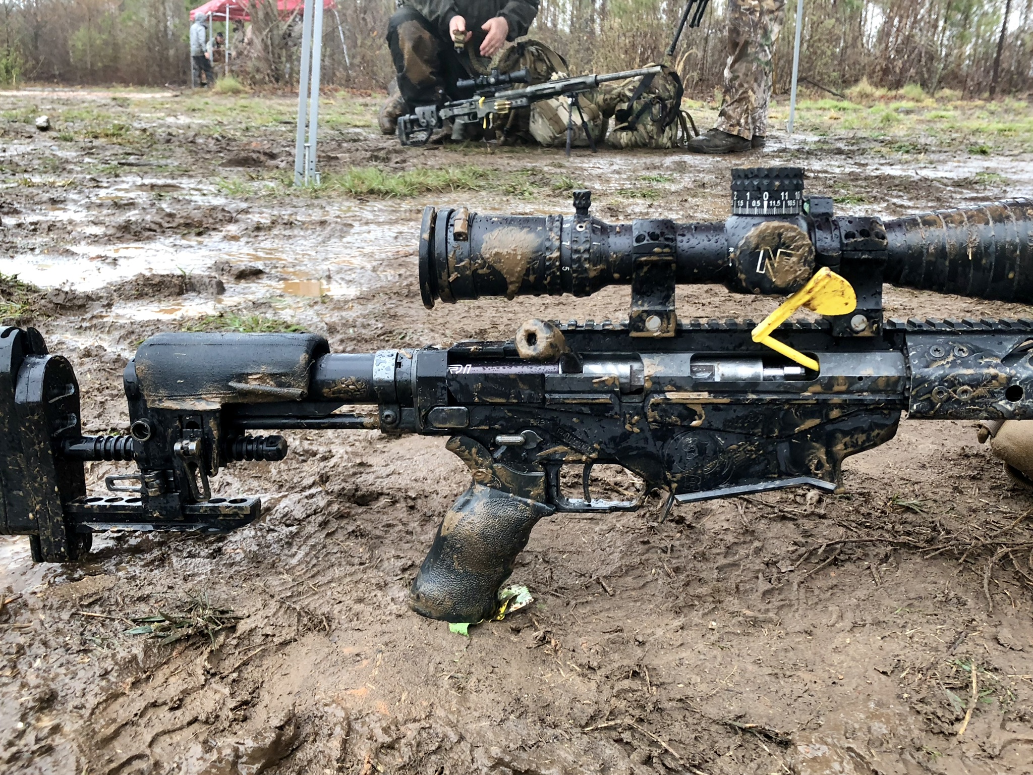

I have a pretty heavily modded 308 RPR with maybe 1500rds through it, shooting partner has maybe the same amount through a 6.5 Creed. I’d recommend a different rifle, (T3x) unless you want an inexpensive folder.
1) Finish is poor, prone to rust. Strip it down and paint it.
2) Factory stock is poor quality, both of us swapped for XLR stocks after about 1k rds.
3) The Gen 2 handguard is flimsy, mine was off center, you’ll probably end up swapping it.
4) Pull the scope base off and locktite the screws and retorque, lots of reports of them loosening.
5) Heavy.
The good?
They shoot very well, and as an inexpensive compact package (I chopped my barrel) they can’t be beat.
After the above mods I’m happy with mine, it’s a damn good beater rifle.
Even when caked with mud, it never fails to feed, extract, or eject.
