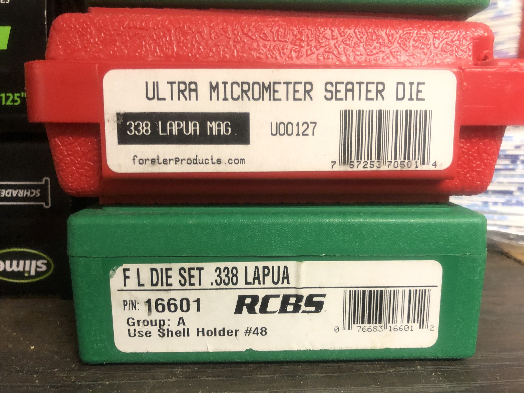

FWIW, I’m simply using a set of mismatched RCBS and Forster dies with my .338 and have had nothing but success.
I use RCBS fl bushing die with a standard RCBS seater and Redding competition shell holder kit.

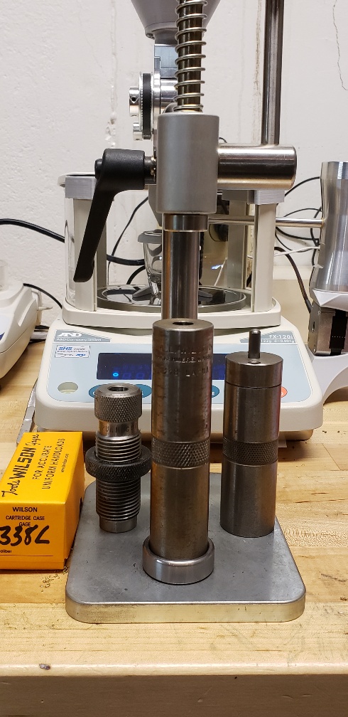

My setup: Redding body die (used in a single stage press), Wilson neck sizing die, Wilson bullet seating die with a micrometer seater & VLD stem (not shown). Using Lapua brass, 215 GMM primer, H1000 & Berger 300 hybrid.
