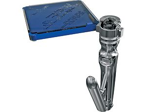

- Forster Co-ax Now, don’t wait. If you are shooting 500 rounds per month, go with the co-ax. Only problem is that you may not realize how awesome it is unless you start with the boss first. . . Also, if you get the co-as you can ditch the primer tool because the co-ax has an outstanding primer seating feature.

I'm still on the fence about the co-ax, I've gotten a lot of good recommendations for it, but man is it pricey.

The co-ax is awesome but Im not sure its waiting months on end for one. Most any press can give results just as good, I like the co-ax for the spent primer collection, no messy pick up all over the floor. It is a nice press.
Priming on any press sucks IMO, having to single load the little bitty primers. Do yourself a favor and get a franklin armory hard primer for 50 bucks.
