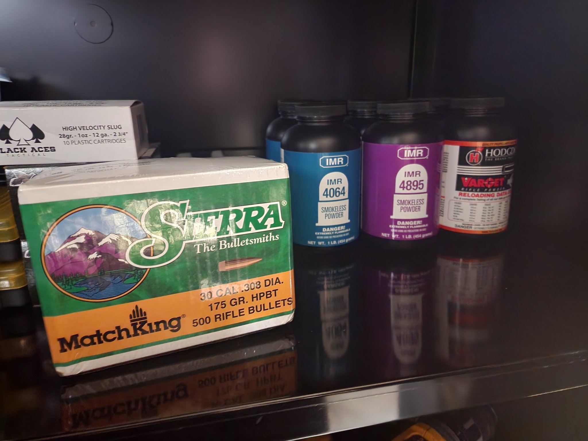

Hello all,
Pictures attached with what I have currently.
I'm a 308 shooter with about 500 pieces of once fired FGMM ammo all through my rig. Have a box of 500 Sierra 175 gr hpbt, 1000 cci large rifle primers, 2 lbs Varget, 2 lbs IMR 4064, 2lbs IMR 4985.
Rig is Remington 700 sps aac in a m24 stock, bushnell ERS 3.5-21x, harris bipod, hawkins DBM, a brake (forgot which)
Rcbs ammomaster 2 (plan to reload 375 CT someday soon)
Frankfort arsenal-
Powder dispenser
check weights for scale above
Hand deprimer
perfect primer
digital dial caliper
Aluminum powder funnel set
Bullet puller
Lyman-
Reloading block
Ultrasonic cleaner
Flash hole tool
Case prep tool
Rcbs case prep pad
Imperial wax
One shot case lube
Comparator for 308 the D size
Hornady custom 308 dies
I haven't reloaded any ammo yet and want to get going. The instructions for my Dies say I need to take them apart and clean the anti rust stuff before first use. I Do not have a case trimmer yet however the Frankfort one to use with my drill will be here soon. I mounted my press onto my reloading table since I took the picture of equipment. Also I am looking for a stone slab to put under my powder dispenser with some cork pads to help with vibration.
So what is next?
Kind of nervous because I didn't buy a typical box starter kit and feel like I missed a few things. Appreciate any help from the community
I typically shoot 50-120 rounds at a time when I go to the range. I like shooting the steel targets at my local club from 200-500m with plans to go farther soon.
Plan to do a load workup for my rifle
haven't bought any reloading books yet, not sure if the PDFs are online

With the 175 SMK and those powders, if you can't get the rifle to shoot well, you've got a problem.
When you said "micrometer", did you mean dial caliper?
When I got started, I relied heavily on the Speer reloading manual. However, the instructions on your dies will get you where you need to be safely. Take your time and double check everything.
Hodgdon's reloading data on their website will cover all three powders you have...no need to worry.
I'm guessing 41.6 - 42.0gr IMR-4064, or 42.6 - 43.2gr Varget is going to be your sweet spot at 2.800 COL.

Yes sir I meant dial caliper.
I'll head over to their website and see where to start the load workup.

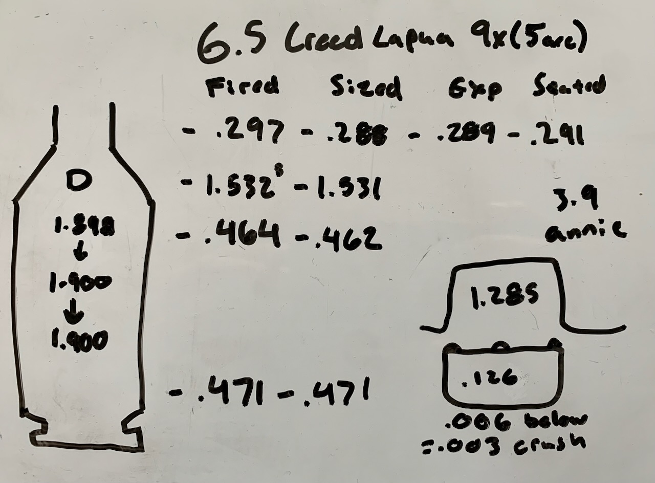

You are just missing a trimmer, you don’t need a stone slab
Take notes and measure everything for each step of the process in a way that makes sense to you and you’ll have a much easier time when something does go awry
This☝️
I’m new to reloading myself and it can be daunting in the beginning. In my limited experience, keeping notes I can easily understand has been a big help. I also write everything down. You’ll think something is burned into your brain only to not remember it exactly because the next thing has pushed it aside.
I take my time and try to limit distractions to zero or close to it. I’m starting to develop a process that works well and has helped to shave off some time.
Lots of good info and plenty of knowledgeable people on the hide willing to help.
