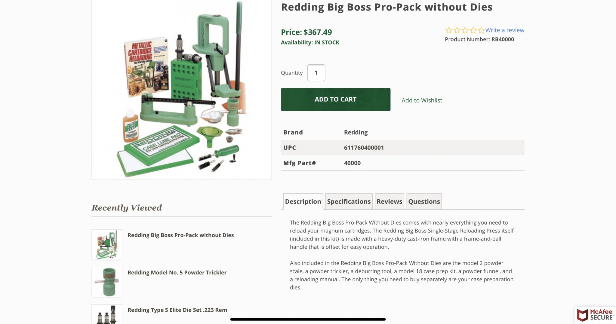

I have all Redding equipment. The die set, trim set for .223, 30.06 and .308.
Yeah Redding has many die sets for each caliber. Full length, bushing (full length and neck only), body does, seating dies, basic, competition, matchmaster. Dies and a trimmer are two very small pieces to the pie. Did you buy some kind of Redding reloading kit or just Dies and a trimmer?
Look in the Hide Reloading section and review some of the sticky treads on reloading process. I love my reloading setup but it can be a rabbit hole with no end! If you have not already got in too deep it may help you decide which way to go.

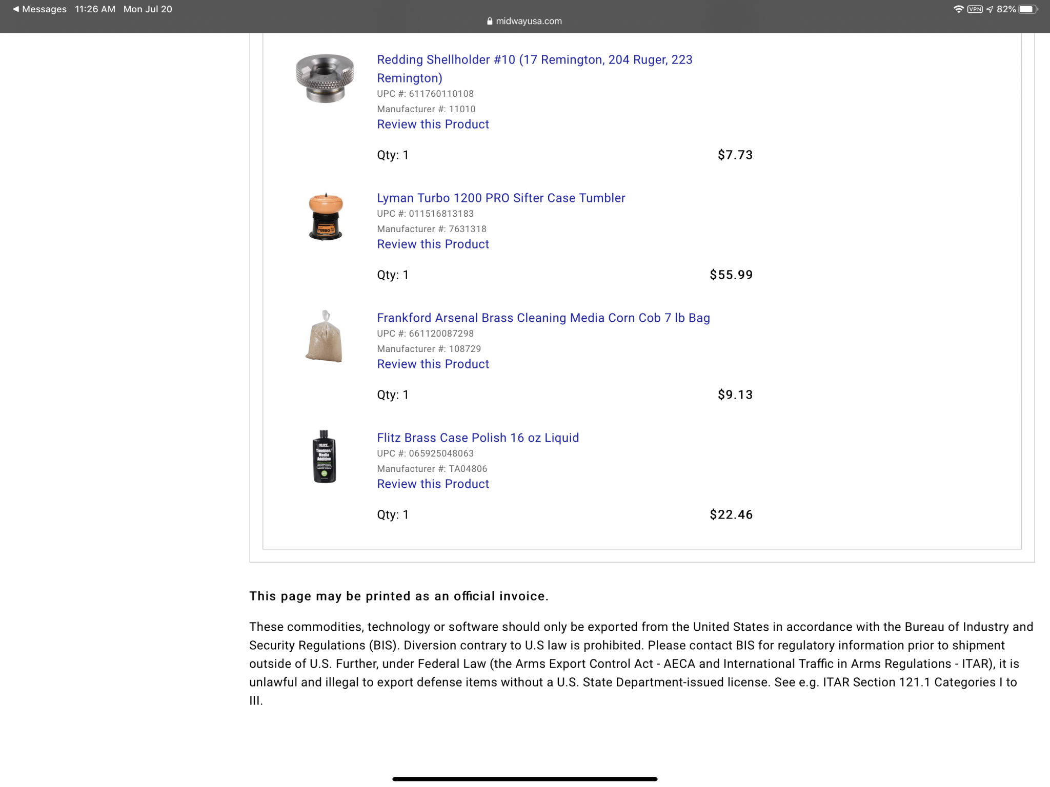

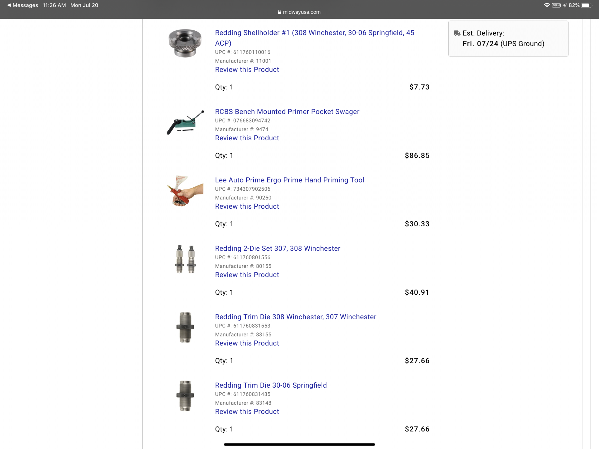

This is what I have so far. I also got the shell holder extender to use with trim die and also picked up the .223 and 30.06 die sets to match this as well.

Personally, I would buy an actually trimmer, or something like a Trim-it 2 with different caliber conversions. I would imagine filing down all those cases on that trim die is gonna get old real quick.
