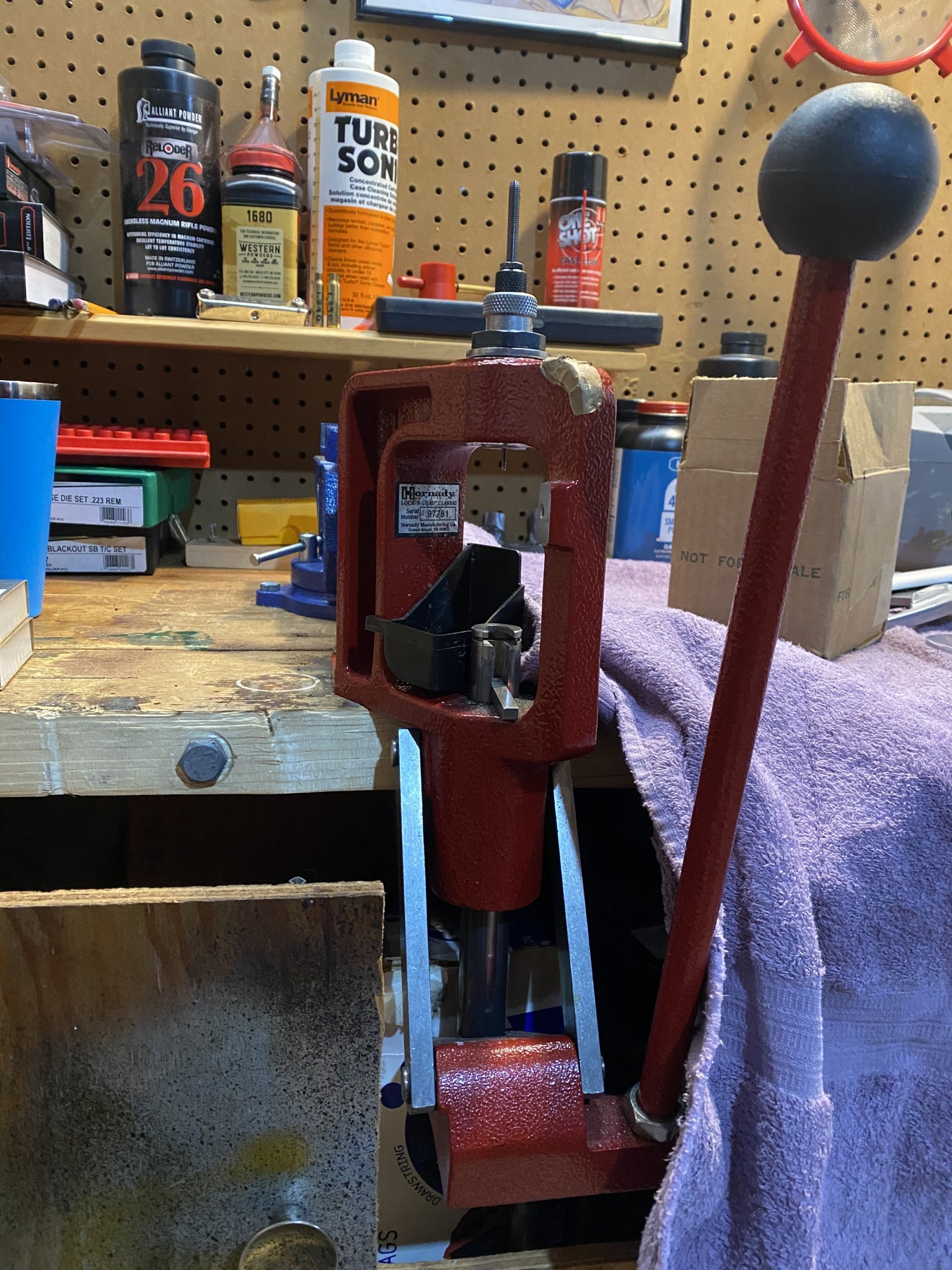

If your going to load for 2 or 3 calibers get you a redding T-7, love mine and you can buy extra tool heads as you go.
A good set of scales is a must.
You can prime with a hand primer,no big deal
And some good dies, I use Forster.
I used to use a single stage press but got tired of setting up different dies all the time.
