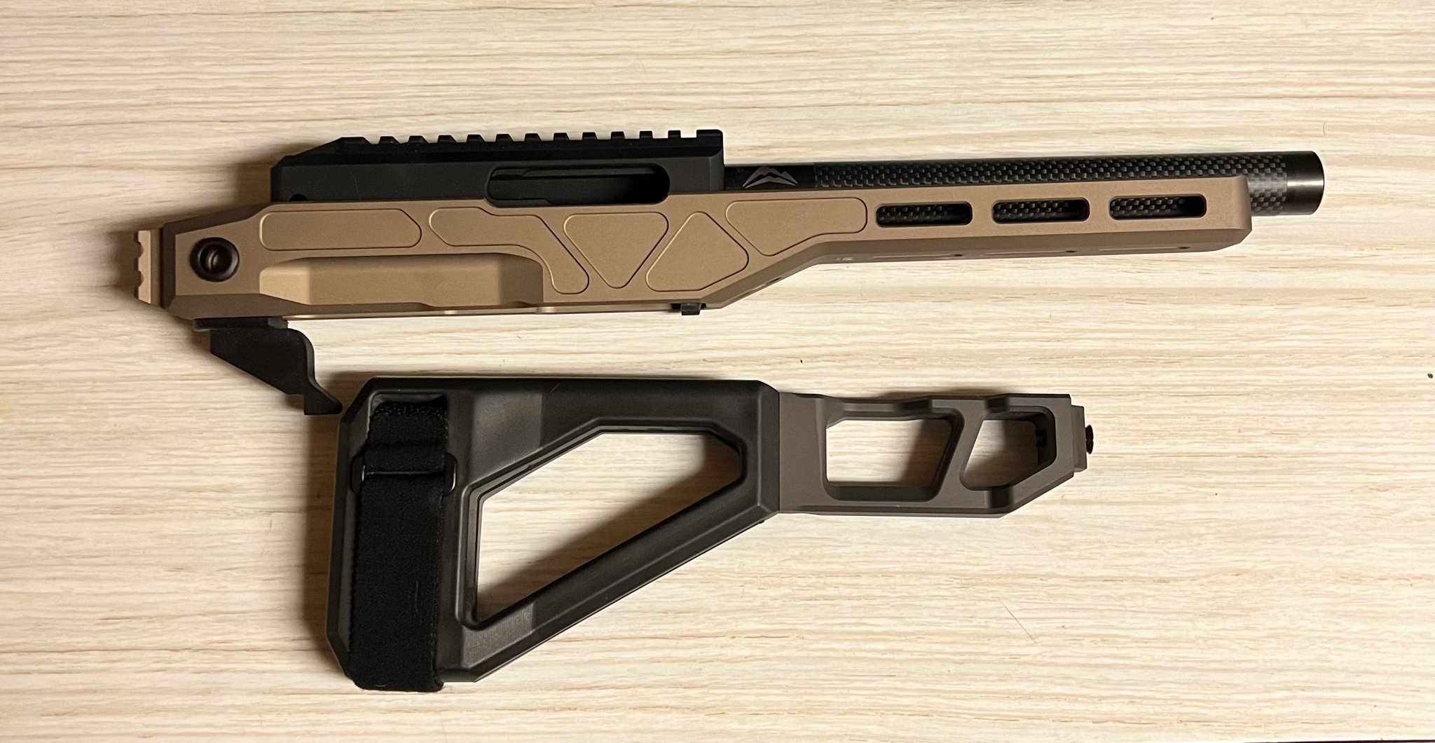

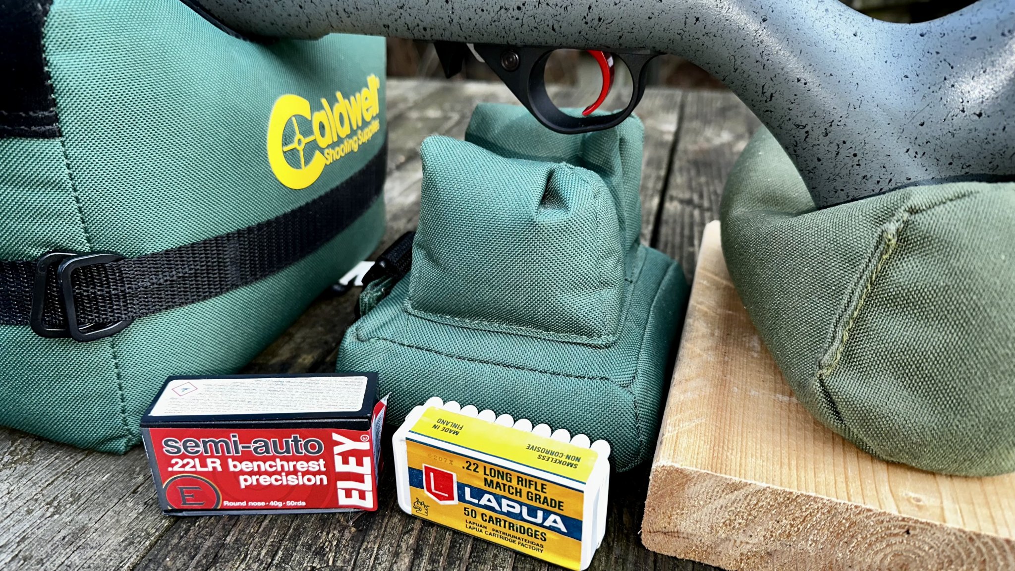

I just put a Kidd 8oz trigger on my 10/22 Custom Shop.
I shot a few matches next to a guy with a Kidd and came in second to him.
As I fed my 52D single shot, he pulled off round after round almost effortlessly with that trigger.
-Richard

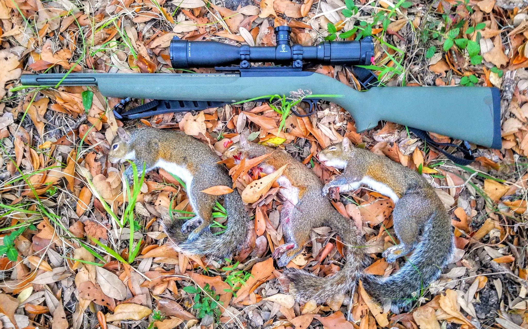

Another plus 1 for Kidd trigger. I prefer single stage for hunting.
Barrel is a 16" Tactical Solutions’ X-RING. Some 10 shot groups at 50 yards with a 6X scope. I'm not a great shot, but good enough for small game.

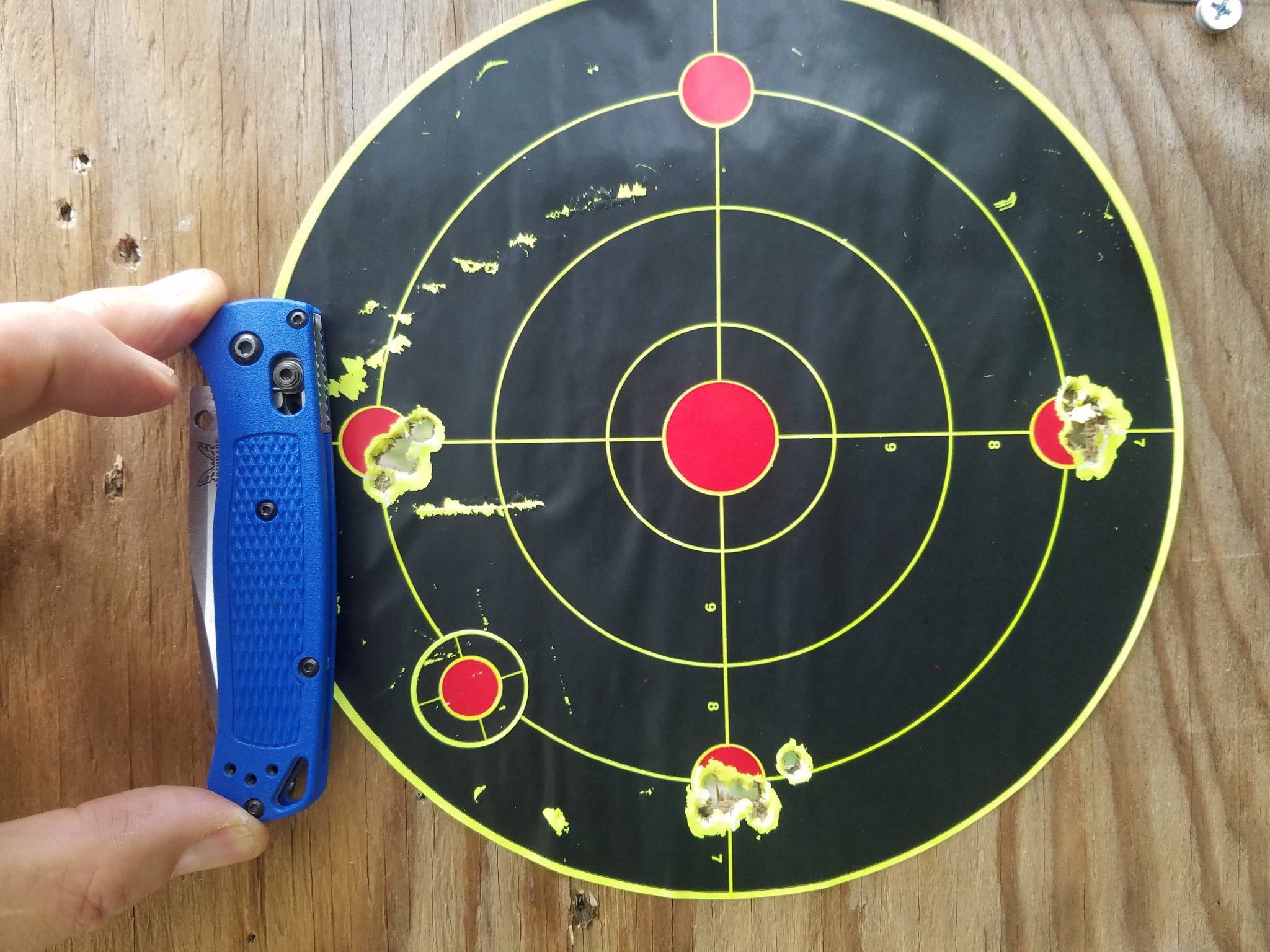

Mines all cheap parts and can shoots 1/2-3/4" groups at 50 and shot a .142 at 25 all with cheap with bulk ammo. Need to see what match would do. Cycles subs too and shoots them well.
Green mountain 20" bull barrel, factory bolt(polished), cleaned the over spray out of receiver, and the trigger is half home job half store bought.
It's also 13.3 pounds now

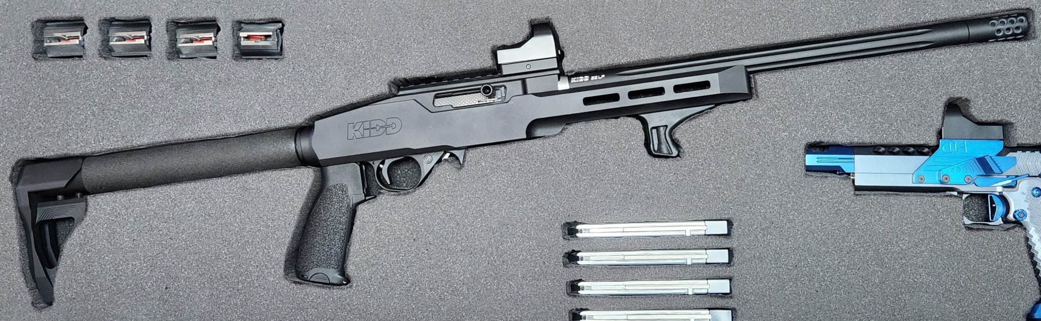

DrDeath, if you don't mind spending the money, just go all KIDD, here is my build list for my steel challenge rifle: KIDD Supergrade Barreled Action / KIDD Tactical Chassis / C-More RTS2R w/Mount / Phase 5 Universal Mini Stock / Phase 5 A2 Extention Tube / Phase 5 Buffer Tube Foam Pad / Bravo Company Gunfighter Pistol Grip / Bravo Company Gunfighter KAG Hand Stop
Th KIDD chassis is really well made, just need to add your stock of choice.
If you want a more traditional rifle, I have the same thing in a KRG chassis which is my hunting set up.
It is light, fast, and awesome!

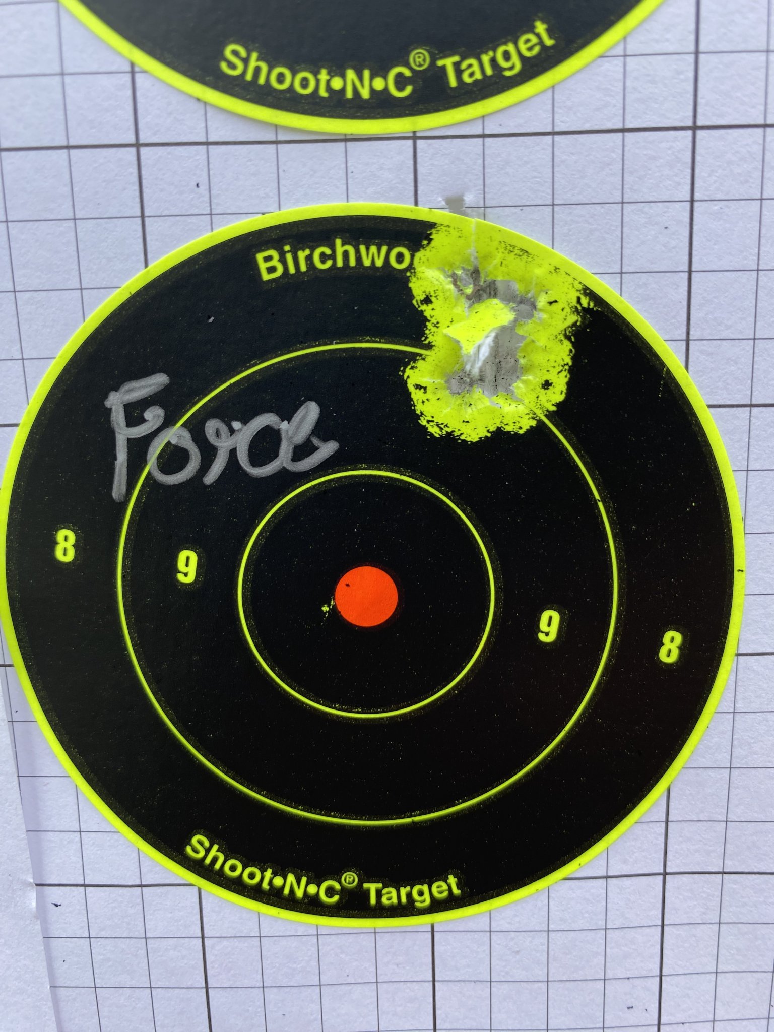

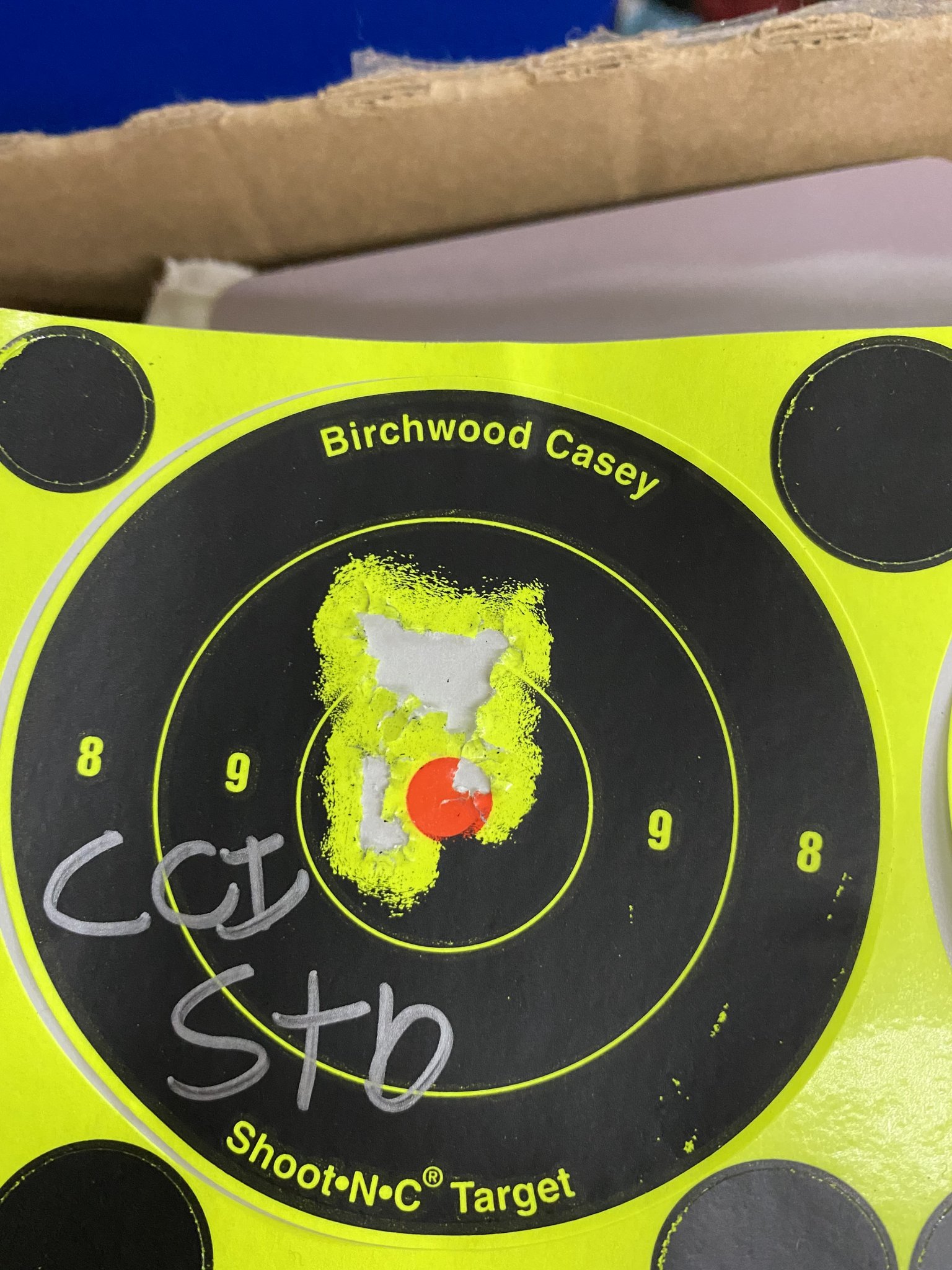

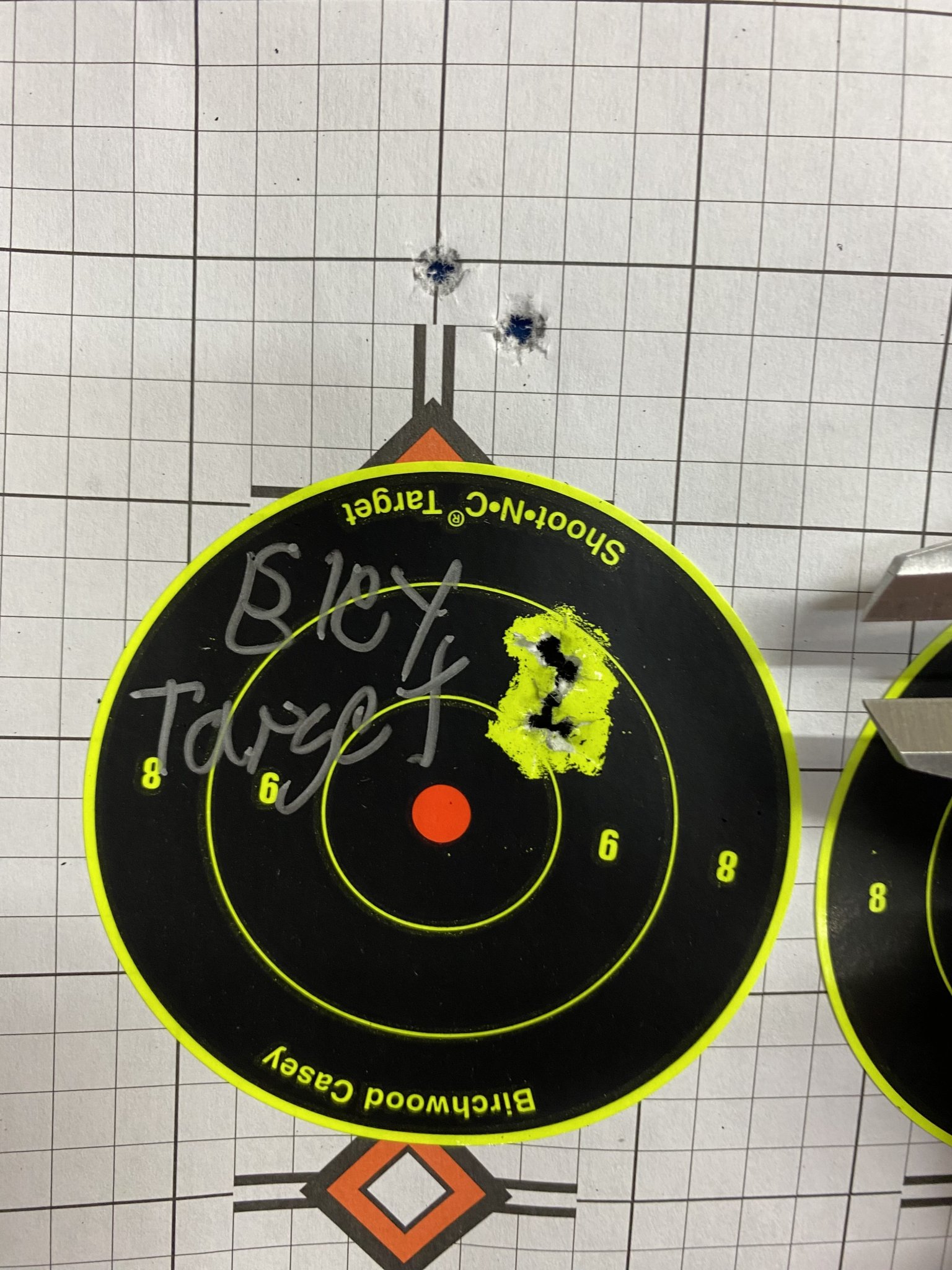

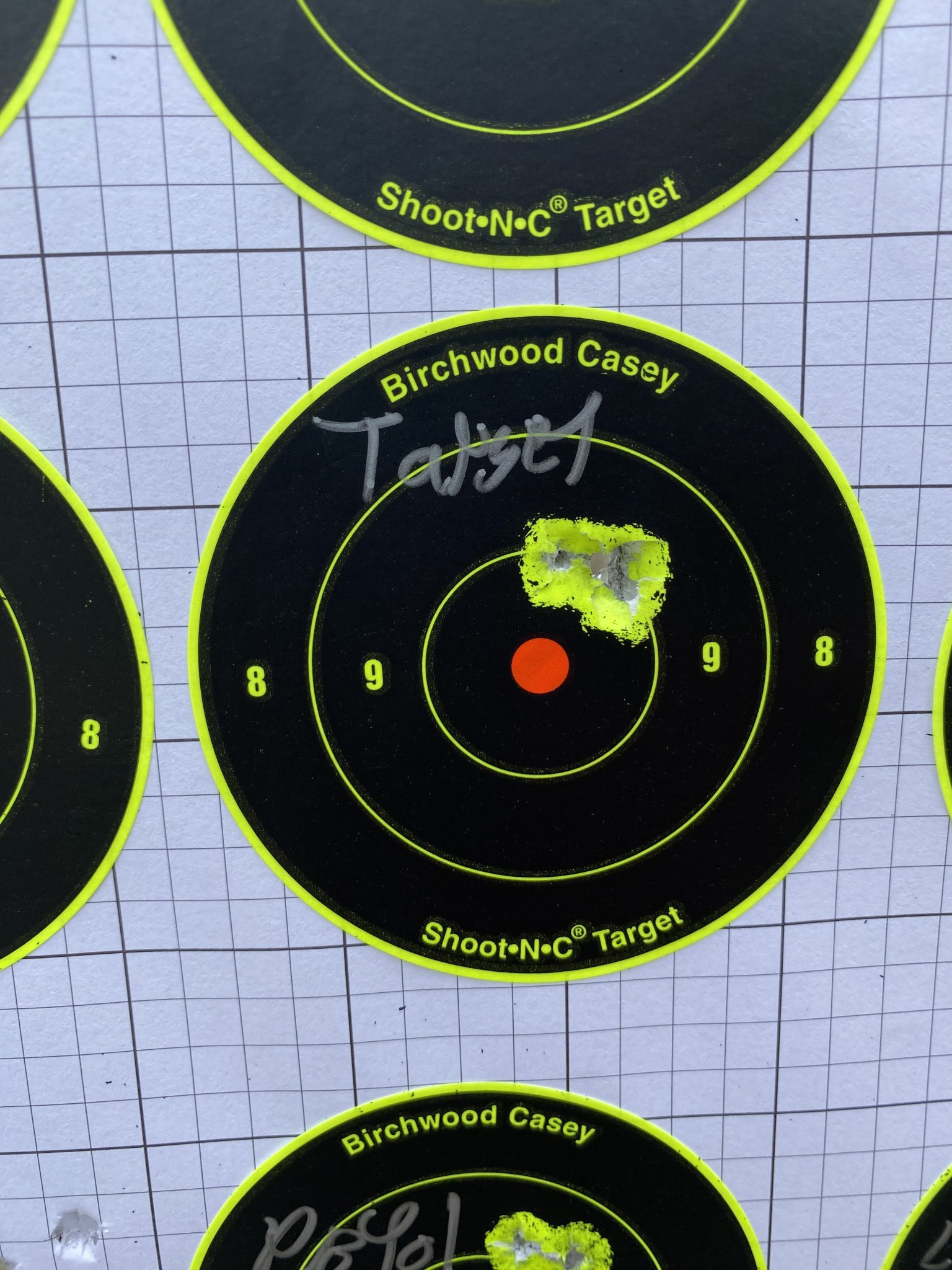

Results from my CPC tuned bone stock target model, the trigger is great too. 5 shots 50yrds Eley target and Force, no cherry picking groups and that’s the cheapest of the Eley stuff too. And a 10 shot 50yrd group of CCI standard. The barrel isn’t even close to being broken in either. Even Aguila super extra shoots about a 1/2”-5/8”with the cheap ammo typical flyer. The gun never jams and is very very smooth now as well. Oh yay 3-week turnaround.
