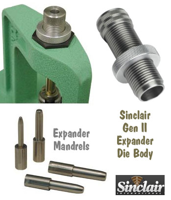

When you write about expanding mandrels, are those Wilson? Sinclair? or the mandrel button that is pulled out of a case neck after the bushing die sizes it? Or the mandrel in a Lee collet die?

When people mention mandrels they are talking about a separate mandrel. They remove the expander ball on the thing rod from inside the die and then in a new die and a second step they use the expander mandrel and die body. Forcing brass up around the solid mandrel provides for better results than pulling a ball through the neck and stretching the cases.
Sinclair, PMA and 21st century all have die bodies and mandrels that are interchangeable with one another.
SO yeah, bushings can give different outcomes, that depends on your brass condition and how easily it accepts the new dimensions more so than the bushing label. It usually wont be multiple thousandths off. My .289 bushing give me a .290 neck in reality. What you need to decide is if you want to use the bushing only or if you want to expand as well. If you want to expand then you need to get a bushing a couple thou smaller so that the mandrel actually has brass small enough to touch in a meaningful way. If the bushing closes it down to a diameter thats larger than the mandrel then the mandrel obviously wont do anything as its floating freely in space.
So the Lee Collet Die has a pushed expander mandrel like that (as opposed to the pulled ball/button). The difference is Lee only offers one size mandrel and the die also has the collet fingers which could be removed. The collet itself is kind of like an OD bushing, but it's spring-loaded against the mandrel and it has a few gaps. Lee advises turning the case on the shellholder and pushing it up into the collet a second time presumably to improve the roundness of the result which might otherwise look a little like the four lobes of the collet.

The collet die is a different thing altogether but people report great results because just like with the separate mandrel because you arent tugging on the pliable brass, it has more compressive strength than tensile. But the mandrel and lee die both are only part of the neck sizing operation, it leaves the whole shoulder and body untouched still.
Youll find what works for you quickly enough, I wouldnt sweat any of the choices.
