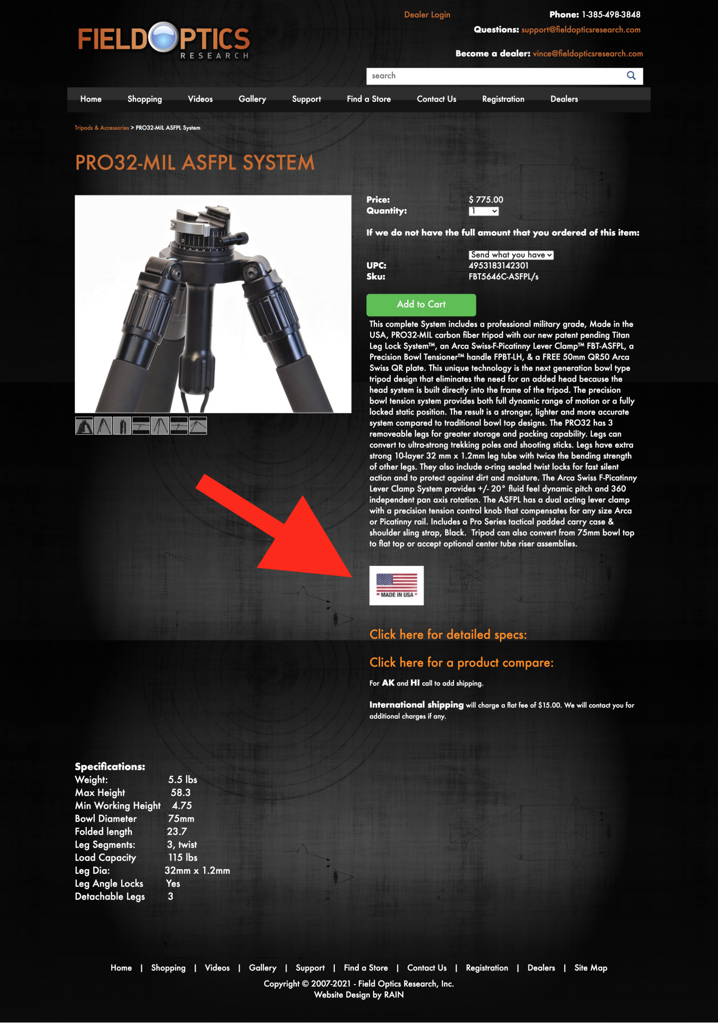

You might have been looking at the imported and cheaper FOR tripods. The pro32 and pro39 are USA made (edit: not sure, see below a ways) and have some features RRS doesn’t have:
  • Leg spread locks. This means you can move the tripod without the legs fold it in, and carry it locked so the leg doesn’t open. Locking legs should be more rigid.
  • Integrated panning base on their Arca clamp ASFPL. Btw, this clamp has an integrated pic clamp like the RRS TA-LBSC. I think this comes into its own if you use a spotter on the same tripod as your shoot from. Don’t want a panner? FOR sells a non-panning model leveling head as well.
  • You can’t get the same clamp for your RRS; if you stay with all RRS stuff you’re either going to going to lose the panning feature or the pic rail clamping ability.
  • To get the pic rail clamp on the RRS, first you buy the TA-3 (I spoke to RRS about this, btw). Then you take off the top of the head, and buy the TA-UPF, which has the needed hole pattern spacing for the TA-LBSC, their dovetail/pic rail clamp. After all of that, you still don’t have an independent panning feature, and you must rely on the panning of the leveling head (Not as smooth as a independent panning base, and you lose the ability of having to separate tension settings).
  • If you want an RRS panning base with that leveling head, you’re going to lose the pic rail clamp. To do this you purchase the same leveling head as above, only choose the version with the dovetail clamp included. Then you buy the PC-LR pan base (only found on the photo RRS site). Unfortunately, what you’ll find out is that pan base has a dovetail machined in the bottom of it, obviously not removable. You could stack that into the dovetail clamp on top of the leveling head, but that would look and work rather strangely.
  • Removable legs on the pro 32. You can use the legs with spike feet as walking sticks (they offer handgrips to screw on to the legs) or you can remove all of them to make it easier to pack. You can buy leg extensions if you want a taller tripod, or there’s a way you can configure the tripod into a ground level only tripod. Note that the pro 39 does not have this feature.
  • More built-in articulation. The FOR leveling head has 20° of articulation, versus the RRS TA-3 leveling head which has 15°.
  • Don’t need a ball head for extreme angles. The high angle bracket HAB-270 is an interesting articulating clamp that allows you to not have to use a ball head for extreme angles.
  • Included case. The FOR tripods 33 and 39 come with a nice case. The RRS does not.
Some notes:
  • The closest competitor to the pro 32 is the RRS TVC-33. The RRS has roughly 37 mm legs. The FOR has 32 mm, and the pro 39 has, of course, 39 mm legs.
  • The pro 32 weighs 5.5 pounds including the head. This is right in line with the 33 (perhaps a few ounces heavier, but If you duplicate the FOR head on the RRS, it’s going to be a wash).
  • The 33 can go about a half inch lower than the pro 32.
  • The RRS is a known factor. People know the leg locks work well. The FOR USA made (edit: not sure, see below a ways) tripods haven’t had many reviews. @koshkin has a review of the pro 32 on his dark Lord of optics YouTube channel. FOR also has a YouTube channel in which they talk about their new tripods.
I’m in the process of deciding on a second tripod, so that’s why I’ve done all this research. I want to buy a USA made tripod, and it’s really coming down to the pro 32 or the RRS 33.
I started out looking at another wooden Ries tripod, but I think I’d like a lighter and more compact pod this time around. My 12.5lbs Ries is staying with me forever, however.
I hope nobody thinks I’m running down RRS. I used to be a photographer, and I know their stuff is absolutely top-notch. But the FOR pro 32 and pro 39 tripods are the only ones that I’ve seen that might be an RRS equivalent, or close to it.
(I should note that @Diver160651 and I have been chatting via PMs about this, and he’s been very gracious and helpful.)

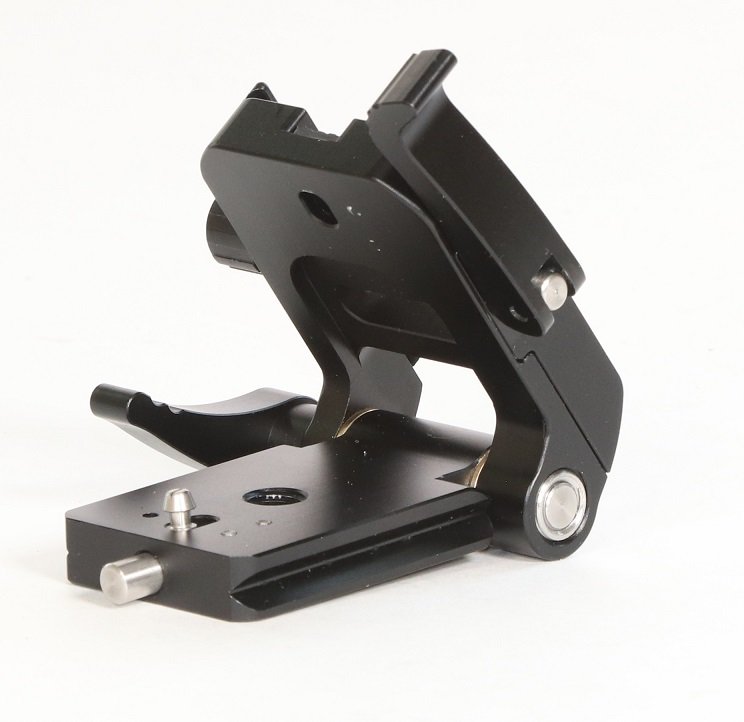

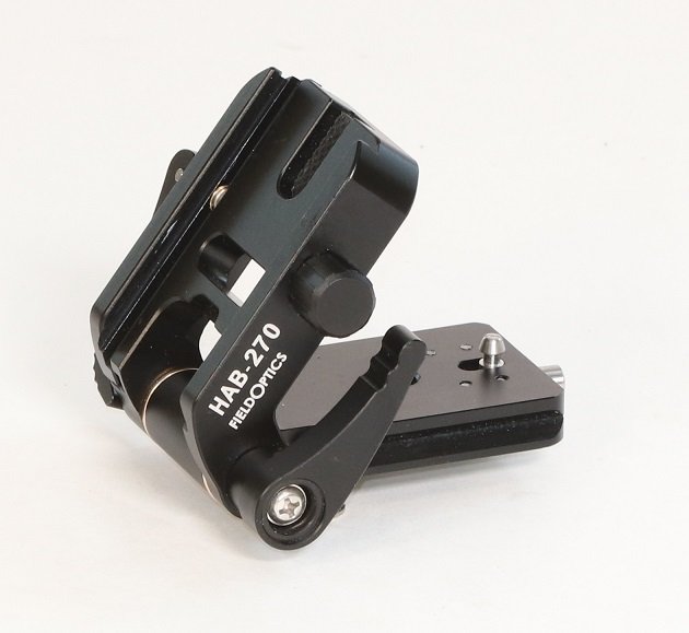

I mentioned (in my word salad) this thing FOR makes for such challenges:
This is that high angle bracket thing. Of course, you could use this with your RRS as well, but I think it shows that FOR is innovating and not just copying like so many of the Chinese manufacturers. Btw, Koshkin demonstrates this device in that video of his.

Also worth mentioning regarding made in USA, they are designed, machined and assembled here, but the carbon fiber tube is from China. This is something we hope to change in the near future. We are currently looking for domestic suppliers. Of course, when we change over the price will naturally increase.

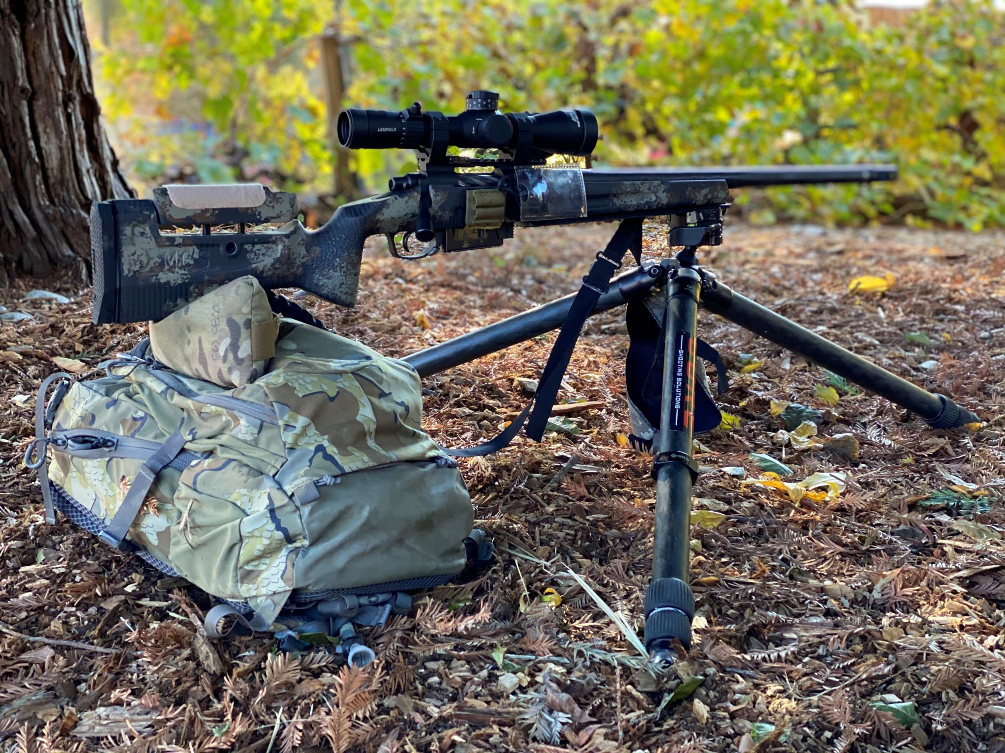

Since I was mentioned, I use the Pro32 with the ASFPL pan head and HAB to get better angle when I need it.
I chose the ASFPL with pan feature because it is really helpful when I use the tripod for photography. For shooting, I just lock it down and leave it alone.
I will freely admit that for photo/video stuff the FVH-320 video head is better, but if I do not have to drag a separate tripod with me I am a happy camper. I generally ended up buying a bunch of different ball and video heads from FOR when I was switching from Manfrotto to Arca-Swiss mounts and I have to admit that I am quite happy with what I got. Aside from the previously mentioned stuff, I also have the ULP video head, 35D ballhead and their GunPod.

Yes, you are exactly right I am a proponent of the NP (No Pan) version as it is more rigid. If I do need to pan I simply do that in the bowl top.
Full disclosure: I am a contractor for these guys so I may be a little biased. Also if you want to put an order in the future let me know as I know a dealer that will work with Hide members for a discount.
I use it often in the field. Here is a video I just posted up with the tripod in it.
I don’t use the Titan leg lock often. Really only if I am going to be in one spot for a long time or taking a lot of shots with high recoil. They do add a little extra rigidity to the platform when engaged. The leg locks were primarily designed so the stance of the tripod would not collapse under high or sustained recoil (50cal or Machine gunfire) and while they do help keep the legs closed during transport the do NOT lock them in the closed position.
Hope this helps.
Any reason you don't mount your tripod closer to the mag well for more stability? Other than shooting prone/high prone with a solid rear bag, it's defiantly less stable.

I've cooled off considerably on the FOR due to the country of origin stuff.

In fairness a lot of stuff labeled made in USA uses offshore materials
