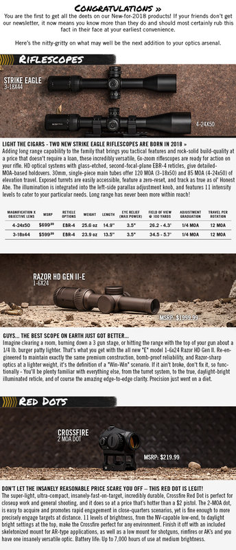

    From Vortex this morning...
    Can you spot the difference? Coming 2018.
    Only one way to see it - sign up for our newsletter - drops 12/08/17 http://www.vortexoptics.com/content/vortex_enewsletter
    Hmmm...

    Still made in Japan and is their high end LPV still. Summary of the Vortex line off of memory
    Majority AMG made in the USA
    Razor line Japan rebuilt in the US
    PST Phillipines
    Strike Eagle Chinese
    Sorry I wasn't clear, I meant the Strike Eagle line. Forgot it was China made. Overall these developments aren't really that interesting for the mid-end market. Maybe they'll have some surprises for SHOT.
    Only thing of interest to me there is bringing back the reticle spotter eyepieces, as had written Vortex off when they'd canceled them.
    Lighter 1-6 is 'good,' but it's not lighter AND 1-8 FFP, so another yawn here. Little interest in their low-end/China lineup.
    Disappointment is all that comes to mind as far as the LPV. Honestly to me it always was the really low weight optics or the Razor 1-6. Freaking hell, you can save the 4oz in the mounting options if you choose right.
    The new crossfire is interesting...
    I know lot of folks have a great fascination with the idea of a 1-8 or 1-10 but there are so many drawbacks to those types of designs that with today’s current tech, I personally prefer a 1-6.
    If I need more range I’d rather get something like a 2.5-10 or 3-12 and mount a red dot for the close stuff.
    It's all down to intended use, I guess..including more than a bit of hope that sooner or later someone will make the right reticle compromises that it works out for me.
    I do a fair amount of 3gun so need close to 1x on the low end, while soon enough I'm at 2 semis needing glass, including a.308 MDR (yeah, unicorn actually in hand..)I'd like to do some matches with for shits and grins and reliability testing. I do run a 1-6 SFP on my primary 3gun rifle from close in to 300yds or so, in 5.56.
    Meanwhile I have one range going to 800 and another to 1k for steel...not that I'm expecting to reach that with a 16" barrel, but a solid 1-8x makes sense to me, assuming I can find one with a 'just right' reticle, and was thinking it might have been Vortex to pull it off. If nothing impressive shows up at SHOT, will either spend more than I wanted to to try a Minox ZP8, look for a light-hearted ~2.5-10 + RMR or Deltapoint, or leave the relatively heavy dmr2 + RMR or dp. All in all, considering the rifle, barrel length and intent, still hoping for a solid 1-8 as I'm not shooting bench rest or high precision at distance with the rifle in question.
    I'll be the one guy here who agrees with you. Not to say I'm not somewhat underwhelmed by the announcement, I just haven't been blown away by any 1-8x scopes to the point I think they're a game changer or that I need one.
    At this point all I care about is when the discounting on the Heavier ones will start. I would prefer a heavier one 40% off on the price over a newer one 40% off in weight.
