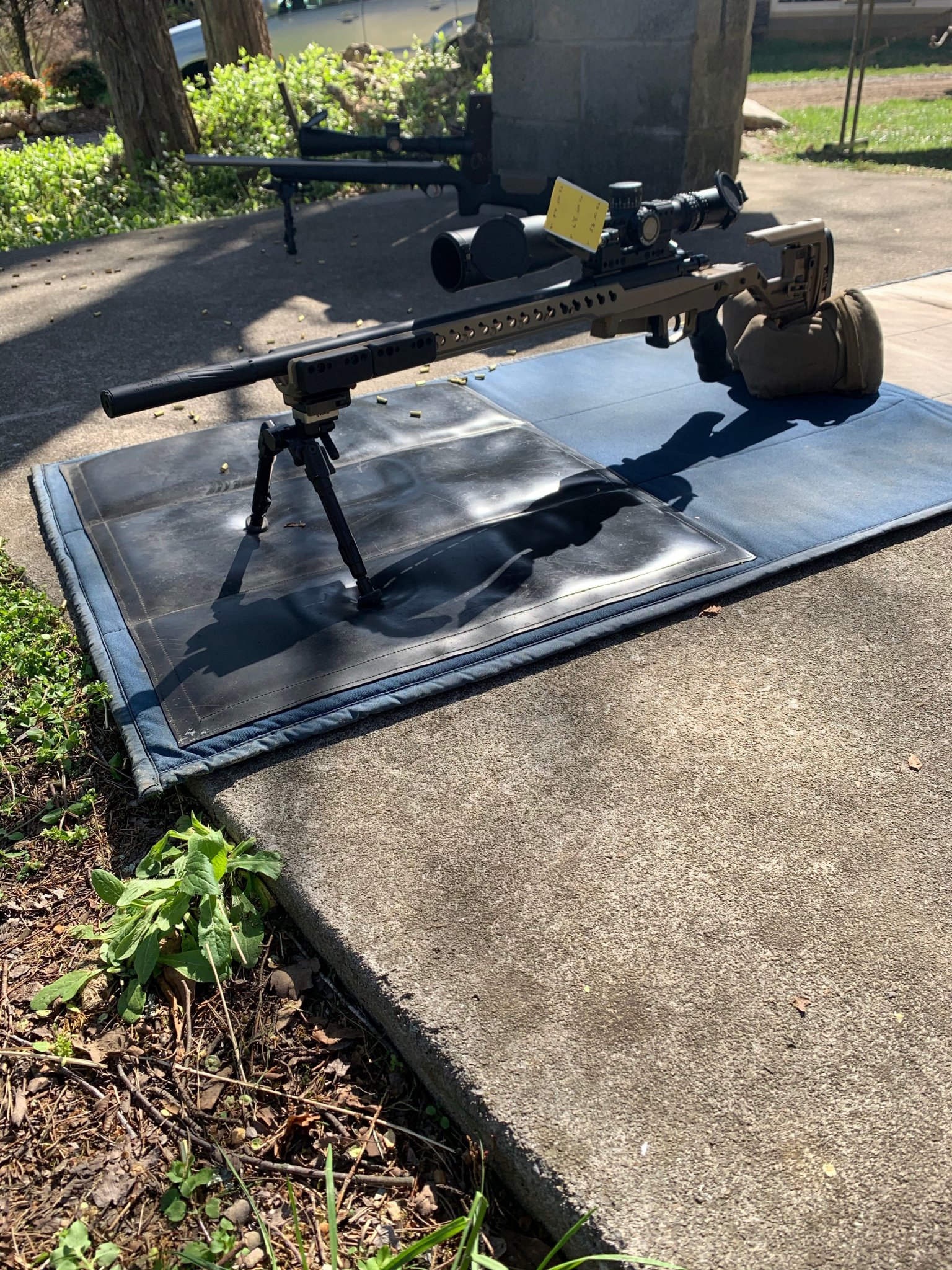

22" Kukri in a MDT chassis with four front weight sets and one rear stock weight.
I have seen people remove an inch or two from an MDT ACC chassis to get the proper amount of bbl stick out. Make certain that you check out the barrel channel width in whatever chassis you prefer. The Kukri is pretty fat at its chamber end.

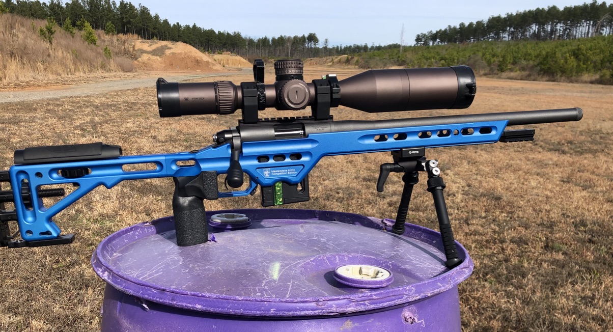

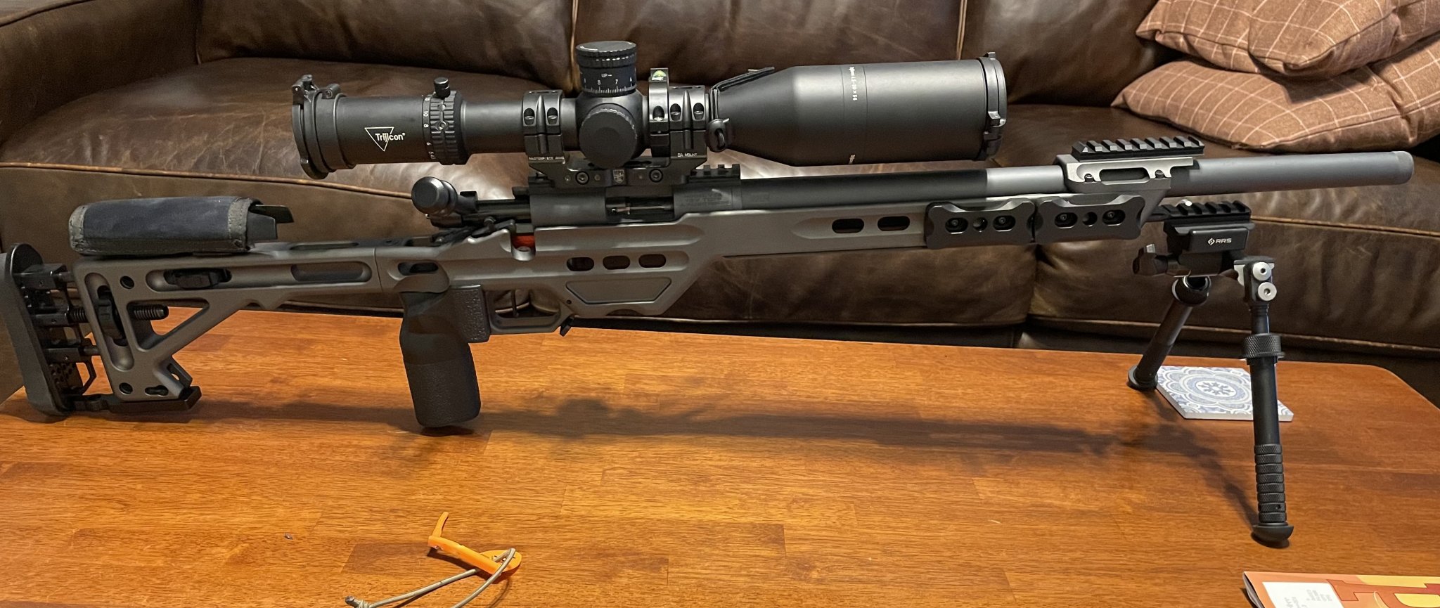

This is a "20-inch Kukri" in an MPA BA Comp chassis.
I've posted about this a number of times (explaining the quotation marks): Unless something has changed, your barrel may well end up being shorter than what you ordered. My 20-inch Kukri came in at just under 19 inches. I asked why... Per Jill:
"One of the reasons the V-22 is so accurate is some of the attention to detail we put into creating the barrel. Our lengths are "published lengths", what we shoot, with our main goal being to make sure the tight portion of the barrel occurs right at the muzzle. This happened to occur very close to 19” on your barrel blank."
She offered to replace my barrel with one of full 20" length if I wanted - nope, it's fine. But if you want all of 22 inches, make that clear when you order.

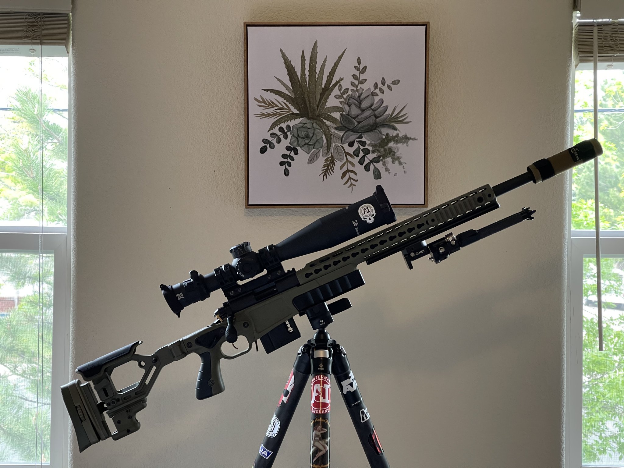

  • I have both a 20" Kukri and 20" MTU and the MTU is about a pound heavier - the Kukri has a little dip after the chamber, but the MTU is essentially straight
  • I have a 22" on order and bet it will be a little less than a pound heavier than the 20 - it should balance without any weights
  • Neither of the 20"s will balance an MPA BA chassis out of the box - I have 4 grey ops external weights on the front and it balances
  • The large bolt knob is really not that large and has three rings and is rounded at the bottom, the medium bolt knob has two rings and is flat at the bottom... I don't use either, I run Area 419 bolt knobs on all my rifles
  • I read a lot on here about mag issues with the MPA BA - I have not had a single issue feeding, extracting, loading into barricades, etc. The new MPA BAs come with an adjustable mag catch. Watch Mike's video on barreled action install on YouTube and put the mag in when installing
I highlighted a couple areas on this other picture - my black one is a 20" Kukri and grey one is an 20" MTU.

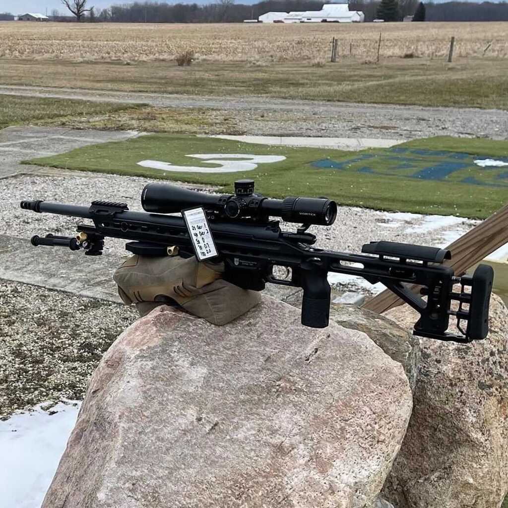

Mine is setting in the MPA BA Comp wtih both front chassis weights added for balance.
