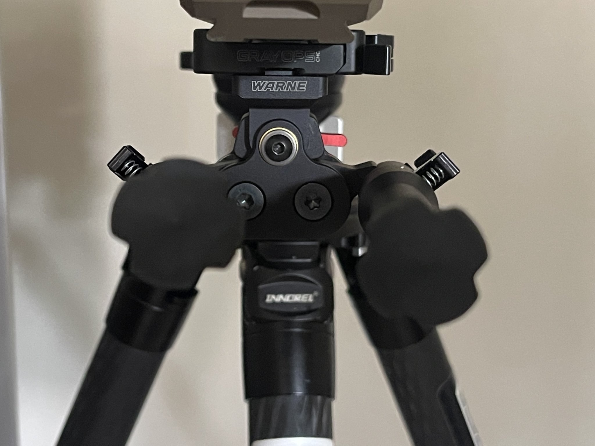

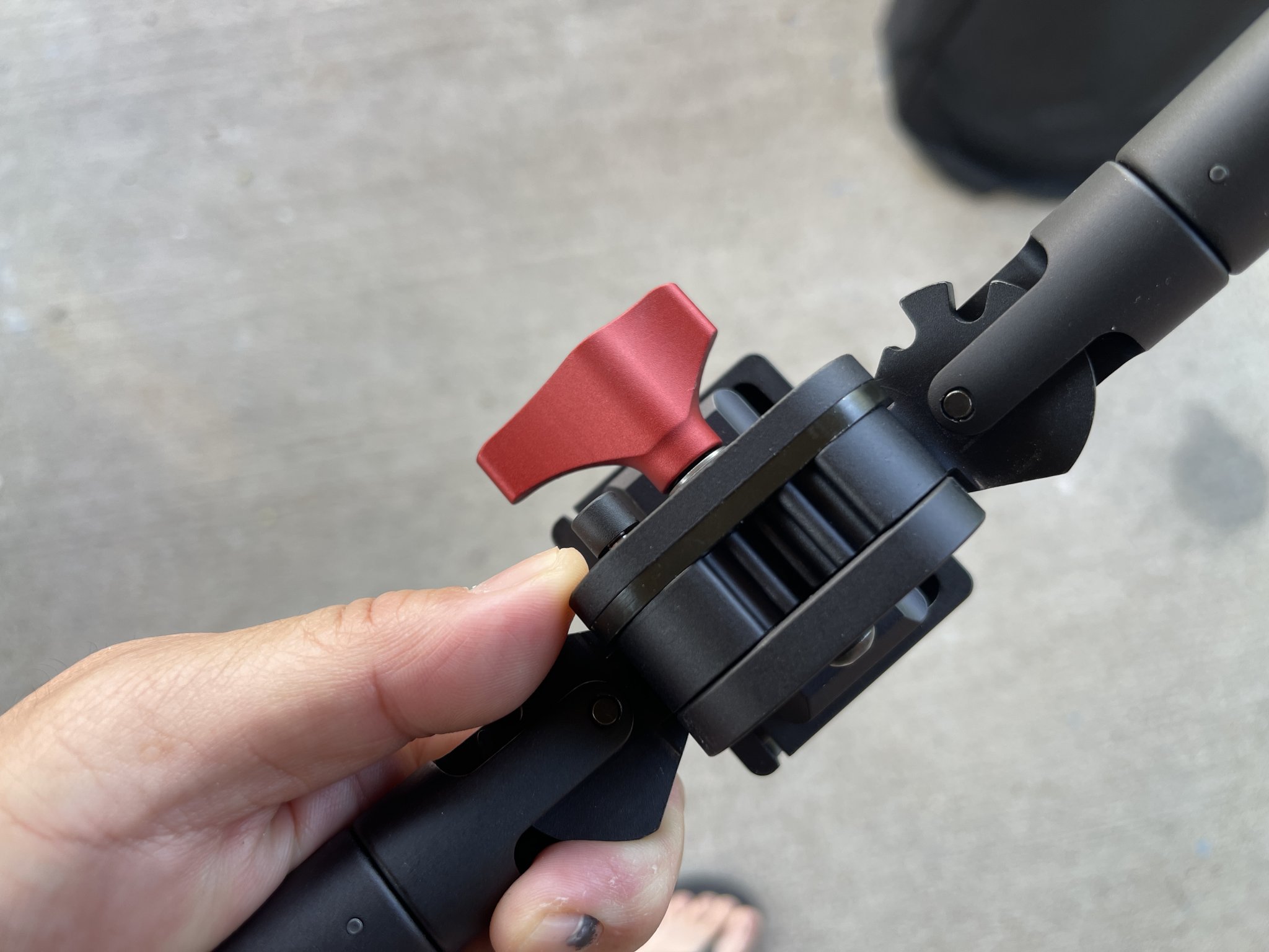

The legs are quick deploy from closed to 90 degrees. You can easily slap them down. If you flip the bipod around you have 45 and 90. There is slop/play in the bipod. The legs are geared so they splay at the same time. So far it seems “stable” while prone. Obviously I need to shoot with it. There is some give or flex to the legs when you set it down on the ground with the weight of the rifle.
The bipod tips the scale at 20.5 oz as configured. What I don’t like so far is the cant lock. Even when tightened if you cant the rifle left and right you can watch the lock knob loosen itself.
Someone on Facebook mentioned the cant issue and Warne said this:
“Sorry about the tension not locking. Please try snugging up the screw that runs through the middle of it.”

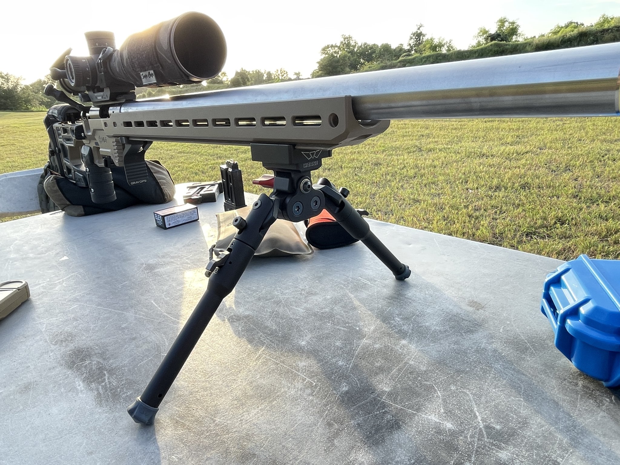

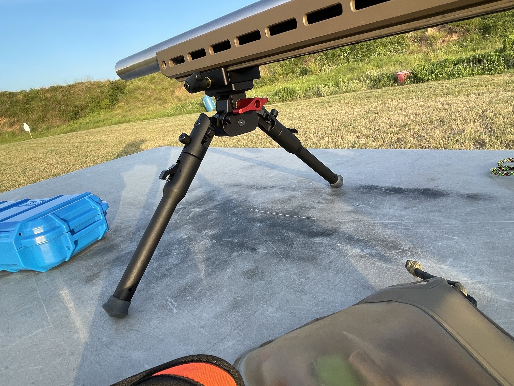

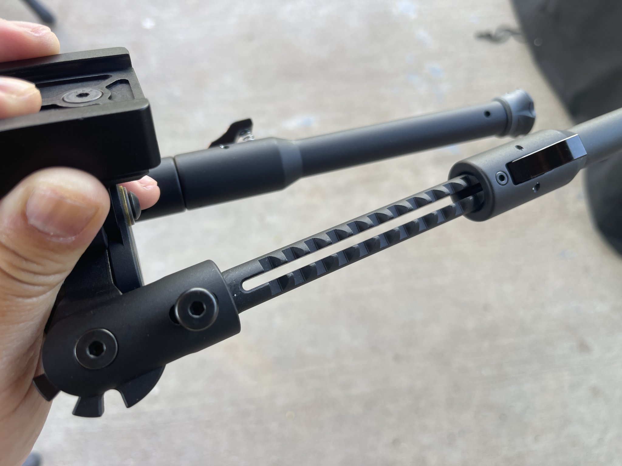

Took it out yesterday to zero my rimfire. The barrel is a 1.25” straight at 25” with 2 internal weights in the front of the ACC Elite. I didn’t feel any weird flexing that affected my groups.

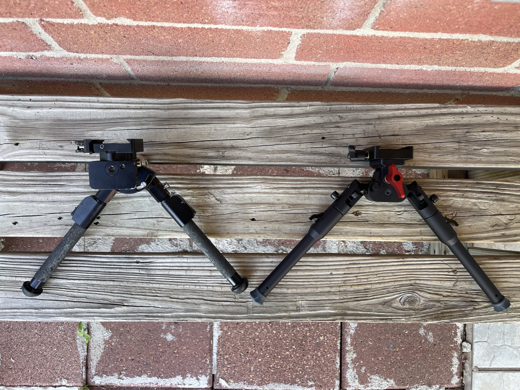

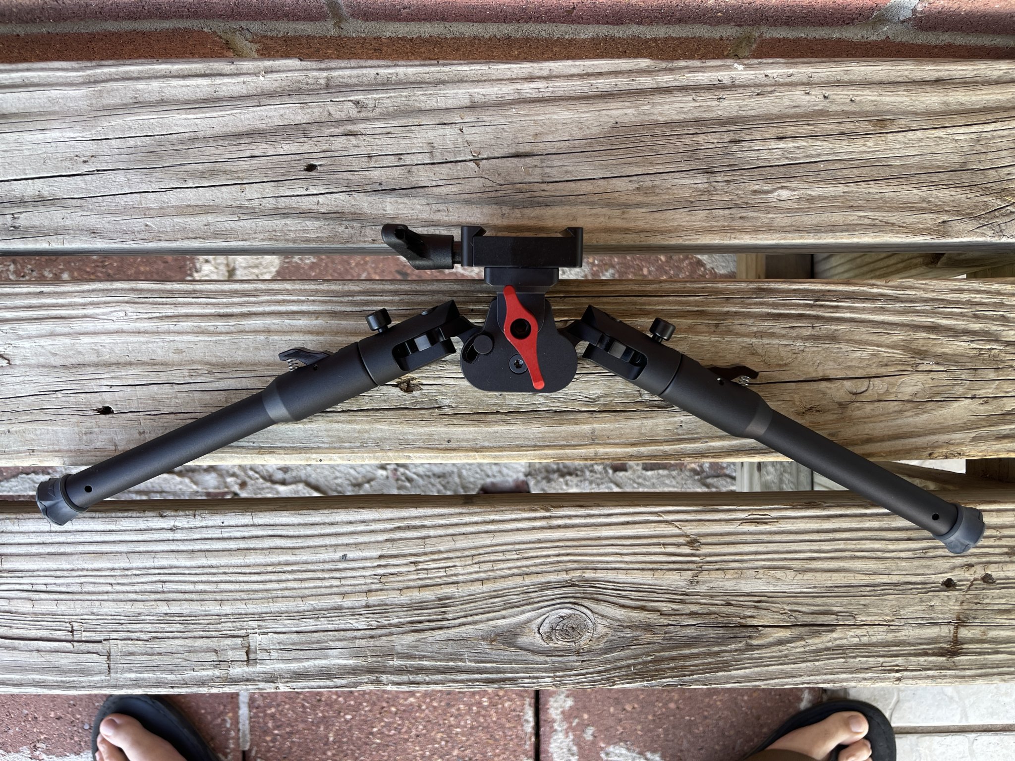

One thing I will note now that I’ve communicated with Warne is how the legs rest when they are folded. One leg sits higher up. This only applies in the “quick deploy” setting. If you turn the bipod around and fold up the legs they will lock in the notch and be even. The CS rep I dealt with spoke to the QC team and checked all the production samples they had. They were the same. When deployed and in the locking notches it’s 100% fine. If anything it’s aesthetically not pleasing. Sucks for the amount of money but they said that’s just how it is. Tightening the knob screw also took care of the loosening tension. I made micro adjustments while shooting and it did not come loose. I did swap out the Arca clamp for a Gray Ops one.

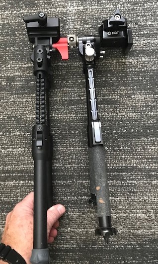

How does it compare?
There are obvious differences but functionally it didn’t feel like I was missing anything from the Ckye-Pod which is my primary match bipod. Adjustments were fast and I felt stable enough. I didn’t pay full price so that was a bonus. Warne has a 40% discount for PRS members.

The legs on your Warne uneven when folded up?
I just figured I would thow it out as not everyone is a PRS member and some that aren't might be able to go Expertvoice.
Yup a little like yours but means nothing to me.
