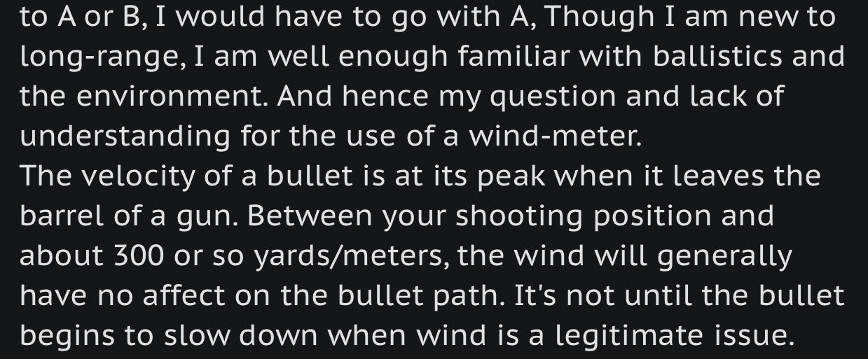

I understand what you're getting at. But if it was left up to A or B, I would have to go with A, Though I am new to long-range, I am well enough familiar with ballistics and the environment. And hence my question and lack of understanding for the use of a wind-meter.
The velocity of a bullet is at its peak when it leaves the barrel of a gun. Between your shooting position and about 300 or so yards/meters, the wind will generally have no affect on the bullet path. It's not until the bullet begins to slow down when wind is a legitimate issue. And if you have multiple directions and velocities of wind, I think it would be most important to make an educated guess on what you can deduce down-range where the winds have most influence. With changing directions of wind, within the path between you and the target, knowing that at my firing position, I have definite information telling me that there is a 16mph wind from 90°, is not relevant 600 yards and beyond where my bullet is [relatively] rapidly loosing momentum. Hence my question about the wind-meters and their popularity...seriously, I am wanting to know.

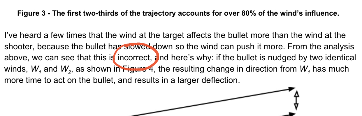

You got the “you’re wrong dumbass” answer after you decided to tell us you knew enough about ballistics to know that wind doesn’t matter out to 300yds.
Reactions: Steel head

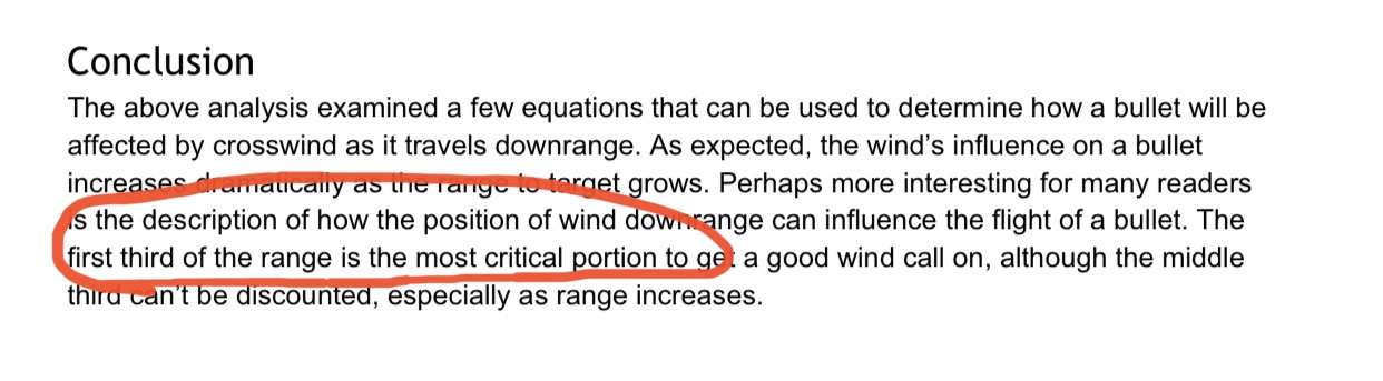

And apparently still haven’t read up enough to realize the first 1/3rd is the most important and the wind at the target is the least.
With wind in the middle being increasingly important the further the distance, but unless at very extended ranges, not as important as getting the first 1/3 wind.

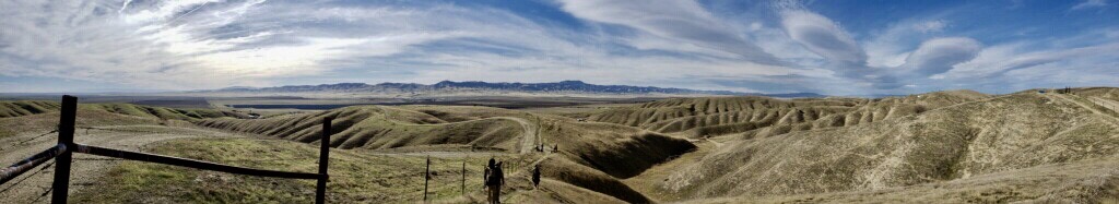

Above is our home range. It rises out of the valley below and crates all kinds of wind eddies and directional switches. Afternoon winds well above 20+ are not uncommon, nor are wind flags flying in opposing directions. Sometimes we are shooting in a wind shadow, others at the top of the ridge where a venturi effect is making the wind speed increase. Point being, I understand your concern about the FFP's wind value being different than the flight path. With that, is it all possible to take it for face value that I understand your premise?
