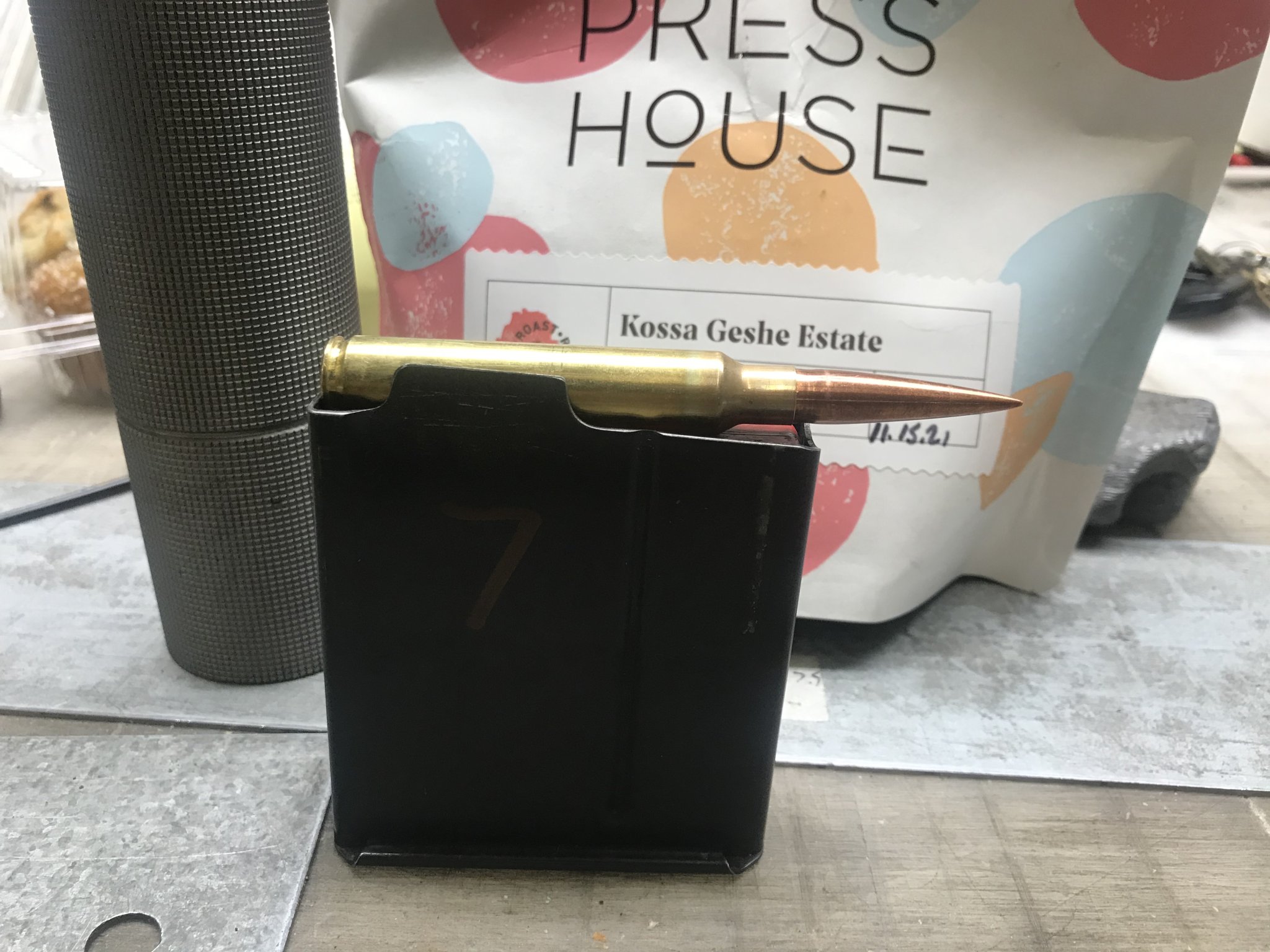

    Looking for a new cal to play with. We'll I guess cartridge to play with.
    Shooting is mostly 100 yards to 1760 80% of time and out to 2000 yards on occasion. Prolly do more out to 2000 yard shooting now. I have plans to visit rebel ridge 1 or 2 times a year to shoot to 2600 yards.
    My powder I've stocked up on is imr 8133 and it would have to use that because shortages ect. No bigger than 30 cal and .535 bolt face. My suppressor is only 30 cal and bolt is that and for my nucleus don't go any bigger. I currently do a lot of shooting with 7mm-300 win mag which is great. But I do want to get away from the belt for honestly no reason in just getting away from it for this barrel.
    My thoughts are kind of -
    30 nosler
    300 rum
    7mm-300 wsm-7mm-270 wsm
    7lrm
    28 sherman
    7mm mega ( last 2 are questionable)
    I want to be able to buy brass so 300 prc is out.
    I'm not afraid of wildcats. Mag fed would be nice but not a must have.
    30 cal I'd shoot 230 a-tips or 250 a-tips
    7mm 183 smk 197 smk 190 berger
    What would you guys want to try or run?

    I'm personally thinking of selling my .300NM as a turnkey ELR setup, and getting a 7mm SS barrel for my SA Mausingfield rifle.
    It's an amazing rifle, but just doesn't make sense to hold onto it since I have no where around me to really stretch it out.
    I've always wanted to try a 7mm cartridge, and consolidating down to fewer rifles makes sense for me right now. I think a 7mm SS would be fun.

    The 7mm are hard to beat for sure. High bc bullets and lighter recoil but you do lose barrel life depending on case.

    You’ll love the 7mm, especially the short mags!
    So much performance with such low recoil and cost.
    If I just had my one spot that goes out to 2300 I’d never even consider a 300 or 338.
