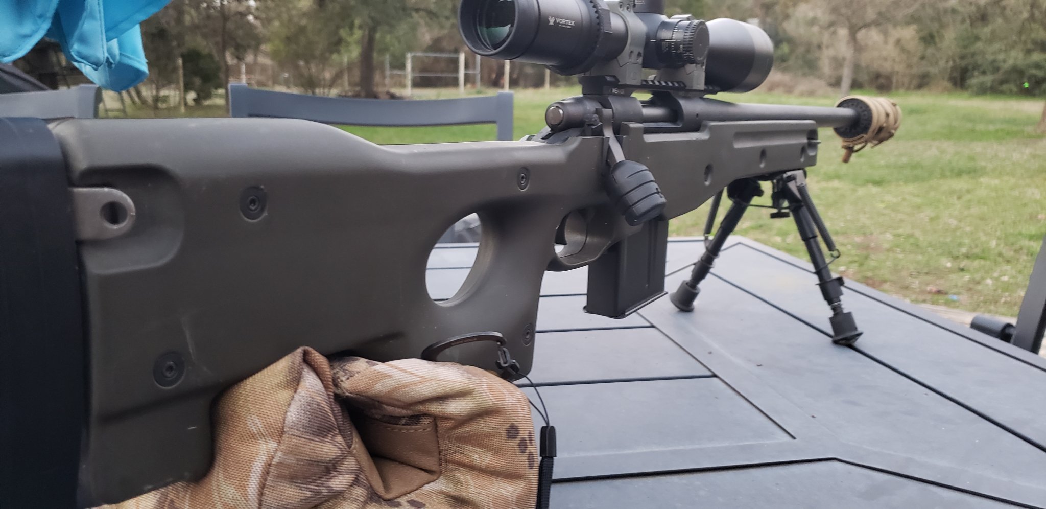

Brand spankin new to the forum. Not quite so much in regards to shooting, but definitely to long range/bolt.
Picked up an sps varmint in 308 with a Vortex Viper Hst 6-24 x 50 already on it for $300. SUPER STEAL! First things first, out with the "tupperware stock" and on the market for new, even new to me. Need detachable mag upgrade. New rings and rail (currently cheapo stuff). I'm not a complete newb, but asking for some help. I prefer traditional stocks, but not opposed to a chassis system. I like the idea of a folder because of that 26" barrel, but never handeked one and not set on it. Had a B&C Medalist milled out for Bagder bottom metal, Badger rings and rails, and a Leupold Mk4 on a previous 700 AAC build years ago and had no complaints. Had some thoughts of cutting the barrel down/threading it and making a sudo-M40 clone, but don't think I can swing a grand for a stock that I have to wait forever for, and will require additional custom work and parts to complete. Not that I don't understand the difference in a McMillan and a B&C, Im just not that advanced of a shooter or as well funded (Read single father).
I want to be able to dail out to 1000 yards. This scope offers a MAX of 65 MOA of elevation travel. I believe this would get me there (isn't it like 40 MOA from 100?). Would there be an additional advantage to an MOA base?
Listen, I believe in buy once cry once, but I have minimal extra spending cash to burn and want to get behind this rifle in the the next 2-3 months so budget is the mindset but a true sacrificial compromise is not what I want to do. Anyone have any stocks or anything laying around they could help arm a brother with? Unless you can suggest an excellent budget replacement to biting the bullet for Badger enhanced M5 bottom metal, thats where I'll head. Same goes for rings and rail, unless someone has a bomb proof budget suggestion, they will be Badgers. Extras cluttering your workspace, I'll gladly take them off your hands. Rah.
I think a KRG Bravo would fit the bill of "prefer a traditional stock but consider a chassis"
Second this. Modularity of the chassis, feel of a stock. $350 shipped, AI mag ready. If you want to go down the chassis road the new MDT Oryx at $400 looks pretty sweet, I've been considering one for a rifle of mine.
As far as MOA base, zero your rifle first-you have rings and a base on it already, right? See how much elevation you have to play with from a 100 yard zero, run your load info through a ballistic app and see if you have enough elevation in the turret to get there. If you do, maybe stick with what you have for now. If you don't, grab a 20 MOA base, EGW makes a decent product at a good price.
The Greyboe Renegade is also an excellent choice if you prefer a traditional stock with an A-5 pattern.
I would however recommend bedding it, that wouldn't be necessary with the Bravo but I prefer the feel of a fiberglass/composite stock over plastic.
Just comes down to personal preference as both are good options.
