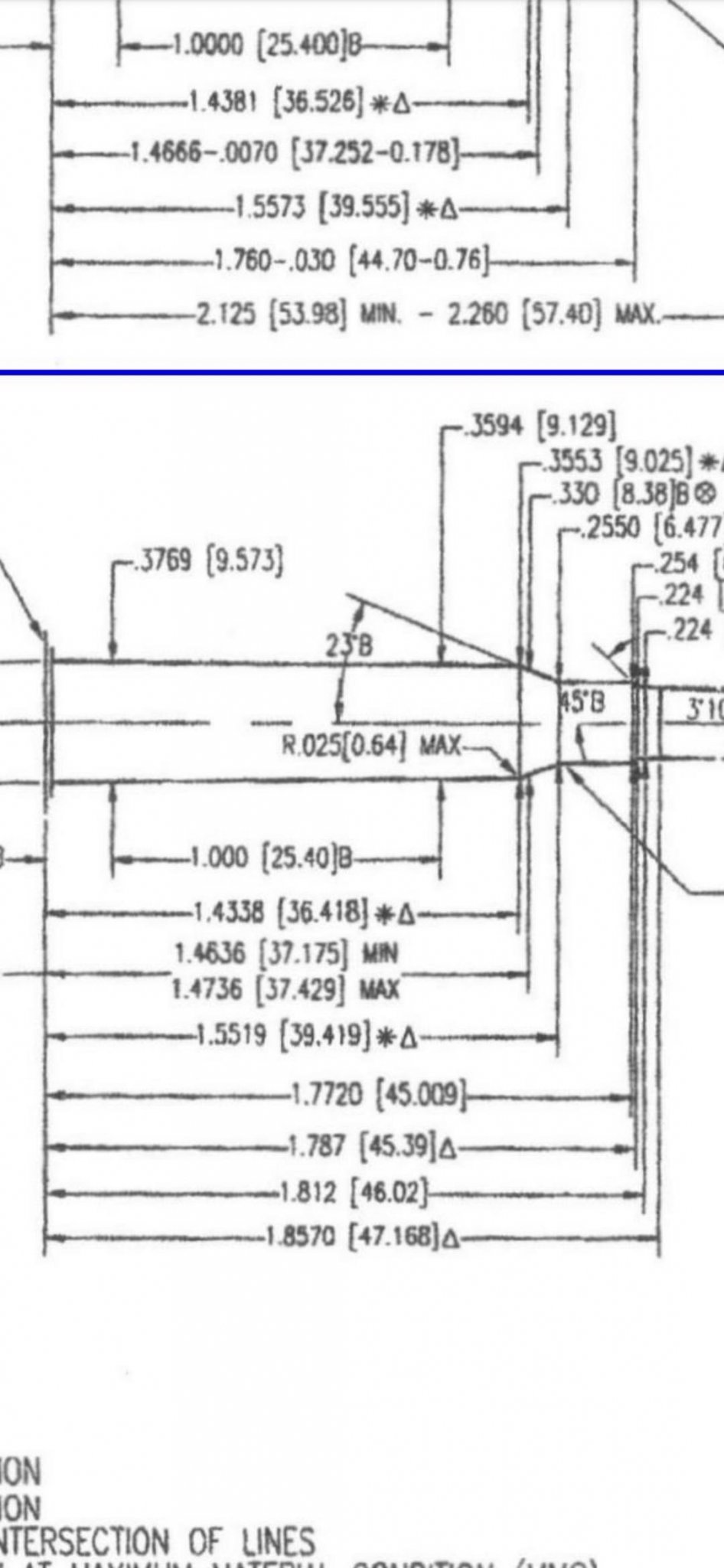

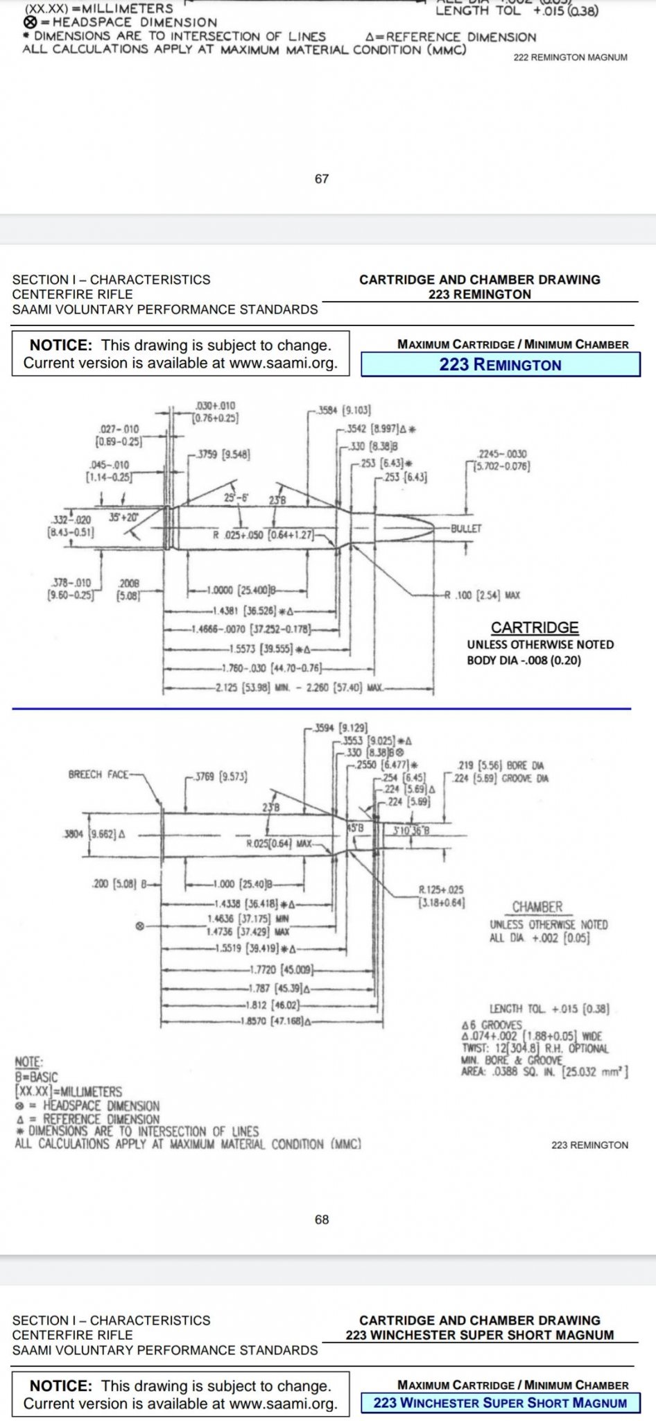

Official saami spec chamber drawings.
You have room, and being an after market barrel which was smith'd on, id expect it to be real close, if not identical to these standards.
