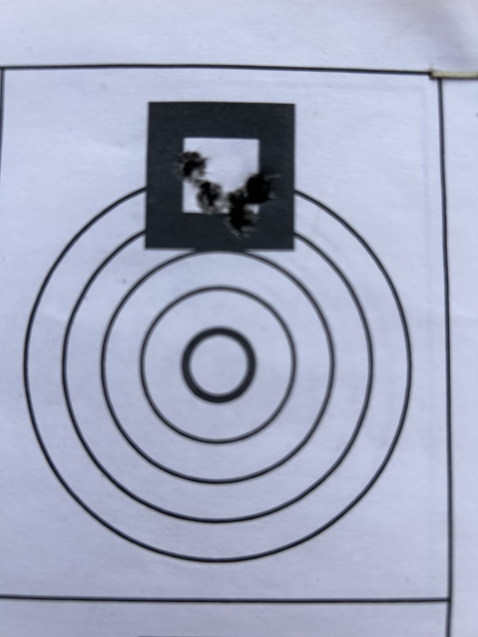

So I wanted to wait until I tested the 80 smk thoroughly before I posted more results… I have a JP 16” upper with the wydle chamber 8 twist…
This is the 100 yard 5 shot group that got my attention…
The load is 23.6 H4895 with the 80 smk seated to 2.250”
It chronographed with my magneto speed suppressed at 2620 average with and SD of 13 with Lake City brass and federal 205m primers…

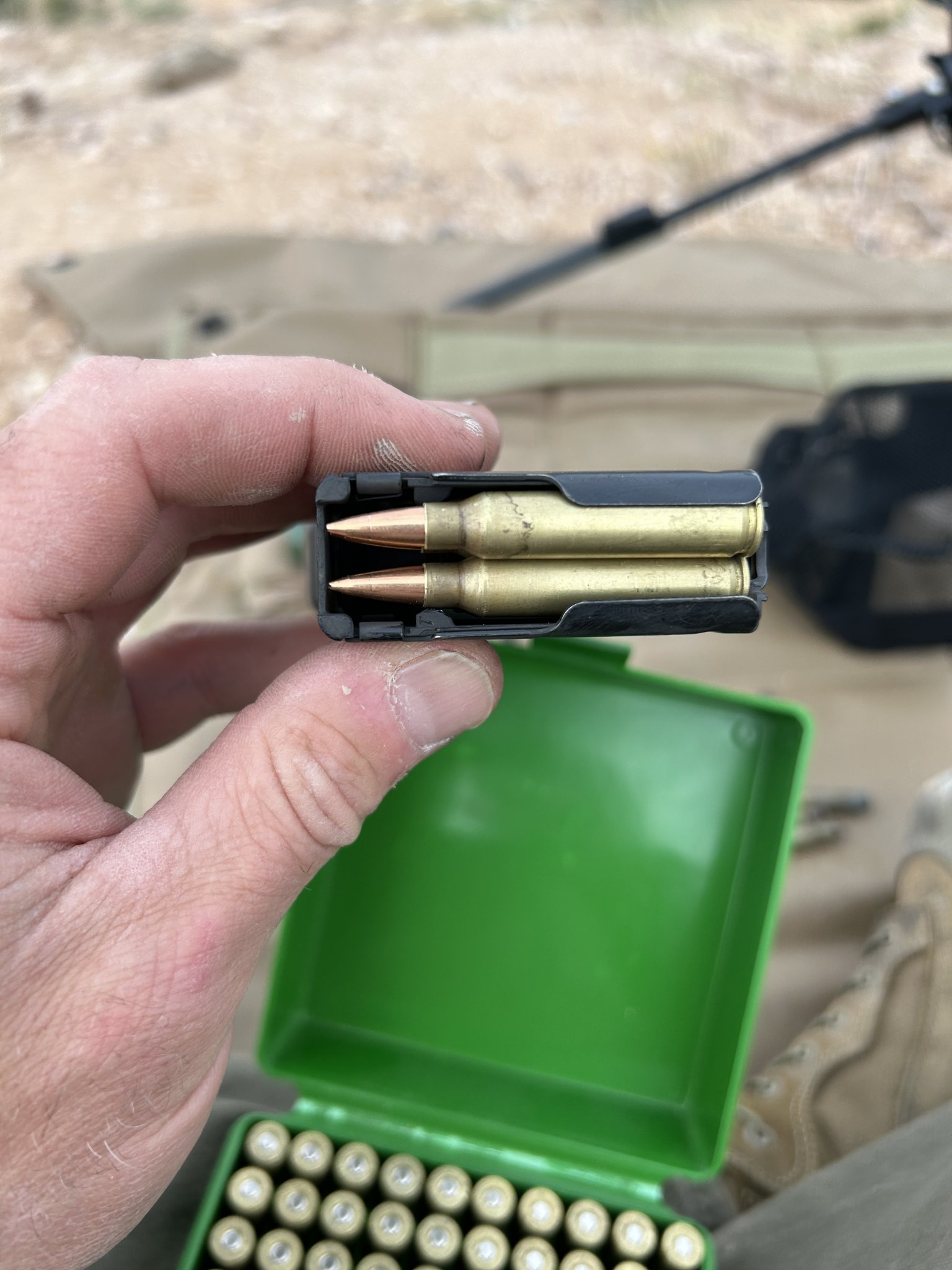

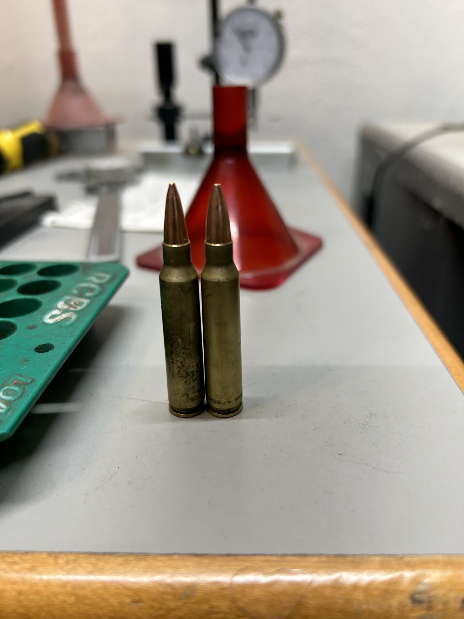

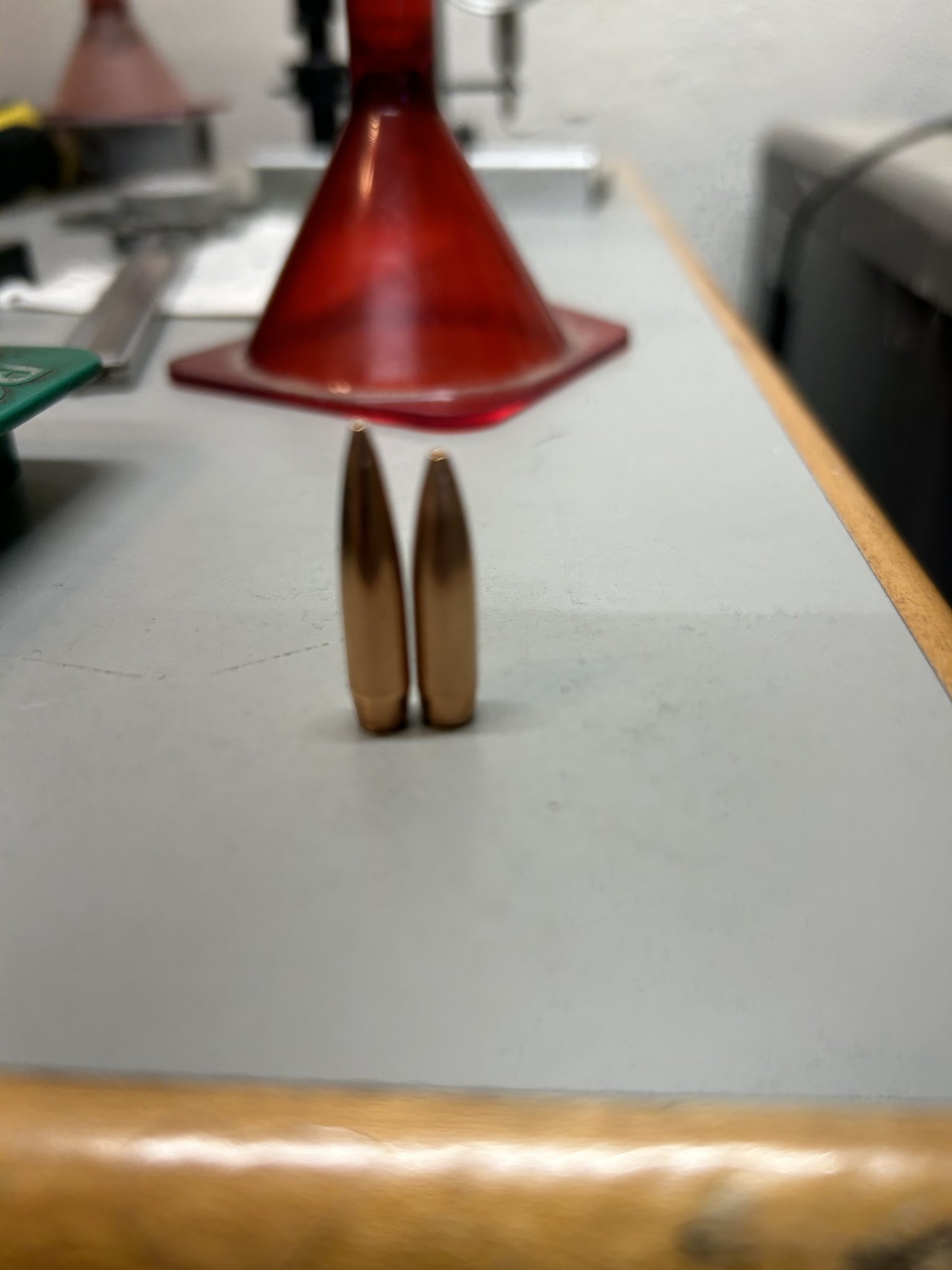

Please post pictures of the loaded rounds.

The 80 smk is loaded .080 deeper in the case then my 77 load…
I understand what you are trying to say…
I worked my way up… This is load in these cases works safely for me…
The jam fit for the 77 smk in my chamber is 2.515” I load it to mag length at 2.230… Very consistent load… the jump the bullet is doing is .285” to the rifling
The 80 smk oal jam fit in my chamber is 2.525” and loaded to 2.250”
The jump to engage rifling is .275 “
Less than the 77s

But to place third overall score in a match with mostly 6.5 class setups…
I shot as a team with a gentlemen running a nicely setup 6.5 PRC … He beat me by a point to take second overall…
We won as a team which was awesome….
I’m sure if the winds had been nasty it would have been a whole different outcome but I would have done my best with the kestrel and making good wind calls… A 22 pill is not as forgiving as a 6.5…

The bullet catches the ogive 918v…
So there is the whole shank of the bullet being held by the neck…
I lightly crimp for the AR… if I used this in a bolt gun I wouldn’t crimp…
Wrong. You don’t know what you’re talking about.
The ogjive is below the case mouth at mag length with the 80smk in the 223. Everyone knows this. It might not look it to you, but it is.
Its not just below, its way below...the ones I loaded were, but the 80SMKs i have were made about 15 years ago. Has the bullet been changed in 15 years?
This is a made up account, for someone to get their jellies.
The 80SMK ogive is deep in the mouth of a case at mag length.

80 smk on the left loaded… 77 smk loaded on the right…

Magazine loaded 80s came and left a long time ago. Not sure why some here fail to believe it's possible.
