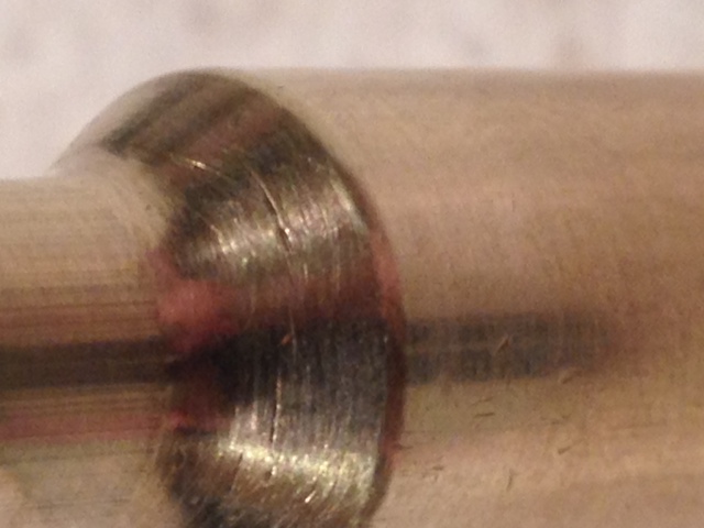

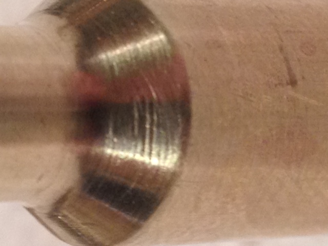

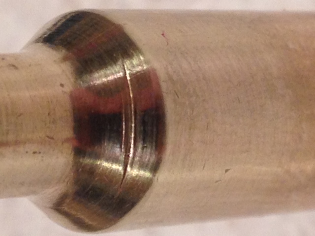

So after reading a bunch about annealing brass, I jumped in. I used a deep socket on my cordless drill and Tempilaq 750. I painted the inside of the case necks and applied the torch to the neck/shoulder while slowly turning until the Tempilaq turned dark - usually 6-7 seconds. I then dumped them onto a damp towel. Brass seemed to take on the proper patina. Didn't seem to have any problems, so proceeded to do the next 80 or so pieces painting all of the case necks as I didn't want to take any chances on my expensive brass. Where the problem seemed to creep up is when I resized the brass. The first piece had an obvious split in the shoulder (photo 1) and the next few had what I would describe as wrinkles or the beginning of a split (photos 2 and 3). The next 15 or so pieces seemed to be fine. I haven't resized the rest. My question is did I over-anneal my brass or is this just coincidence. This brass only had about 3-4 loadings on it. Is it safe to shoot the rest of the brass that looks okay? I'm afraid I may have ruined all of it. Any thoughts appreciated.

Those are mechanical marks. You can clearly see where the brass has been 'dinged' and the areas around the 'ding' have bulged if it were a material problem it wouldn't look anything like that, it would be ragged and wouldn't have bulges/perfect arch/etc.. In other words this has nothing to do with your annealing and everything to do with something in the die or your handling of the brass, etc..
Well, I took the die apart and cleaned it will a little Kroil and a Q-tip. There was a good bunch of black material that I'm assuming is the dry lube that I use. I resized a few more with no issue so I'm hoping that has cured the problem. Thanks everyone for your comments.
