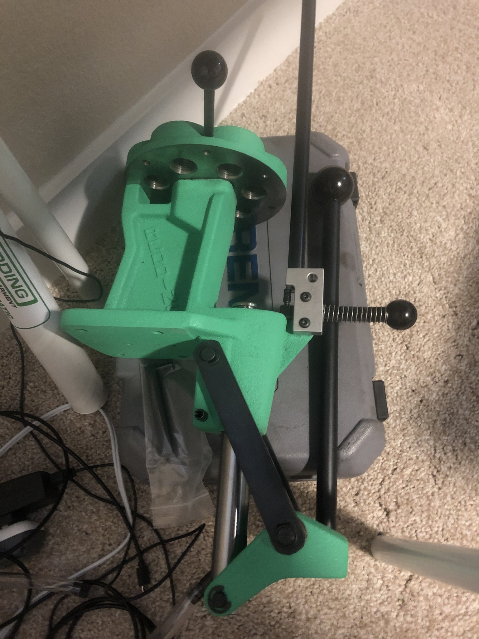

If you really feel a Dillon isn't what you want, I would either get the CO-AX or a turret press. I started out with a Lyman Turret years ago and its far superior to a single stage, as you can just leave your dies in place. The T7 recommended above seems to be the winner.
AS far as a kit... I'm not a fan. I bought the Lyman Turret kit when I first started and it worked for me, but I was never a member of a forum like this one back then. This forum and others like it are HUGE asset to get the right equipment first. So i'm in the boat for piecing together your kit.
Awwww yeah.
